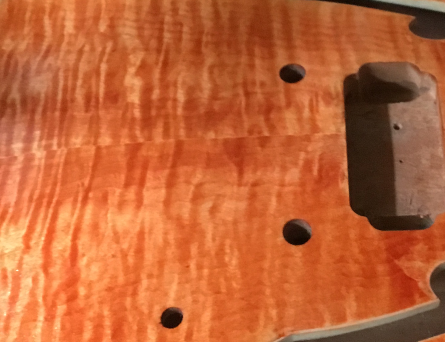

    I have started Staining, and I am now on the final coat, it has turned not as I expected, but still quite nice,Click image for larger version.
ID:	23840Click image for larger version.
    I checked the Scale Legth and it is 25 inches, which I think is good, I am going to put the neck in next

    That is a nice looking pattern on the body veneer....
