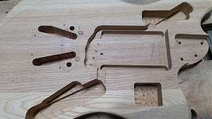

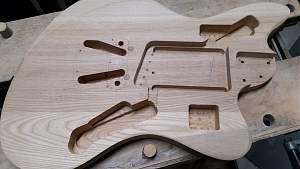

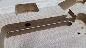

    More pics of the cavities taking shape
ID:	26770Click image for larger version.

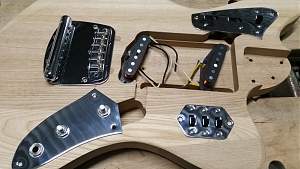

    Needed to add a relief for the pup base plate
    Drilled a 10mm hole for the wiring, could have just cut a channel for it but this was quicker.
    And checking everything fits
    cont.

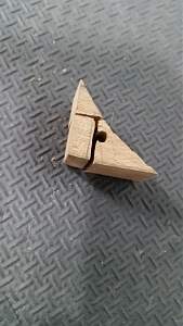

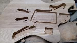

    Did end up moving the lower control plate closer to the bridge which meant there would be one screw with nothing to screw into. Knew there was a reason I changed the profile under the neck pocket, glued the offcut in so the screw had something to grab onto.
ID:	26775Click image for larger version.

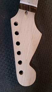

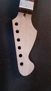

    The pre-shaped headstock wasn't working for me so had a bit of a mess around with that as well.
ID:	26777Click image for larger version.
    And that's where I'm at, still need to round over the body edges and get it ready for paint.
    Grant
