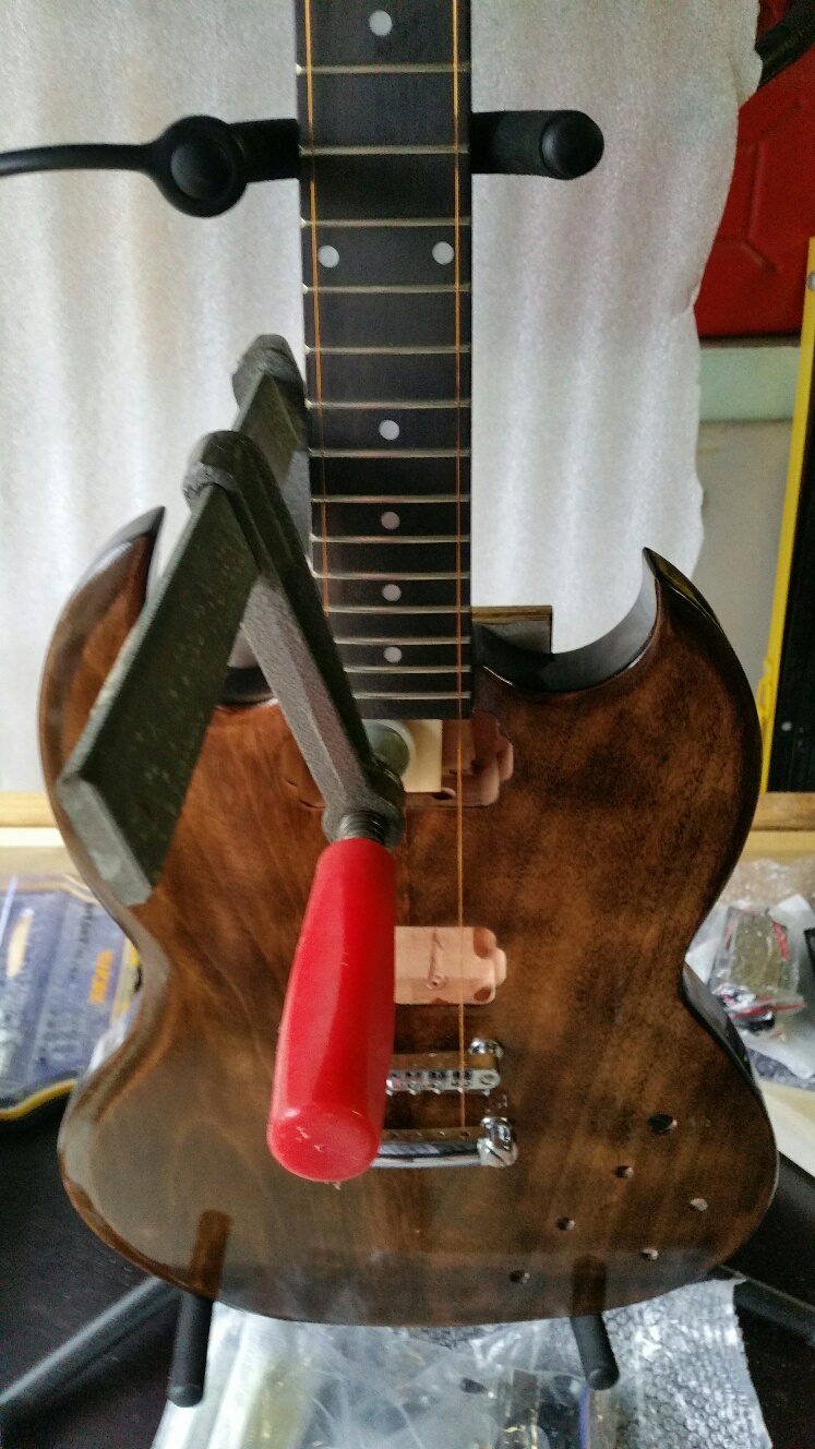

    Some clamped set-neck photos you can use.
ID:	23189   Click image for larger version.
ID:	23190   Click image for larger version.
ID:	23191   Click image for larger version.
ID:	23192   Click image for larger version.
  2. #22
    Mentor Kick's Avatar
    Feb 2017
    Amsterdam, The Netherlands
    823
    I used a block of wood with spaces to prevent damage to the frets:
  3. #23
    Great photos Marcel and Kick, I will be using a couple of these. Thanks
    Adam

    Member DaveC64's Avatar
    Aug 2017
    Melbourne-Ballarat Australia
    88
    Quote Originally Posted by adam View Post
    I used 2 clamps on my sg placed side by side on the tongue.
    They were not as big as Marcel's clamp.

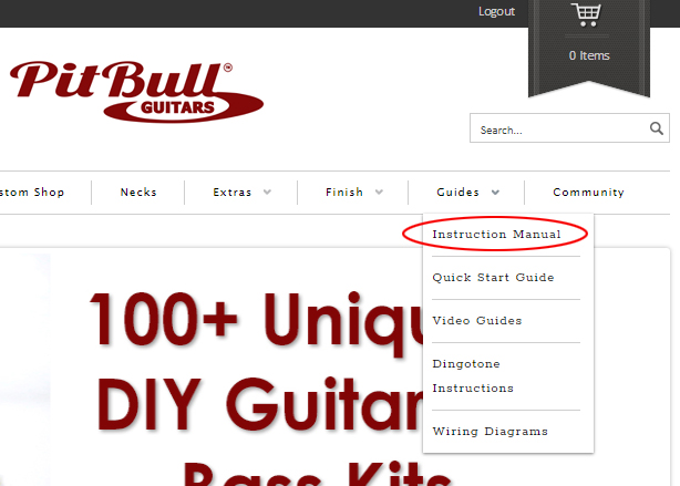

    The Instruction Manual is now on the site.
    As it says on the cover, this will be a live document and continually updated as we add processes and update processes with new and better techniques.
    Thanks again to everyone who contributed to this project.
    Adam
