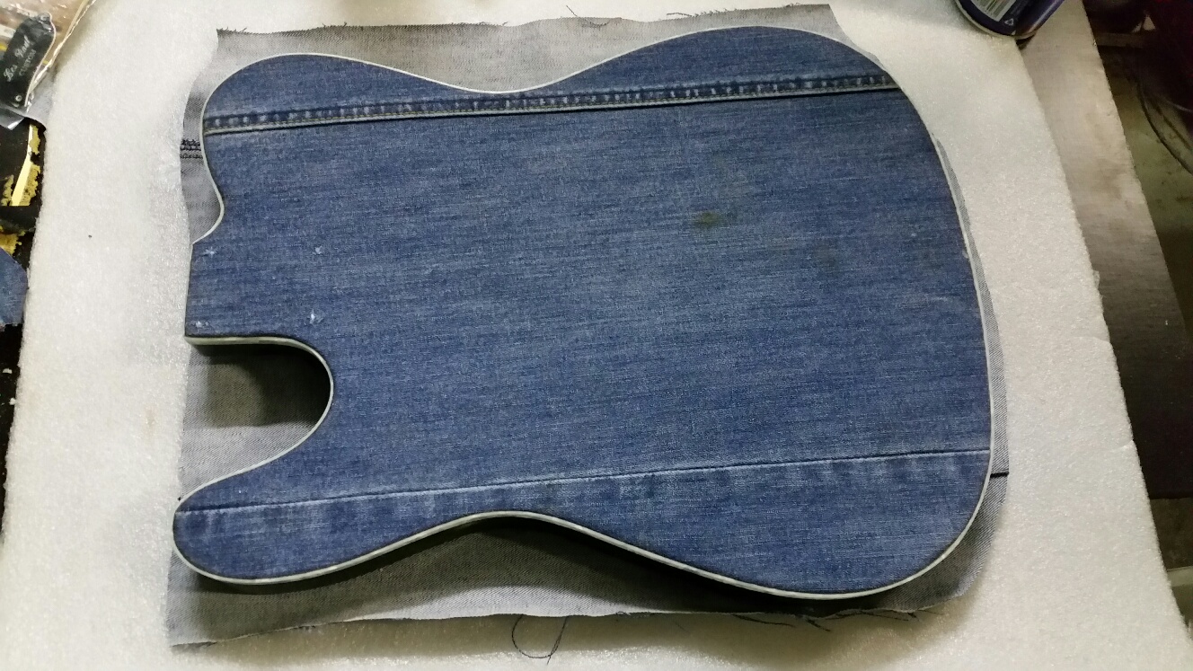

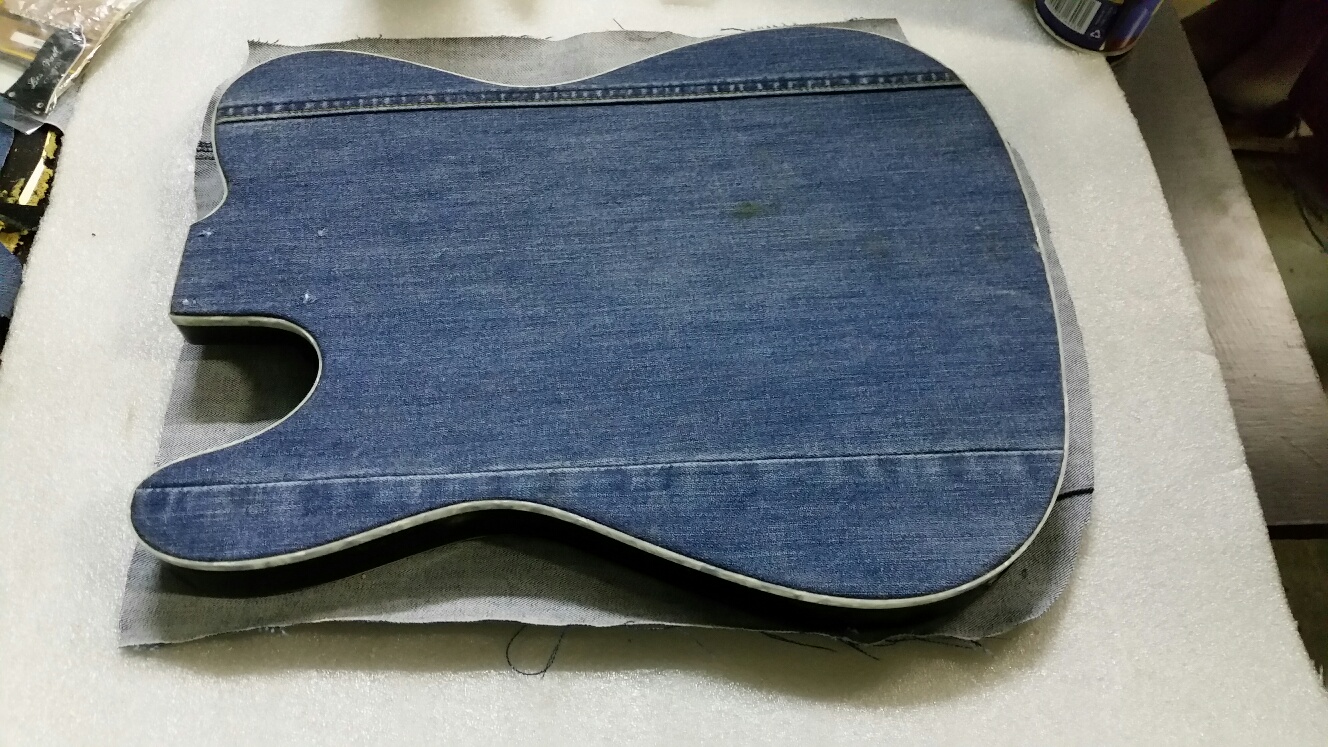

    Nowhere near perfect, but it does look the part...
    Rear binding done and dried. Front denim glued and drying...

    You know what? That actually looks really good. I will admit I'm still disappointed you didn't have a pocket included, but great work regardless.

    Thanks guys...
    The hardest part is finding the right piece of denim... in this case the legs from a pair of jeans sized for a 10yo child. Adult sized denim has the stitching separated by too much material, and pockets aside I think the stitching is near half of what character denim has....
