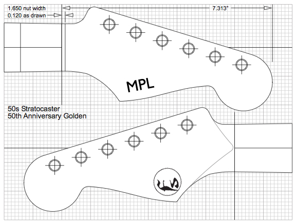

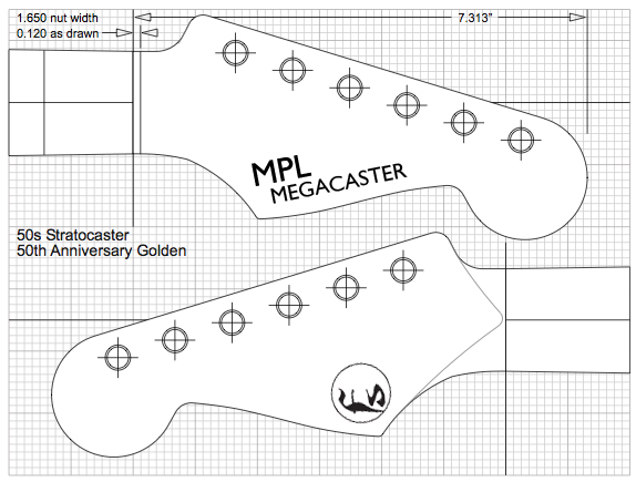

    So I was hoping to screenprint some decals for the headstock, but ran out of both decal paper and money. Instead I'm going to get a friend to cut them on his vinyl cutter during the week.
    Before I do I'd like to know what you guys think about both the text placement/size and my revised logo. Wasn't sure about the Megacaster as a name, so also mocked up a version without it (though the name has grown on me since I started this build, so I dunno)
    I picked the font because it is a favourite of the guy I'm giving this to (he's a type-setter so these things are important to him), so the font probably has to stay but the scale and placement are totally open for suggestion.

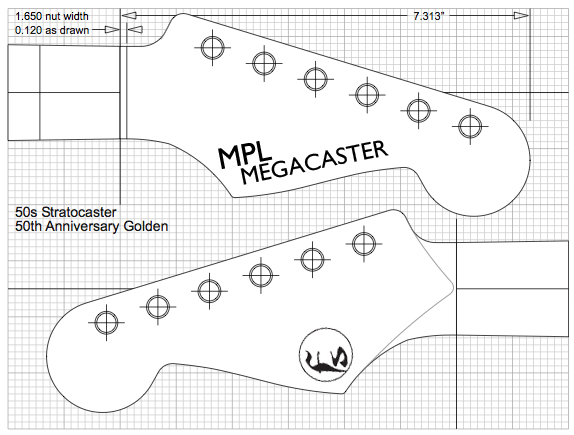

    Something more like one of these you reckon, Simon?

    One on the right looks more balanced to me. I don't like headstock decals that 'take over' the whole of the headstock. But it's all very personal.
    Also, consider where the string trees will go (if you aren't going staggered height tuner posts). Top B/E tree is normally in line with the A-string tuner, which might leave part of the 'L' obscured. In that case, bringing the 'MPL' down with 'Megacaster' after it (in a traditional Fender fashion) would also work for me.
  11. #30
    God, how did I forget the string trees?! I've even ordered them and I still managed to forget. I'll measure it up when I get home but I'll probably end up doing the text in a single line just to be safe
