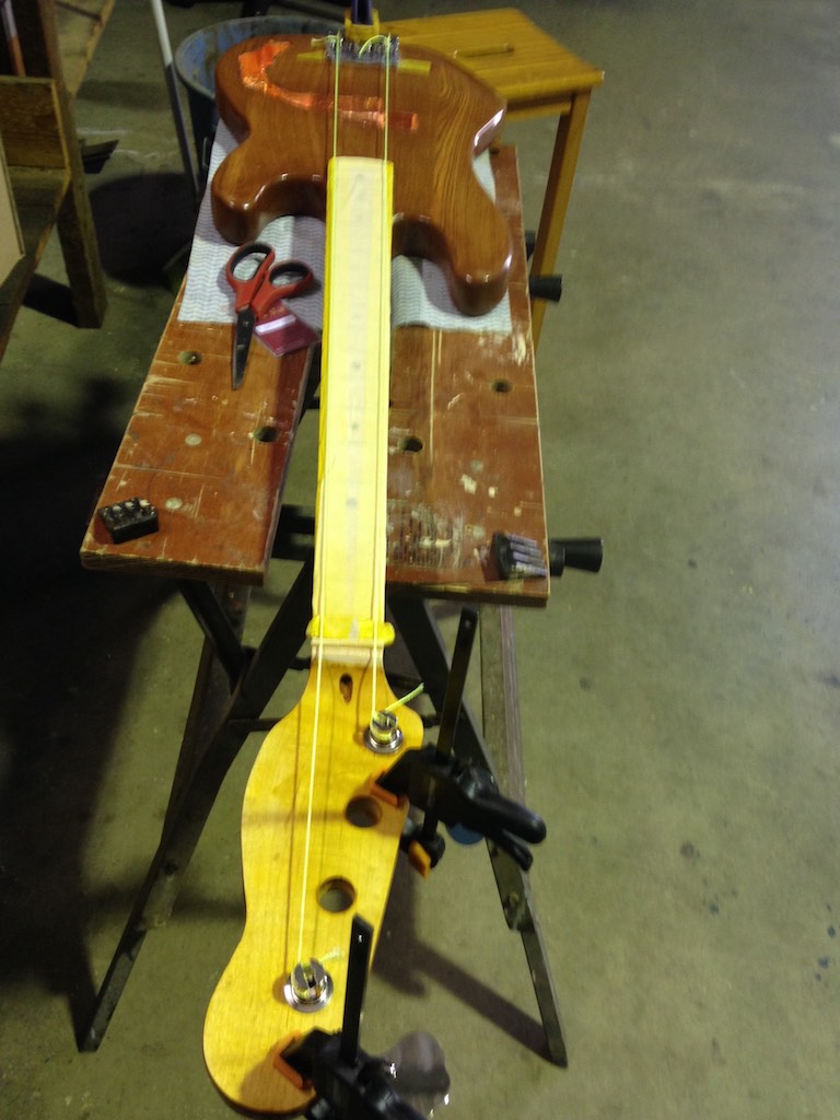

    Fit-up stage. The point of no return?
    Time for a status update. Neck and bridge placement.
    The neck is now properly located and the neck screws inserted - enough to hold it all together. The neck pocket needed a shim pack (0.75 m/m brass shim stock). I chose to place this on the E string side because that is by far the largest bearing surface. (It's logical to me anyway).
    The E and G string Gotoh tuners are clamped in, I'm still lacquering the headstock so I didn't want to fit the tuners yet.
    The Dingobass bone nut is pushed in - the height adjustment comes later.
    Builder's string in place so that I can set the bridge location with a high degree of accuracy. I had managed to obtain a Fender drawing of the 1950s & '60s P Bass body, showing all centre lines of the body itself and the various items of hardware, that was a big help. The bridge is a Fender High mass, I know that 'Leo got it right' but the engineer in me doesn't cope well with a bit of bent metal on what is otherwise a precise piece of gear.
