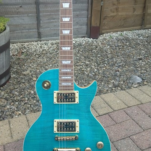

    Done almost, neck is dead straight now, no adjustment needed, the strings under tension sorted it, however it will definitely need the frets doing..a first for me... 2 of the pot threads stick through the body too far so the knobs don't sit down on them as far as I would like, noticed when I was putting it together in the cavity 2 were countersunk 2 were not.... the neck tone pot hasn't much change from 0 -10 so might need look into that also

    Looks great. Just fit some washers on the pot shafts before re-fiitting the pots. I know it's 3/8" for full-size CTS pots, though the kit pots might be a very slightly smaller metric size.

    Looking very nice!
  9. #29
    Nice shade of blue.

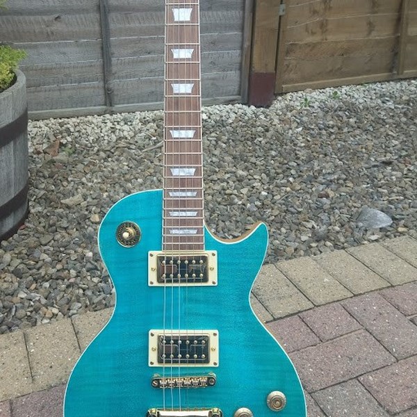

    Damn... forgot about this thread, was "finished" ages ago, when time allows it does need properly setting up, but all works
