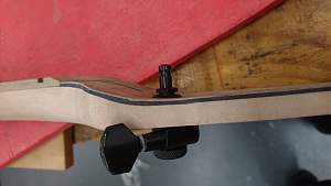

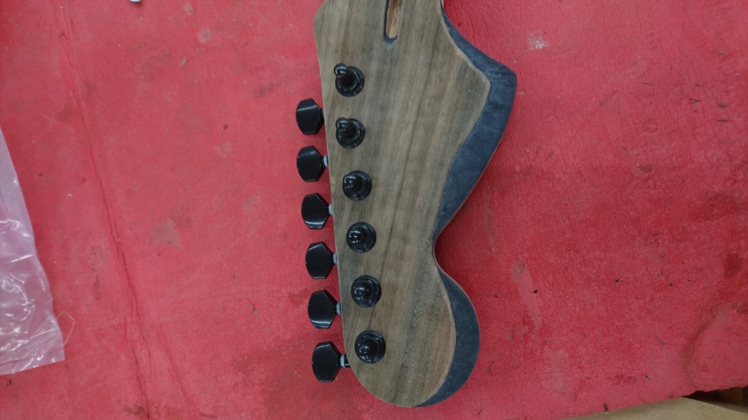

    I did have to deal with this issue though:
Name:	DSC_0080 (Custom).jpeg
    The nut on the tuners, even screwed all the way in, did not end up clamping down on the headstock. A bit of time with a little saw later though, I cut 3mm or so off of each nut, and we got them all in, and secure.

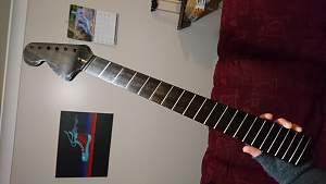

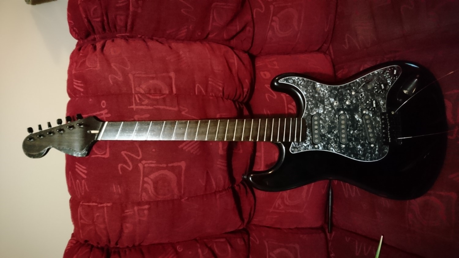

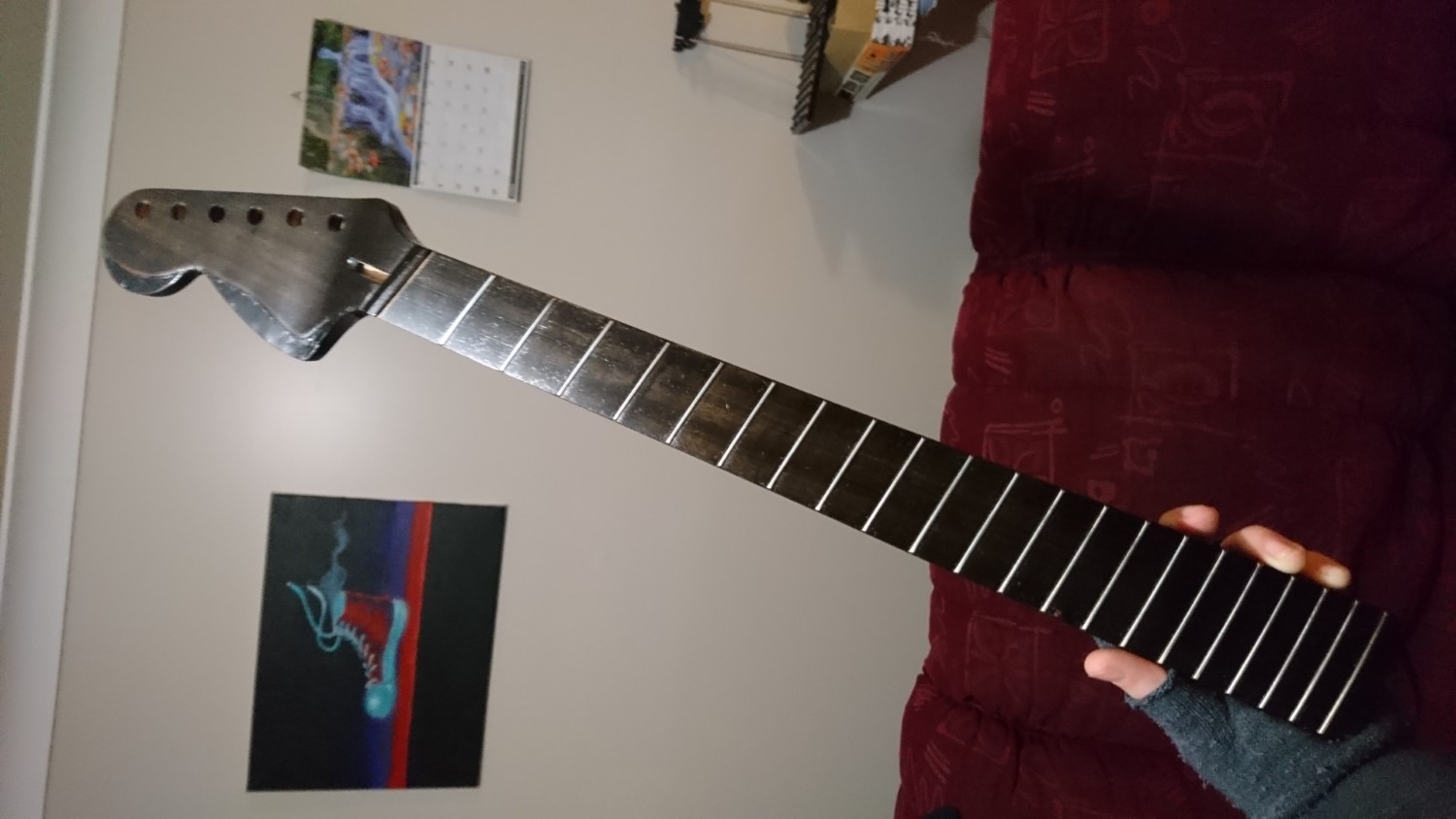

    After that though, I stained it with Feast Watson Prooftint, because that's all I could find in a hurry since I was very antsy to get it all done, gave the whole neck a coat with it. Then a few coats of Tru-Oil later:
Name:	DSC_0092 (Custom).jpeg
Name:	DSC_0094 (Custom).jpeg
    The headstock and fretboard are a bit darker than these pictures let on, but I'm still happy enough with it.
Name:	DSC_0098 (Custom).jpeg

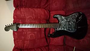

    And on the guitar!! Got it strung up, and it's all intonating perfectly fine, which is a big, big relief. Happy with the fan too, it's very subtle and is barely noticeable to me (but then I do have a 2.3" fan on my 7-String so I mightn't be the best judge...) It's not totally set-up yet, still have to adjust the action and truss rod a smidge, but it's all on, it's all working, and it's so much nicer than my old neck.
