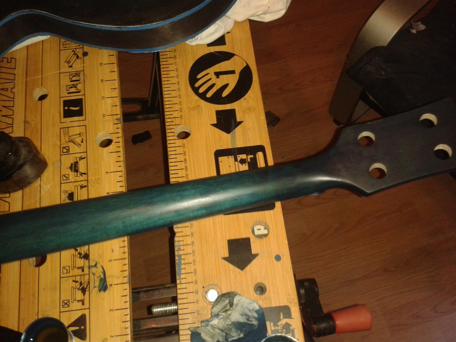

    meanwhile i just put on the 1st bit of colour.. it turned out a bit lighter than i aimed for but i still love it.. will have to wait to see what it turns into when dry but here's a pic of the colour freshly applied..
    the lighting is a bit off in the pic.. irl it looks a lot better

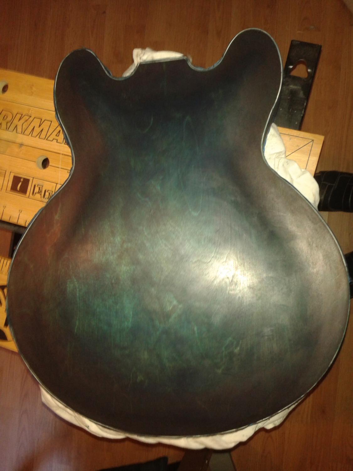

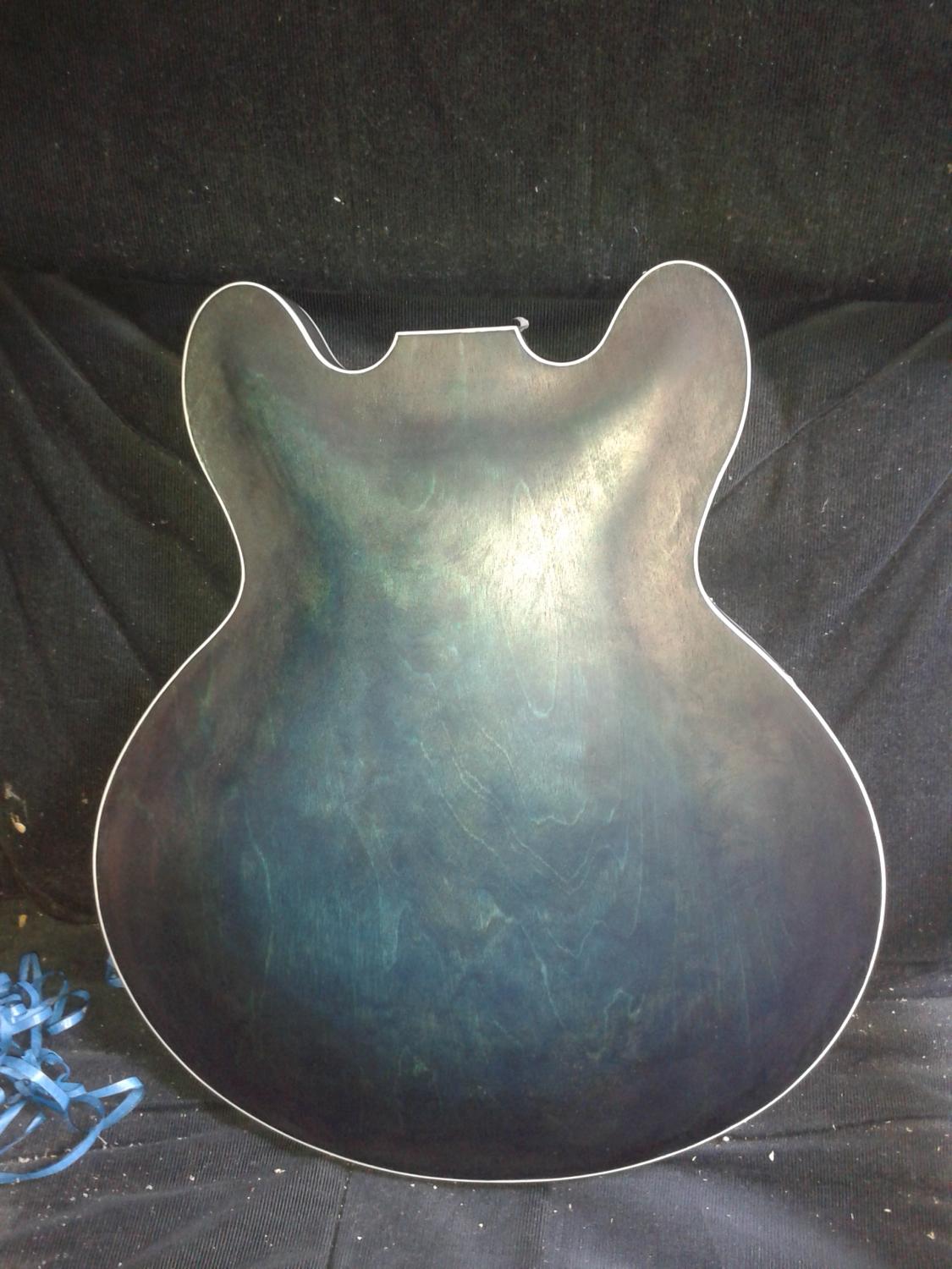

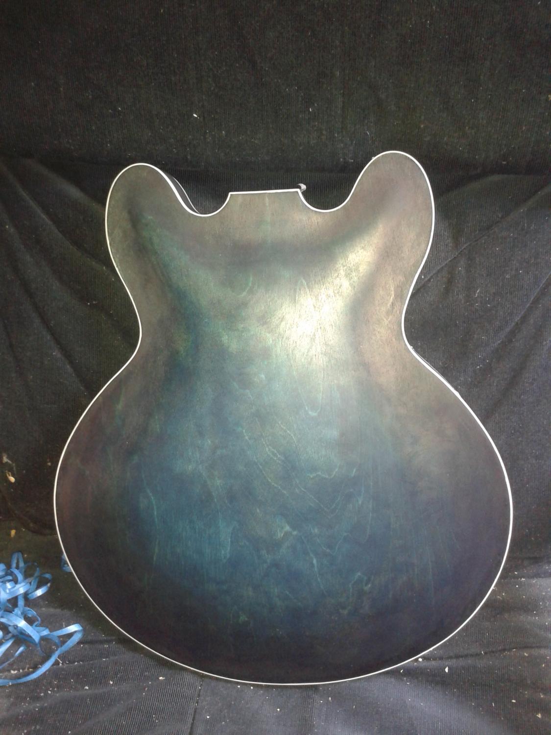

    That's what i am counting on.. i wanted a nice really dark blue turns out a tad lighter than i was hoping for.. but still pretty damm err.. pretty..
    did another layer on the back and neck.. and i think spraypaint may not even be required..

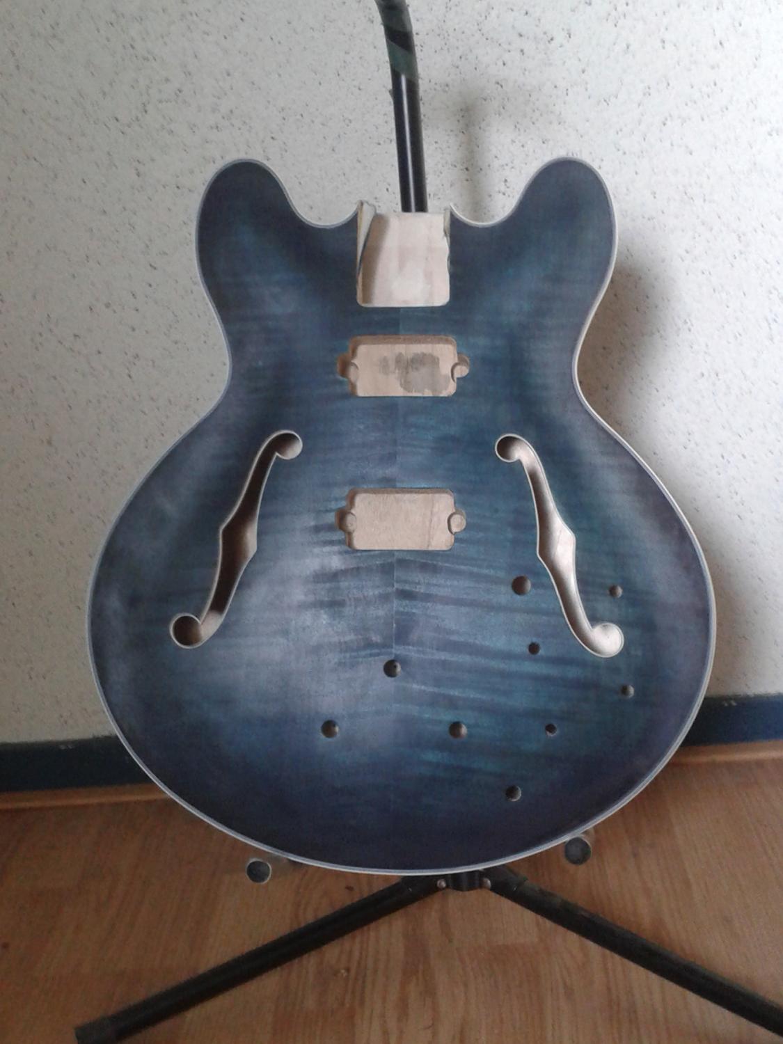

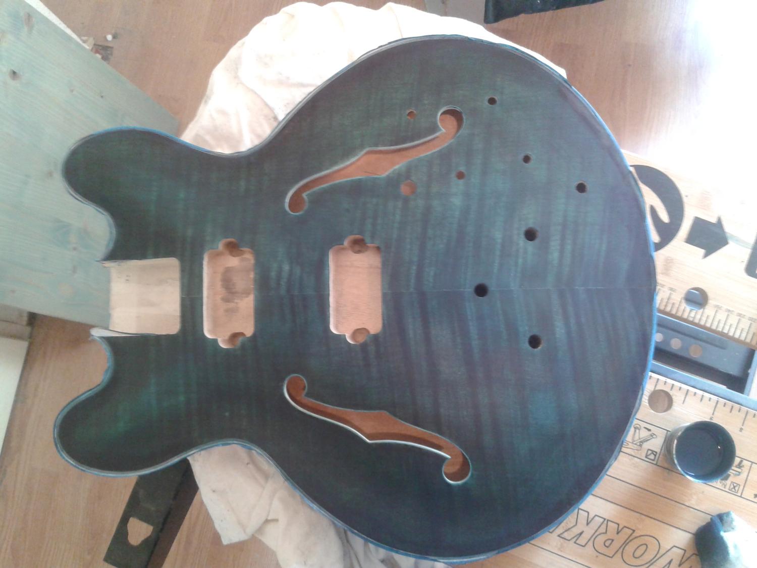

    1st colour on the top

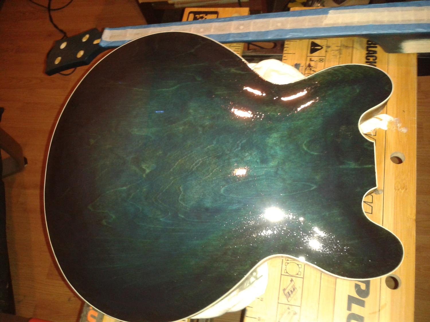

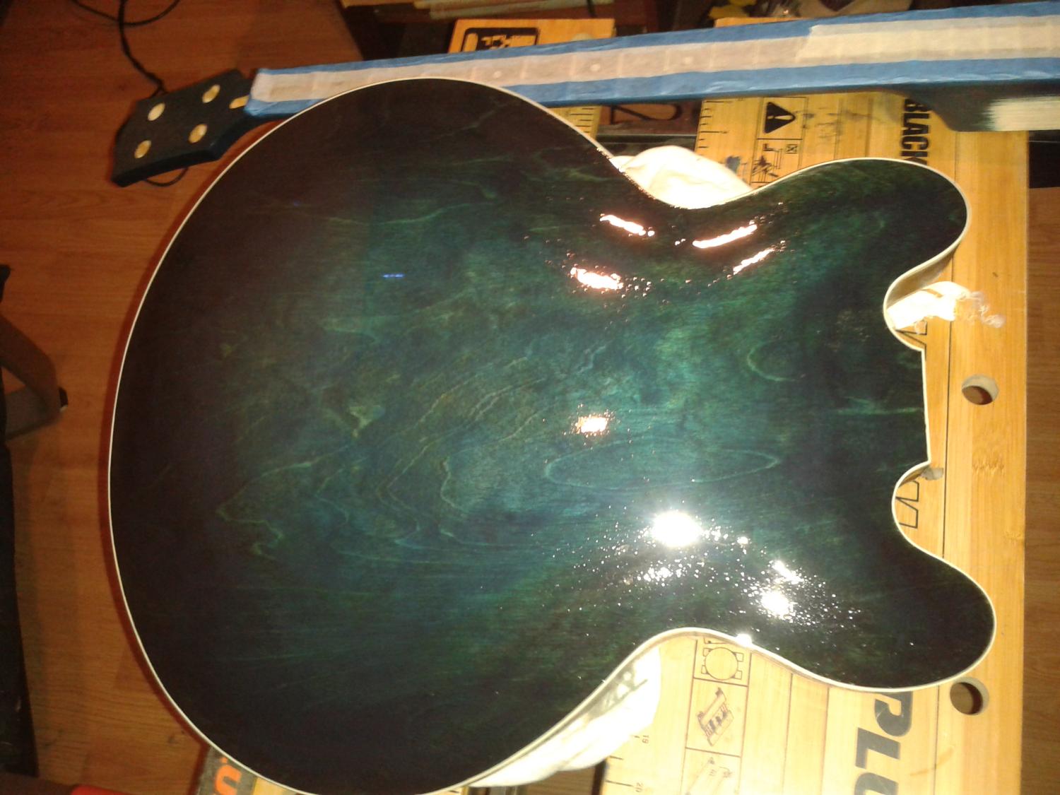

    i'm really happy how the colour turned out.. it looks a tad greenish in most of the pics but that's because of the lighting (and flash)

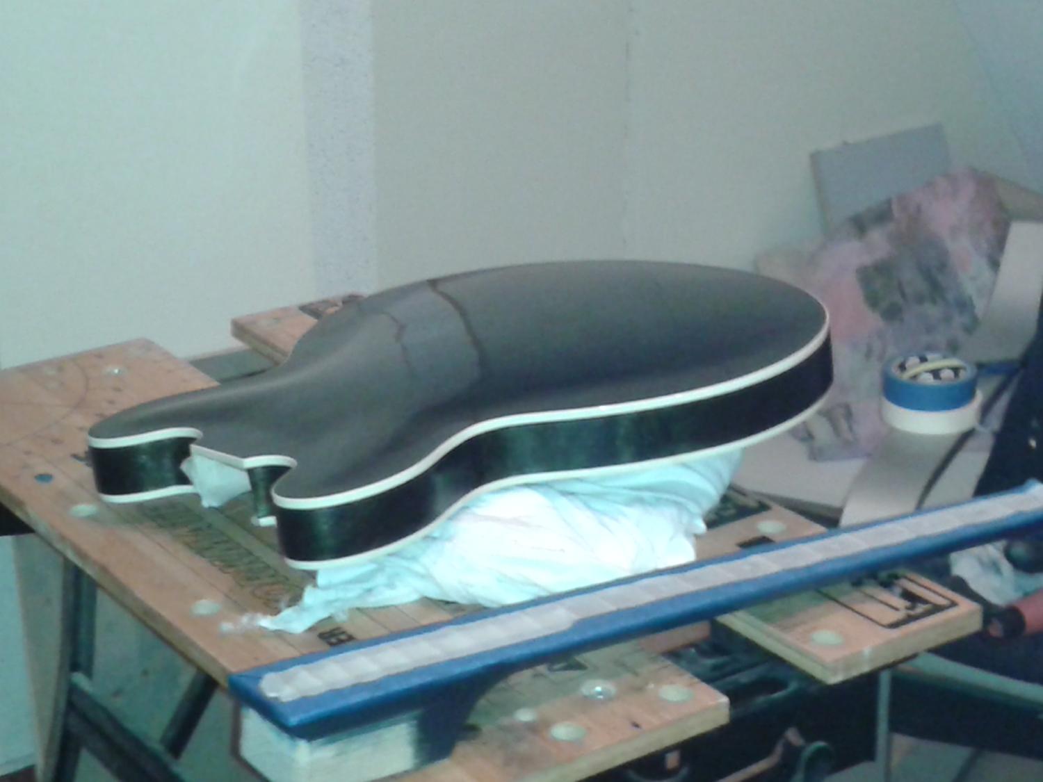

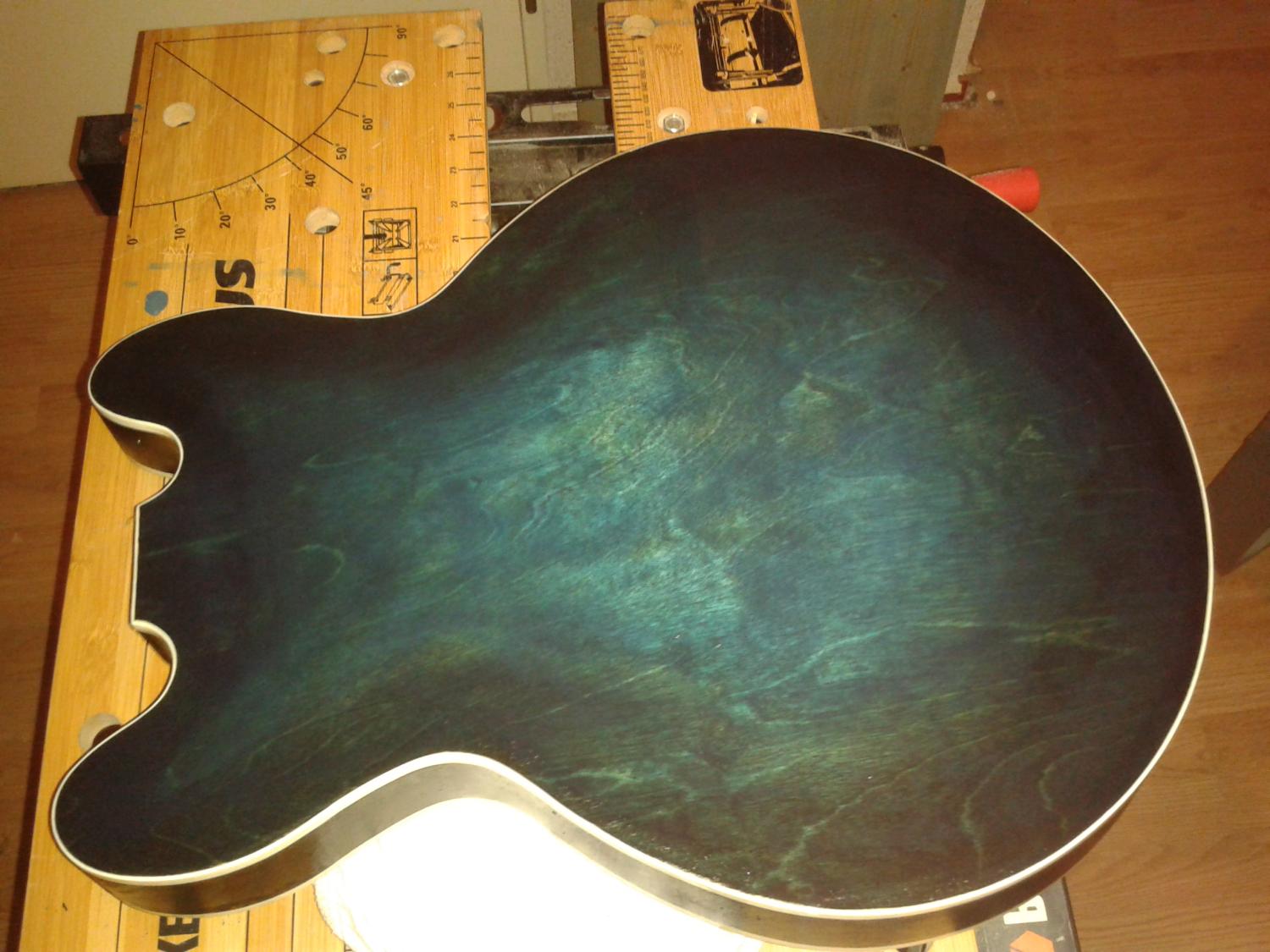

    i just pent some time with a knife scraping the binding clean.. i quite enjoyed that actually.. anywho.. here's a couple of pics
    this pic is a lot closer to the actual colour of both top and back.
