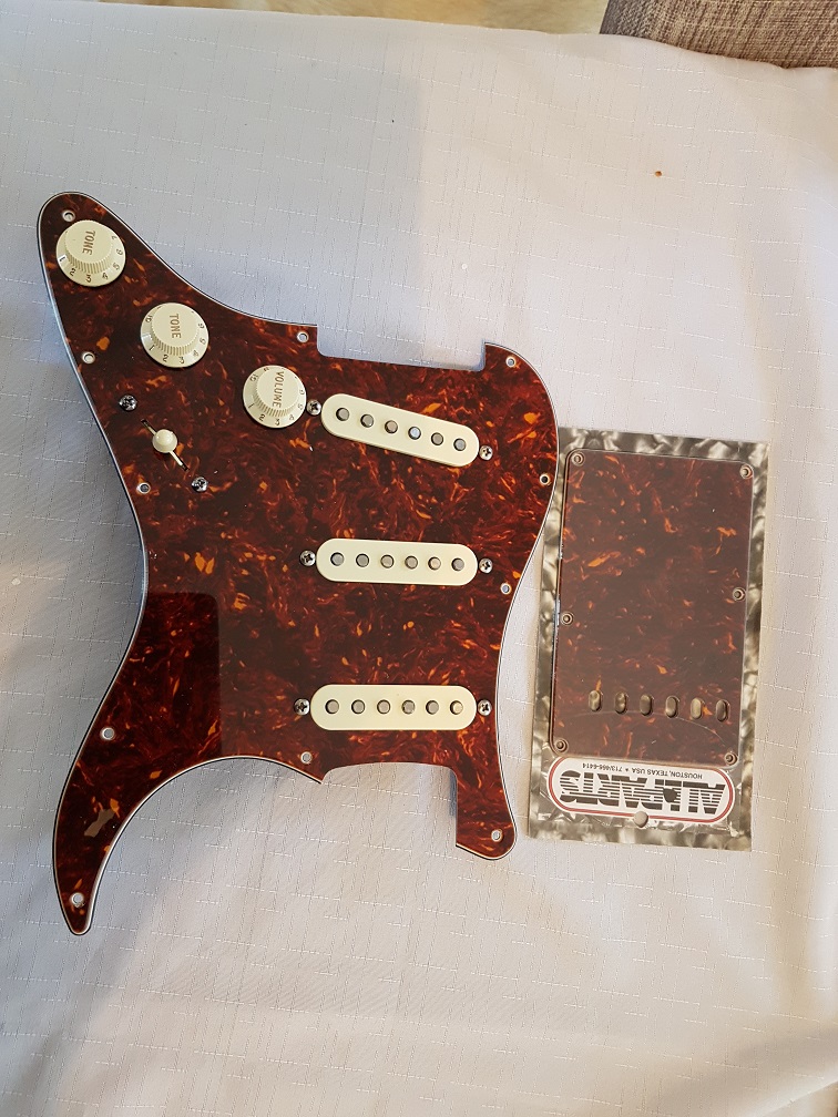

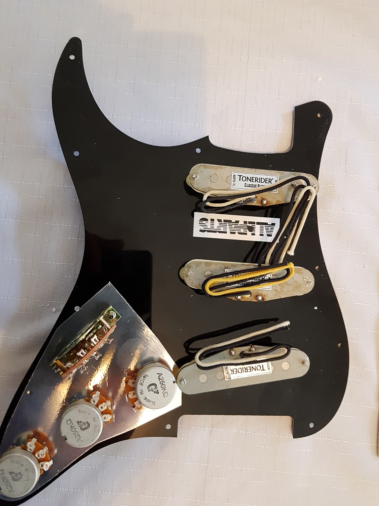

    Bits and pieces for this rebuild started arriving this week, Set of AllParts pickguard and backplate, Fender 5 way switch and antique white pickup covers, knobs etc, some Tonerider Classic Blues pickups, new pots and Caps and a SPST switch, which I haven't added yet to do the extra 2 pickup modes, all 3 on and Neck and Bridge on. Was going to start painting this weekend, but it freezing, so I'll be patient and wait.

    Glad I didn't start painting, a little bit of dermal work required. the control cavity is about 2mm to shallow for the new switch. apart from that all fits.

    Before getting the Dremel out, I'd just measure the existing cavity depth and the overall body depth just to make sure that you've got enough depth to deepen the cavity without making the cavity bottom paper thin. It's normally possible to bend the connection tabs a bit more to take up less depth. You also have to remember to avoid adding any extra depth when wiring up, which will mean taking wires around the switch, rather than over the top.
  7. #27
    Cheers Simon, checked that out I've got about 10mm's to work with, the tabs are bent level with the bottom of the switch, so should be ok.

    Bridge pickup is in upside down, just saying....
  10. #30
    yip, picked that one. when I went to make sure it aligned with the cavities.All apart again now anyway.
