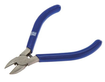

    It sounds like you will need to strip some of the insulation off the 'hot' wires as all the red solder points in the wiring diagram need to be made onto bare wire. This sounds like it may also entail stripping back some insulation on the overall cable insulation so you can expose some more of the earth/ground/shield wire (which is woven around the single insulated signal/hot wire), pull back the shield wire so that you have more of the signal wire exposed in order to get a longer length of the wire to strip the insulation back from.
    I don't know what tools you have handy, but a pair of small wire cutters is always very handy when doing any soldering work, something like this:
Name:	Wire cutters.jpg
    Not too big a pair; ones around 100-120mm in length will do. You can get much bigger cutters with a similar shape but they are more for cutting domestic mains (or larger) wiring and generally don't have fine enough blades for small work and they won't fit into small spaces.

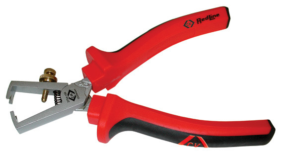

    You can also buy dedicated wire stripper tools, which are a good investment if you do a lot of soldering. I have some like this:
    You adjust the screw so that you've got an opening in the jaws that's the approximate size of the central wire core, clamp the jaws round the wire and pull off the insulation. Good for single wires, less good for stripping the outer insulation off complete cables with a shield layer and a central core.
    You should be able to find very low cost versions of the above at places like Jaycar or Bunnings. For serious amounts of work you can easily pay $200 for some wire cutters that will stay really sharp for ages, but for under $10 you'll get some that will be sharp enough to start with but will loose their edge over time.
