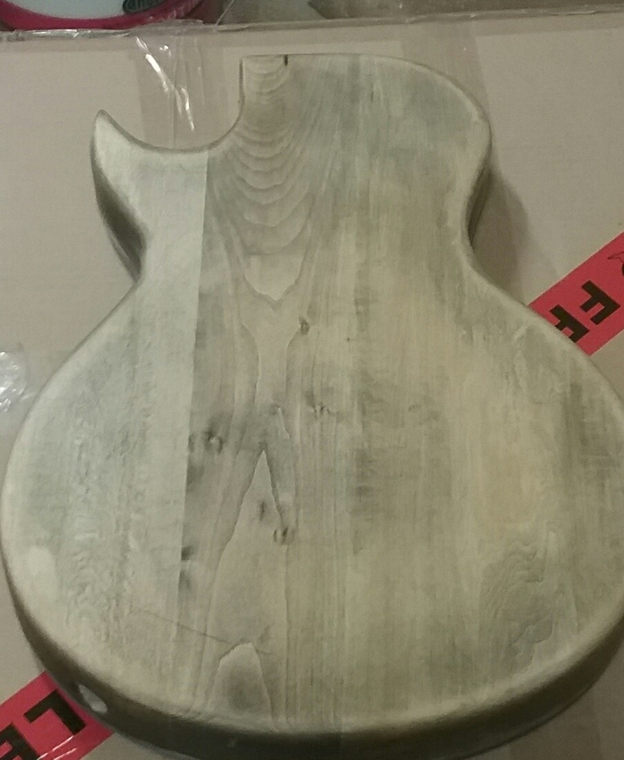

    haha yeah its a messy process the grain filling, but the results are worth it. Once you have sanded it back try not to rub a damp cloth over those areas as it tends to moisten the timbermate and it can come out
  2. #22
    Mentor Adam Barnes's Avatar
    Feb 2017
    norah head nsw
    613
ID:	20707timbermate sanded back and a wipe down with some gum turps and ready for some stain tomorrow night
  3. #23
    looks good Barnesy was worth the grain filling. Should feel nice and smooth with your fingers
  4. #24
    Feb 2017
    norah head nsw
    613
    Thanks wokka sanded to 120/240/320 , should look good woth some bondi blue stain

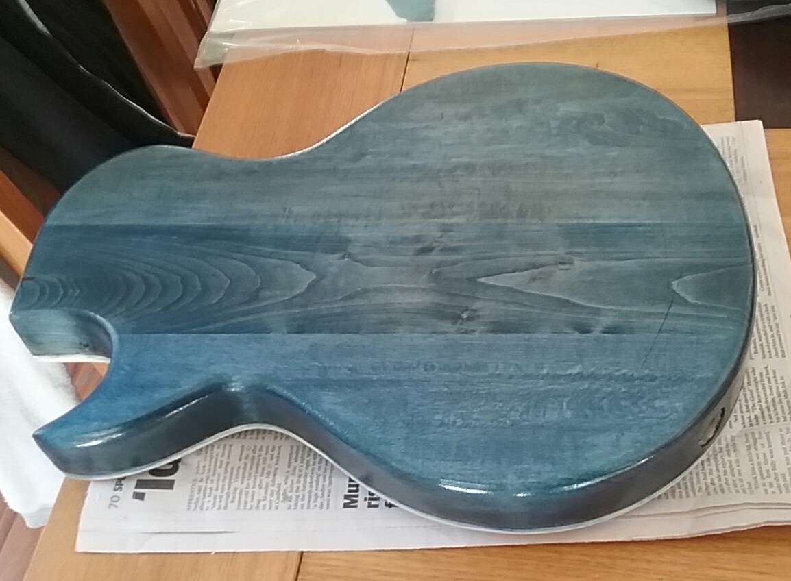

  5. #25
    Feb 2017
    norah head nsw
    613
ID:	20765stain coat done, gotta love a blue guitar

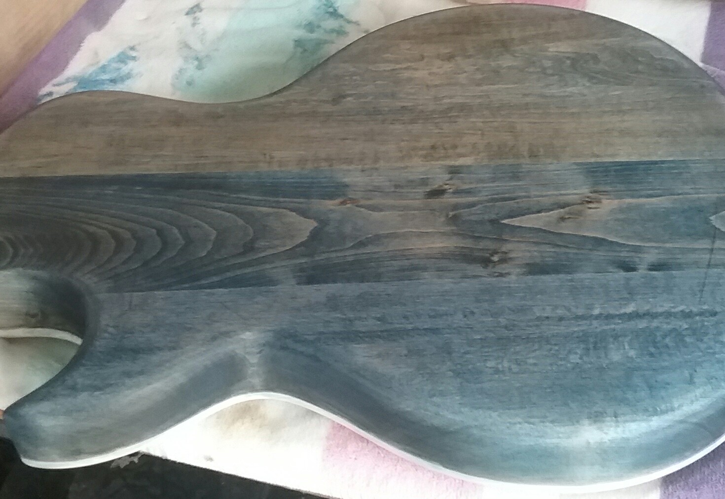

  6. #26
    Feb 2017
    norah head nsw
    613
    The ebony timbermate has definitely darkened the blue and stoped the yellowness of the basewood showing through

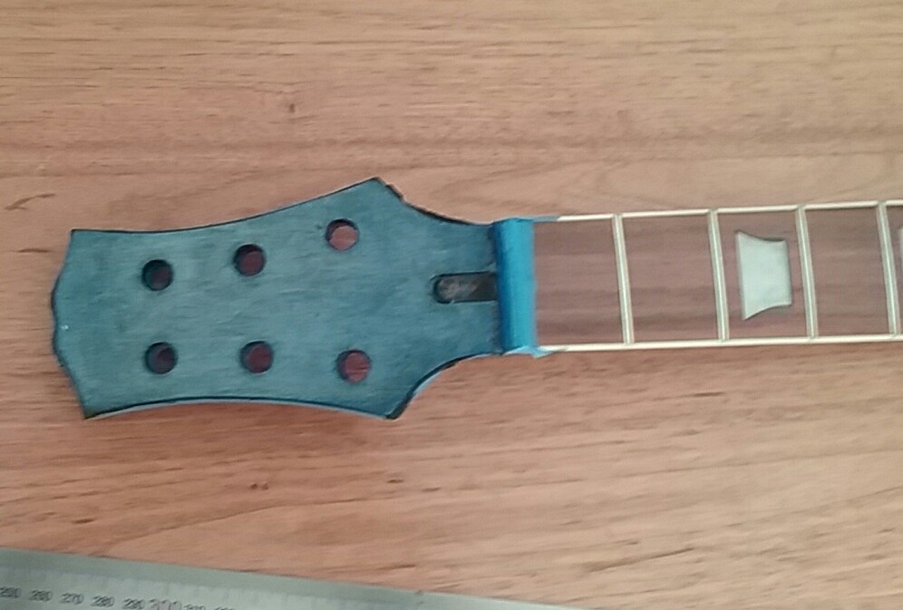

  7. #27
    Feb 2017
    norah head nsw
    613
ID:	20776Click image for larger version.

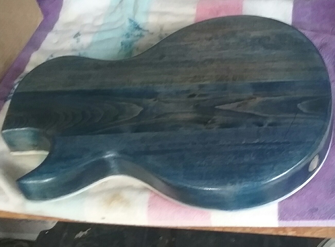

  10. #30
    Feb 2017
    norah head nsw
    613
ID:	20794Click image for larger version.
ID:	20795Click image for larger version.
ID:	20796final intensifying coat, super happy with the colour. So far 1 stain coat which i kept rubbing in over an hour or so period unitil i ran out of stain, and then 2 intensifying coats. Still unsure about the quilted top and weather to go straight naughty oil or do a sanding sealer first
