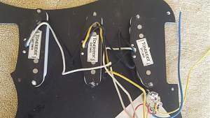

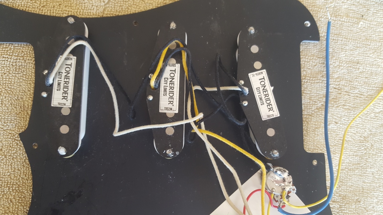

    i have just fitted the tonerider pickups and i just wanted to make sure i fitted them the correct way.

    Hey Brokin rotate all 3 pickups 180 degrees. Looks like there is enough wire to do so.
    Looks like they are in the correct location with the code having N = neck, M = middle and B = bridge

    thanks again wokkaboy. yeah i made sure i got the wiring and pickups in the correct spot but just wasnt sure if they were sitting in the right direction. thanks heaps 😊

    no worries Brokin. A general rule is the wiring should usually face the direction to the control cavity.
