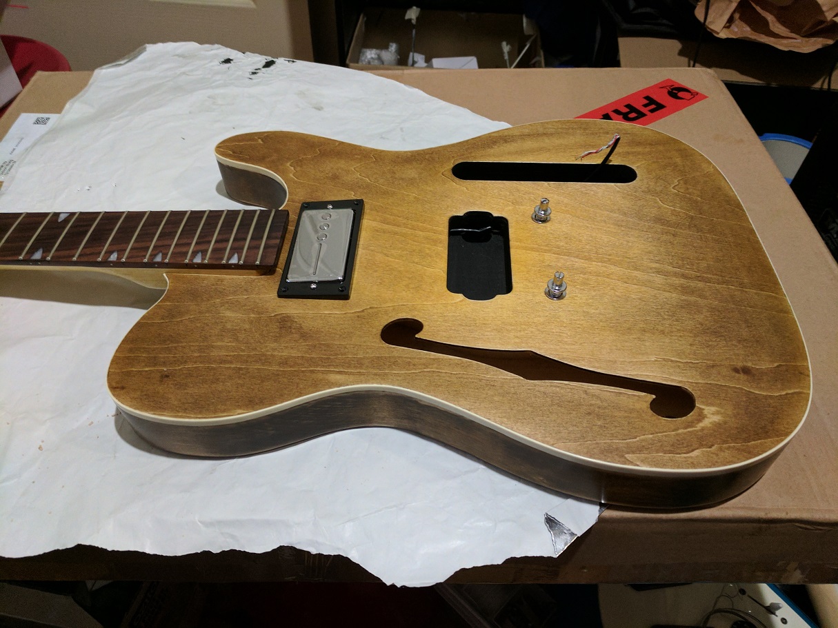

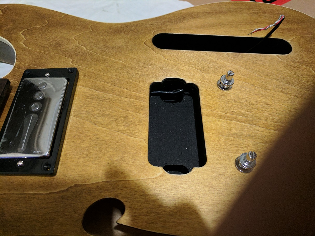

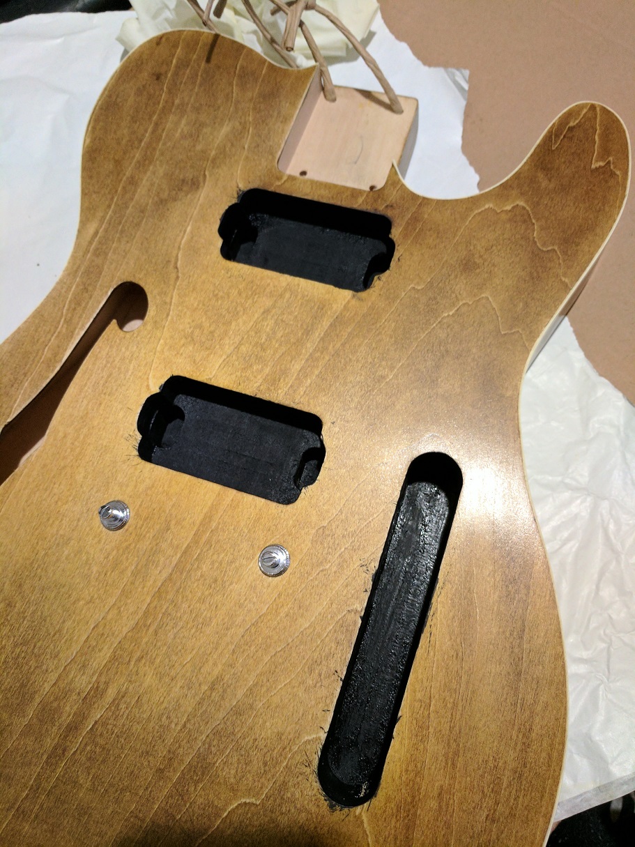

    Hi everyone
    It's been a very slow couple of weeks. Haven't had a lot of time to do much
    Cavities painted with shielding paint
    Cleaned up the the edges with some steel wool

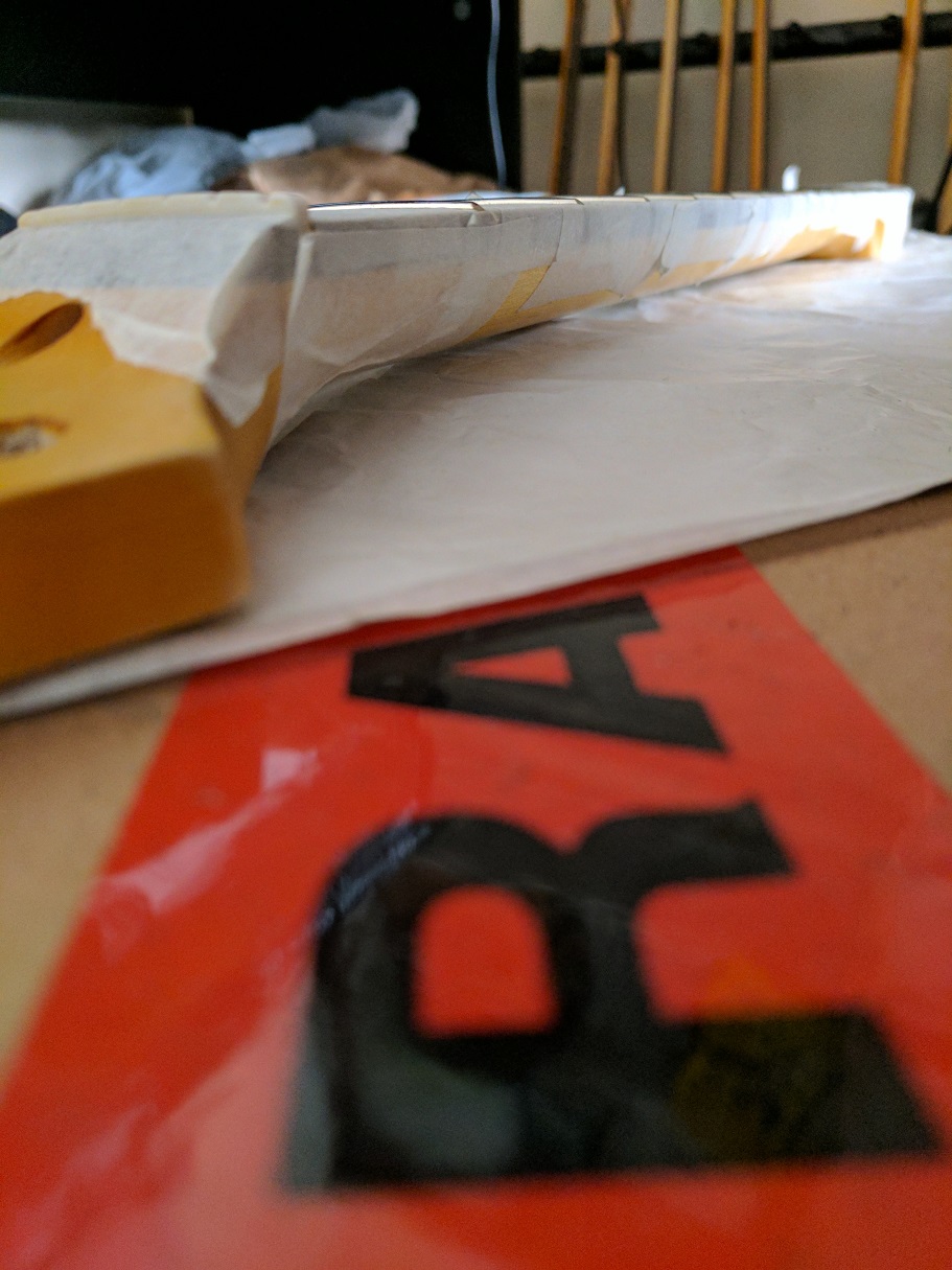

    Started doing the fret work
    Fretboard taped and marked with black marker

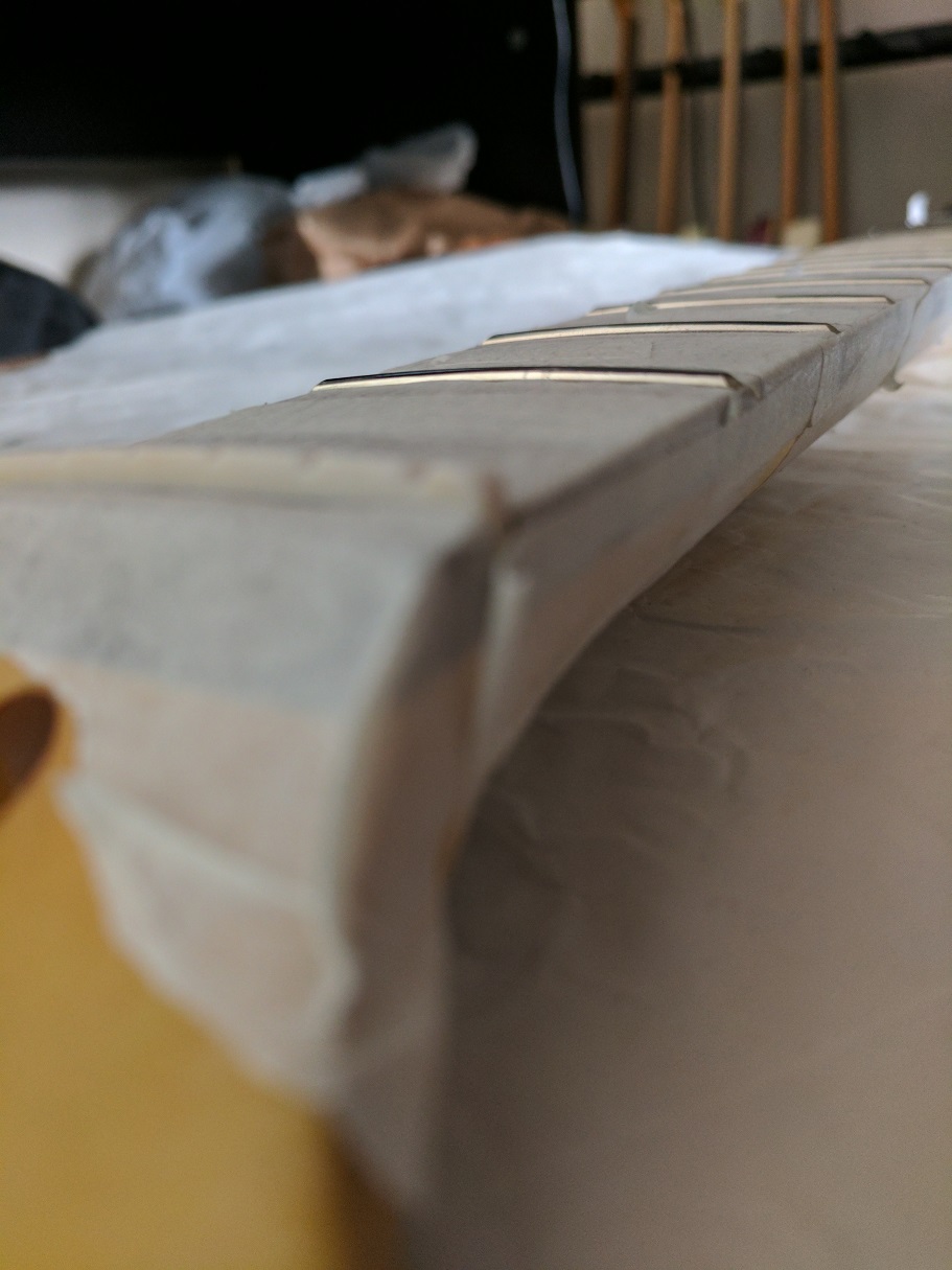

  10. #29
    Got the neck as straight as I could

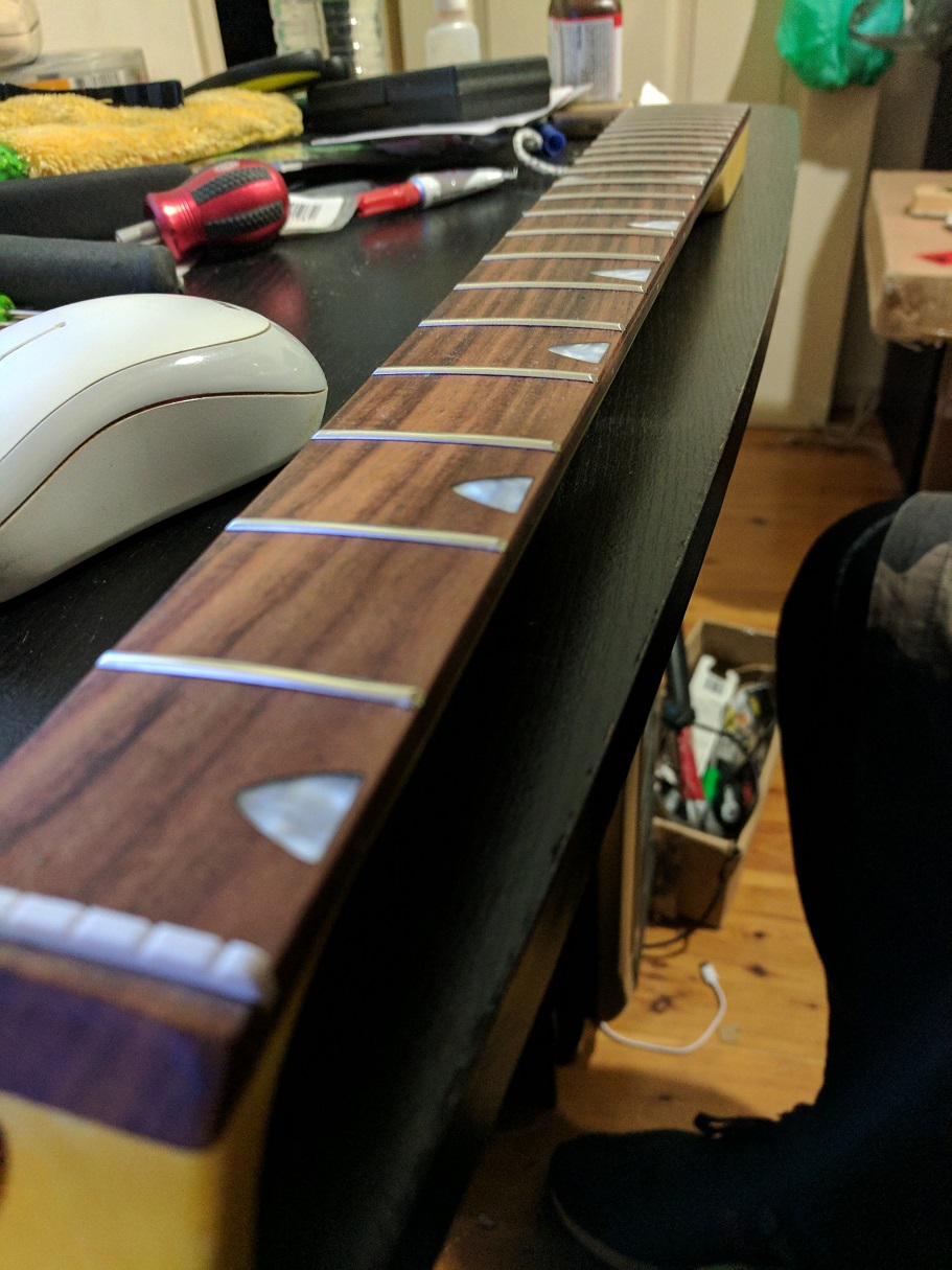

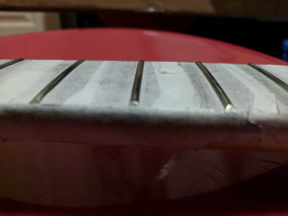

    Frets levelled
    Marker removed from frets

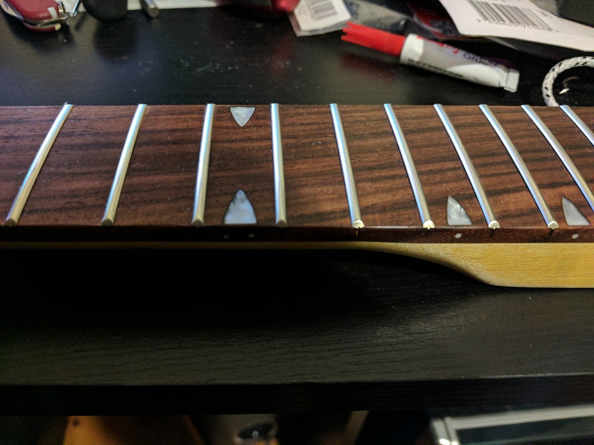

    And finally frets crowned and polished
