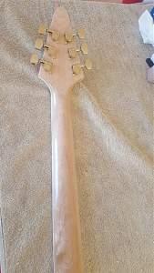

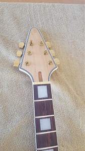

    hey guys just attached some pics. honestly nothing special as i have only clear coated it but i like the nice wood finish. the neck is done hopefully a couple more clear coats than the assembly.

    Oh Hell yeah! Some nicely matched figure in that front face veneer and some nice grain in the neck. Really clean and simple so far Brokin, nice job!

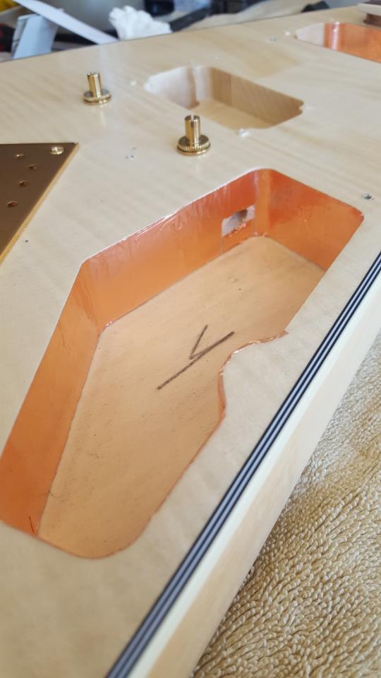

    hey guys just confirming as i fitting the shielding tape do i do the bottom also or just the sides like the pic.
  6. #26
    Hi Brokin,
    you need to do the bottom as well, the idea is to create a shield around the electronic parts to eliminate interference.
  7. #27
    Hi Brokin,
    I would tune to standard E tuning and let the neck set in. Once it has then tune to your C standard and then it will have to adjust to that.
    It's worth shielding all faces of the cavities and the bottom of the cover.
    EDIT just pipped by Franky this time !

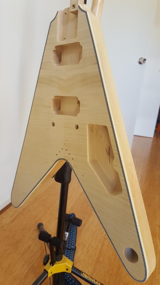

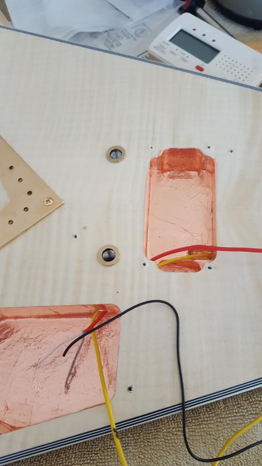

    thanks heaps again i basically put it every where i needed to and i think i did pretty good.
    ok but now i have a little issue. i noticed with the wiring it needs to earth to the bridge. but there is not area where i can feed through the wiring to solder it on. anyone else come accross this issue?
    help 😟
  9. #29
    Brokin good job on the shielding. There needs to be an earth wire from the treble side bridge bush to the control cavity, so you will have to remove the bush. If there is no hole drilled you have to drill one, preferrably with a long drill bit, 3mm drill is big enough
  10. #30
    Normally in the kits, you will find a wee hole in the control cavity, which runs through to the hole for the nearest bridge post. the idea being you feed your earthwire through that and then insert the bridge post anchor over the exposed wire to create an earth connection to the bridge.
    I notice you've already got the bridge anchors in place, was there no hole apparent when you popped them in?
    Edit: I've been WOkka'd again!
