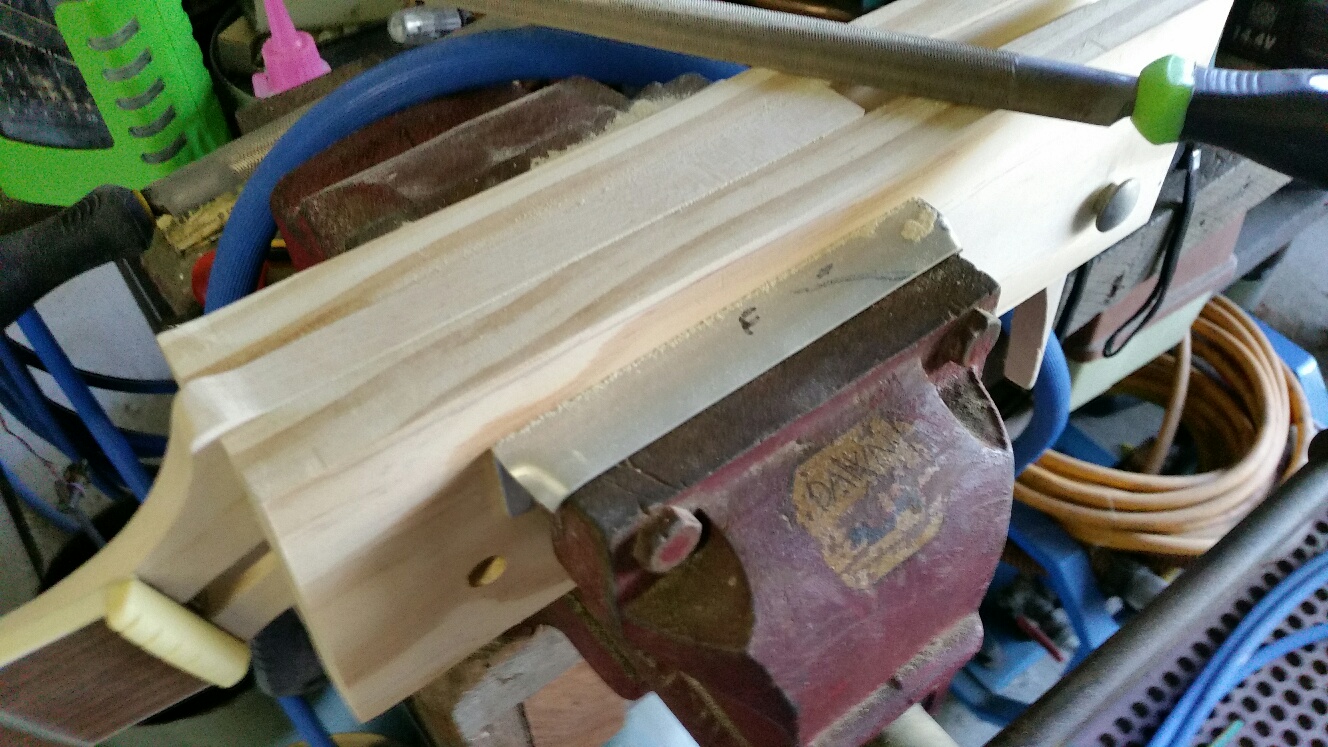

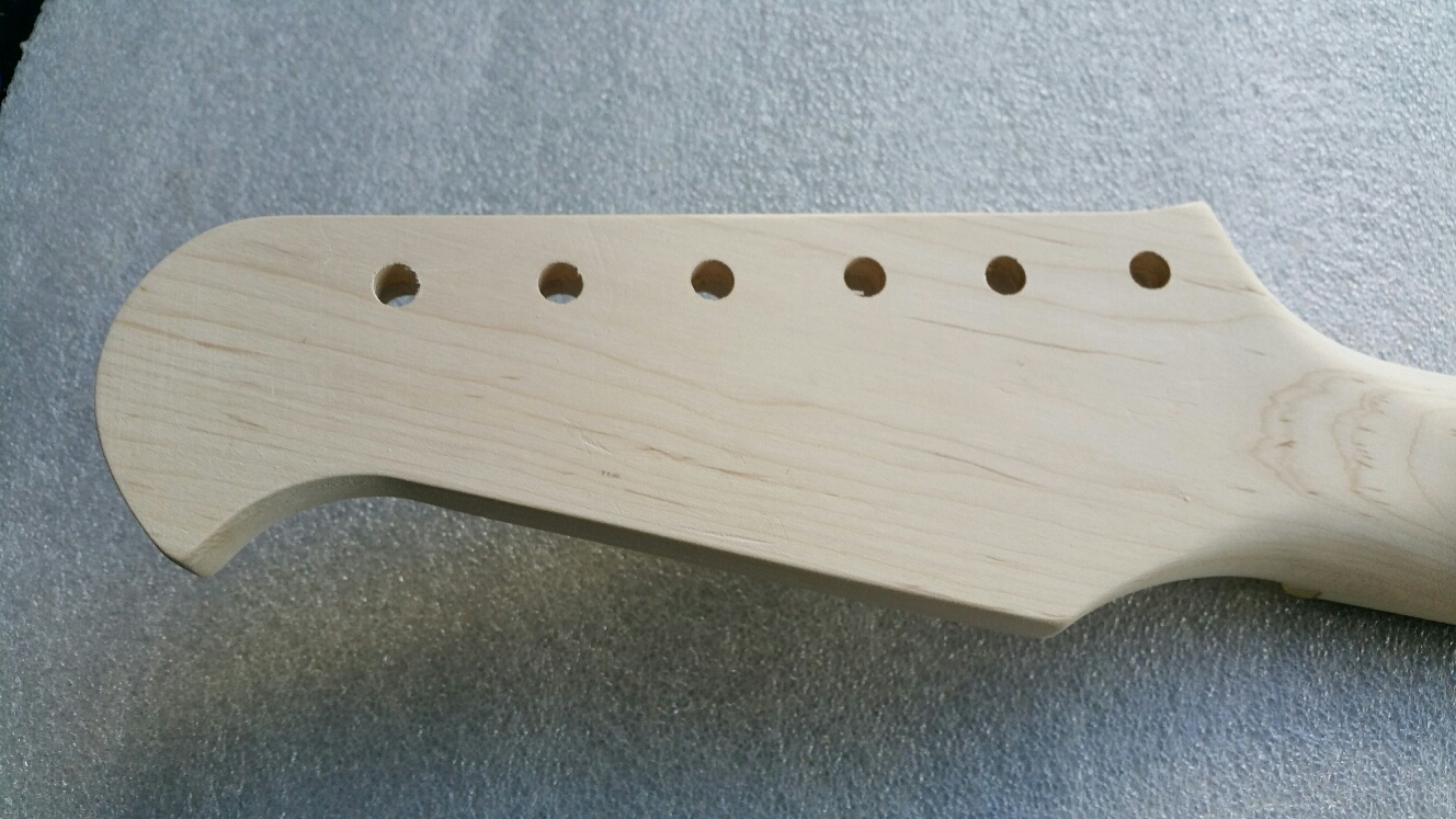

    Spent a few hours shaping the headstock... turned out reasonably well for a file and sandpaper job...
    I've included a shot of my jig to hold the neck in my vice so it could be worked on. handy thing is it also allows to be reasonably sure the filed/sanded edge sections are square to the front face... and nil vice marks on the headstock (which my vice is easily and perfectly capable of doing.. it will crush wood if you want it too)...

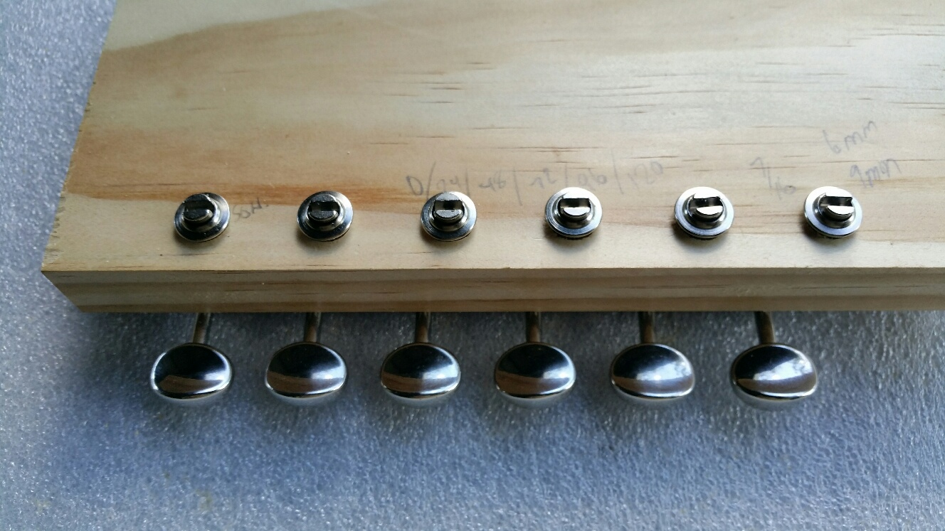

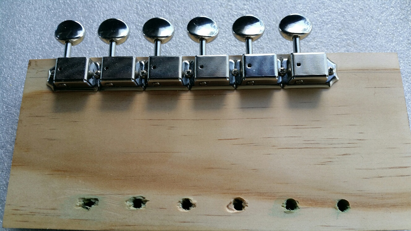

    Also a couple of pix of my pine tuner test template drilling trial, and yes the pine is thicker than a headstock so the ferrules don't sit low enough, but it was only to prove drilling measurements and spacing.... The exact same drilling (as close as possible) was done to the headstock...

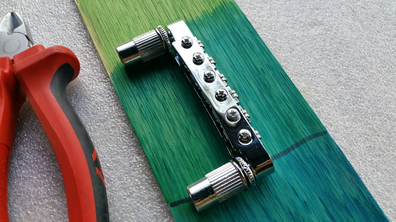

    Had a play with colours... I'd like to hear opinions...
    Which colour is best?? Top, bottom, or Left or Right of the bridge ?? Or none of them ...

    Your daughter has a fine taste
    I'd go for the middle one.

    I like the brightness of the top colour

    I agree with Kick, the middle one

    Either side of the bridge are slightly different versions of the Teal Green/Blue. In this instance my preference strongly leans toward the Right of the bridge side hue, however the Left side hue is much simpler to replicate. I might try it all again but with a substantial reduction in the strength of the Green as I'd still prefer to have it at this stage a bit more Blue as the Shellac I intend to put over the top will pull it back slightly toward the Green ...
