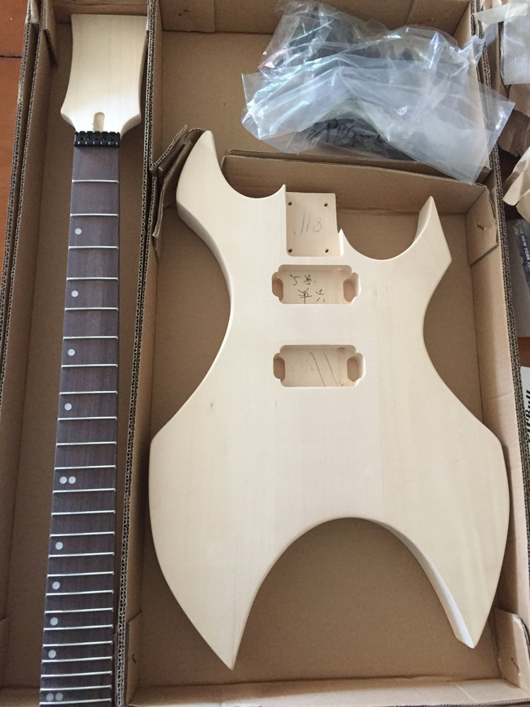

    Kit just came in the mail!
    Doing a quick run through now to see what's what. Bit tricky with both kids trying to 'help' lol

  9. #29
    Looks like a locking nut that comes with a floyd trem but no trem on the body?
