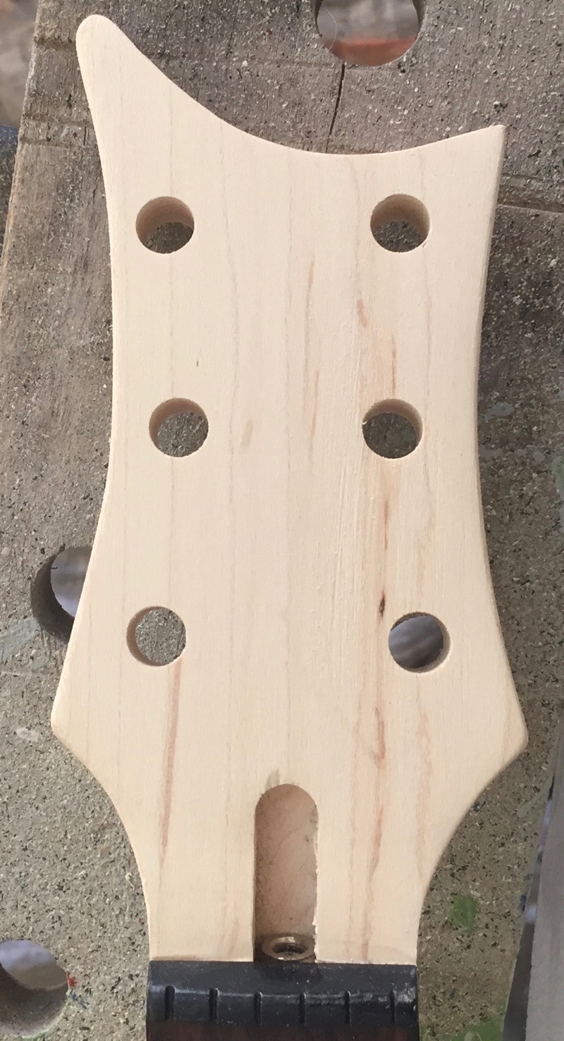

    Hi everyone, a week or so has passed and a little bit of progress achieved. The dents are gone!
    I was pretty scared of the steam thing so tried just a little of cool dampness to observe what (if anything) might happen. Three days later with a little damp cloth application each evening, and they dents have pretty much disappeared. If you know where to look and get the light in just the right place, you can just make out one last mark. I can live with this.
    So moving on and today I finished shaping the headstock. Similar to PRS but as the pre-drilled tuner holes are not in PRS position then it could never be exactly the same, so why pretend eh?

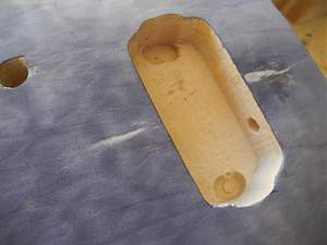

    My next critical task is to drill the holes for the bridge posts. I am using a wraparound bridge so any top tips are appreciated!
  7. #26
    nice job with the dent repairs
    As for the bridge, I'd fit the neck and measure about 600 times. Put some low tack tape on the body to mark out a centre line and bridge position the measure again
  8. #27
    Put some low tack tape on the body to mark out a centre line and bridge position the measure again...
    ... and then post measurements and/or photos here for confirmation. It's always good to get a few other sets of eyes on something critical just to double-check.

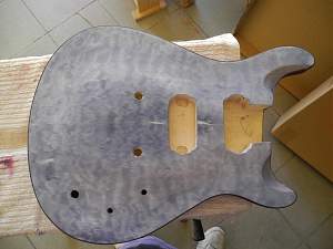

    Post holes drilled with a little damage to the veneer which will disappear under the bridge once assembled.
    Moving on to the finish, here it is after the first black stain. Plan to sand this back a bit before further colour stains go on.

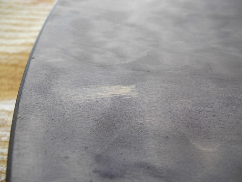

    as you can see there are some problem spots...

    I think I have sanded through the veneer?
    Ideas to recover/cover?
  11. #29
    you can try getting an tiny artists brush and several different dilutions of your stain and painting the grain pattern back in. (not easy and very time consuming)
    Are you sure they aren't glue spots?
    How would I tell the difference?
