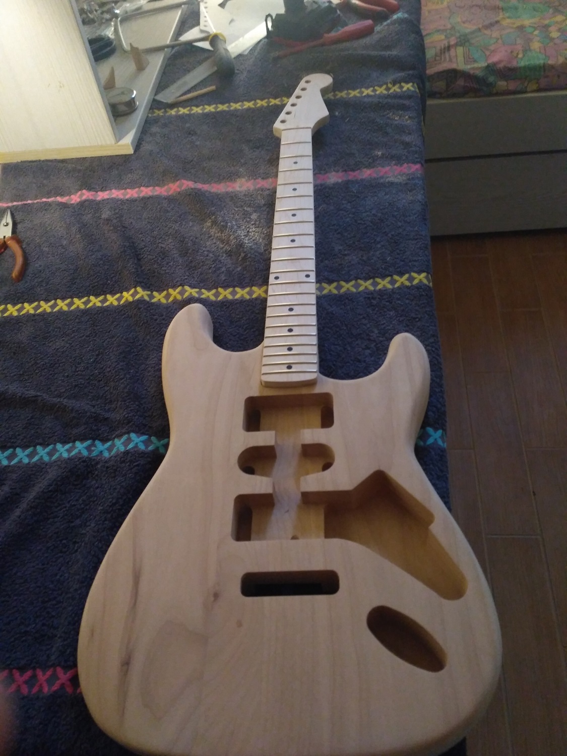

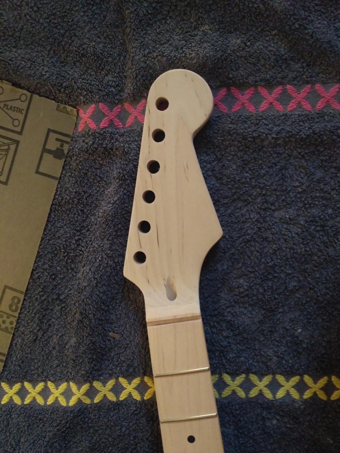

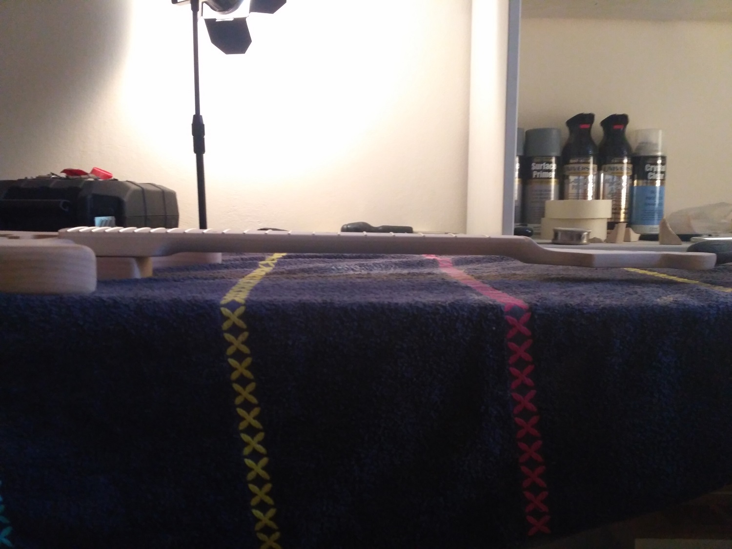

    Ok. So I cut the headstock and sand it perfect. I fixed the neck pocket issue with a little piece of maple. And i've sanded the hole guitar down to 400 grid.
    I think tomorrow i will start with the primer!!

    Now the neck fits exactly the neck hole from every side and the neck can be supported from the body with no screws.!

    You're certainly very enthusiastic over your build! Nice headstock shape. And glad you've now got a nice tight neck joint.

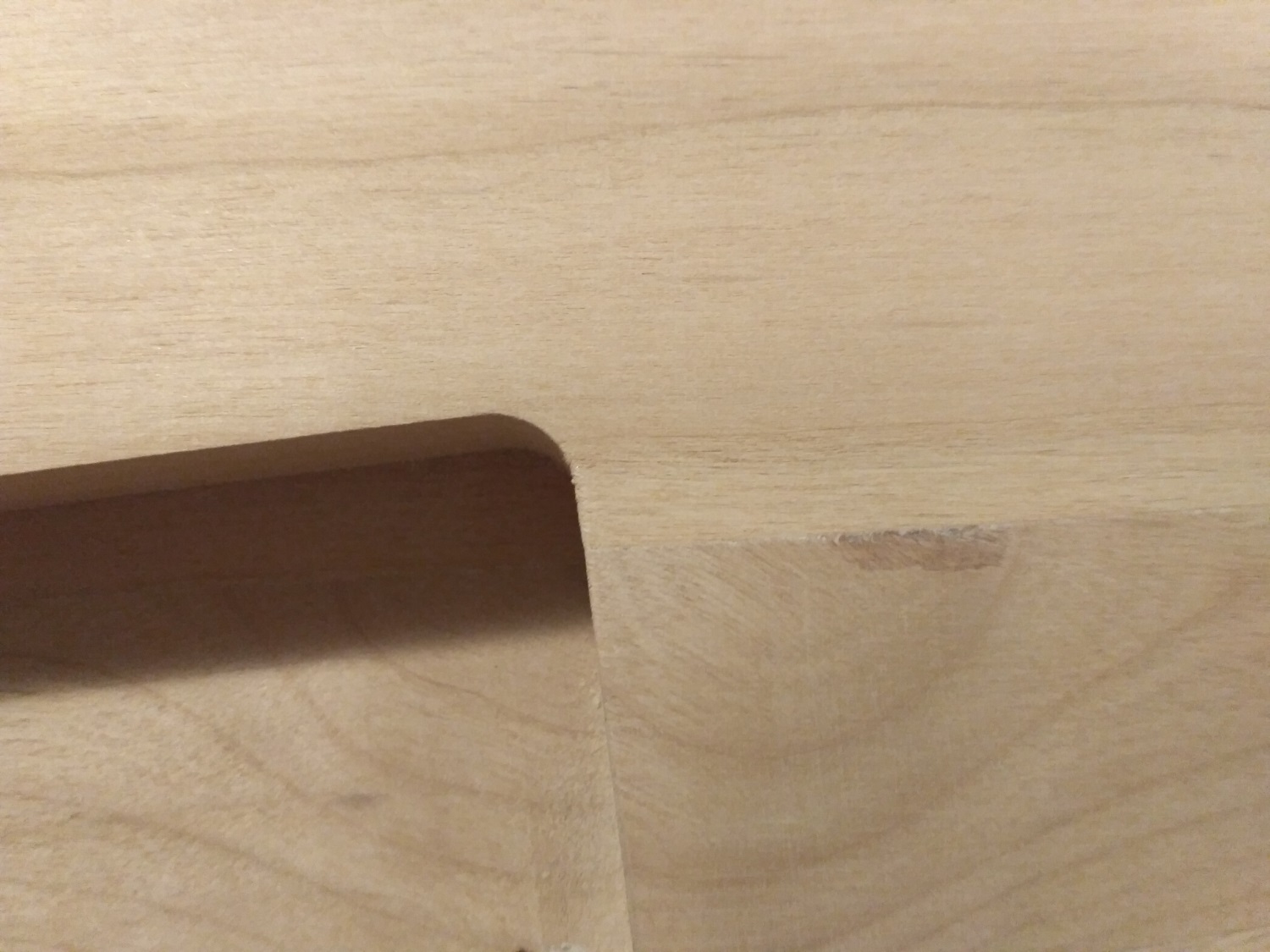

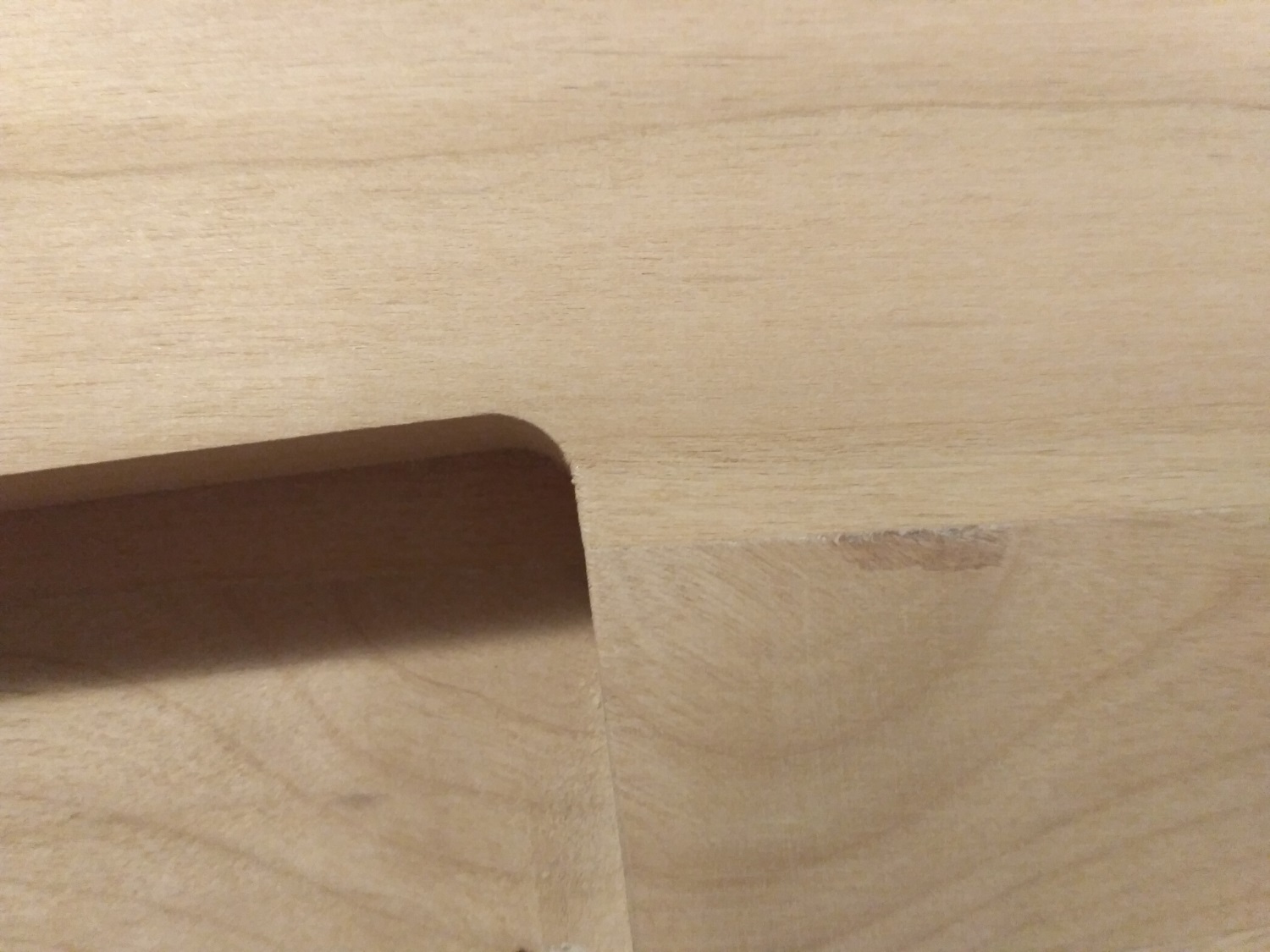

    So no primer for me today. It's a bad day for painting today in greece (too much wind) and since i've got an open garage i left it for today and decided to do some more sanding as the pro's said (sand sand and then sand some more). Which actually helped a lot!
    So before start sanding again today, i used a damped cloth first in the body to help me see any missed spots. And i saw one spot that i though i've done right but it turns out i missed it.
    This is from the back of the body and it's a joint with a glue stain. I've sanded it yesterday and seemed ok. But today with the damped cloth i reallised there was a lilltle bump you could feel by hand. So more sandingthere with 320 grid. Now the bump is gone and it's smooth.
    But it seems like there is some glue left there. Can't feel it by touching but it's there. And it seems like it's a bit deep inside.
    Will this glue give me any issues when start finishing or after the primer i'll be ok??
  10. #30
    The glue spots are only an issue when staining or doing clear finishes. For a painted finish, they aren't going to affect anything.
