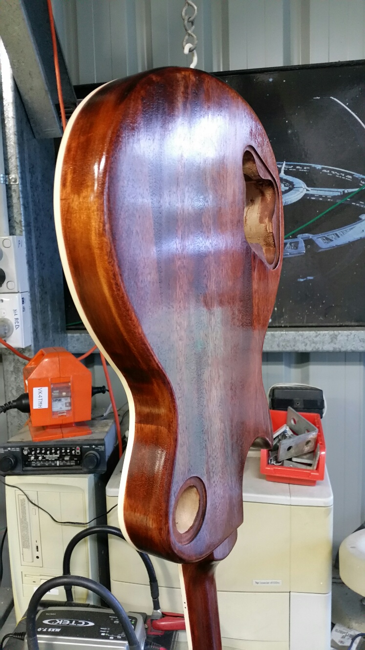

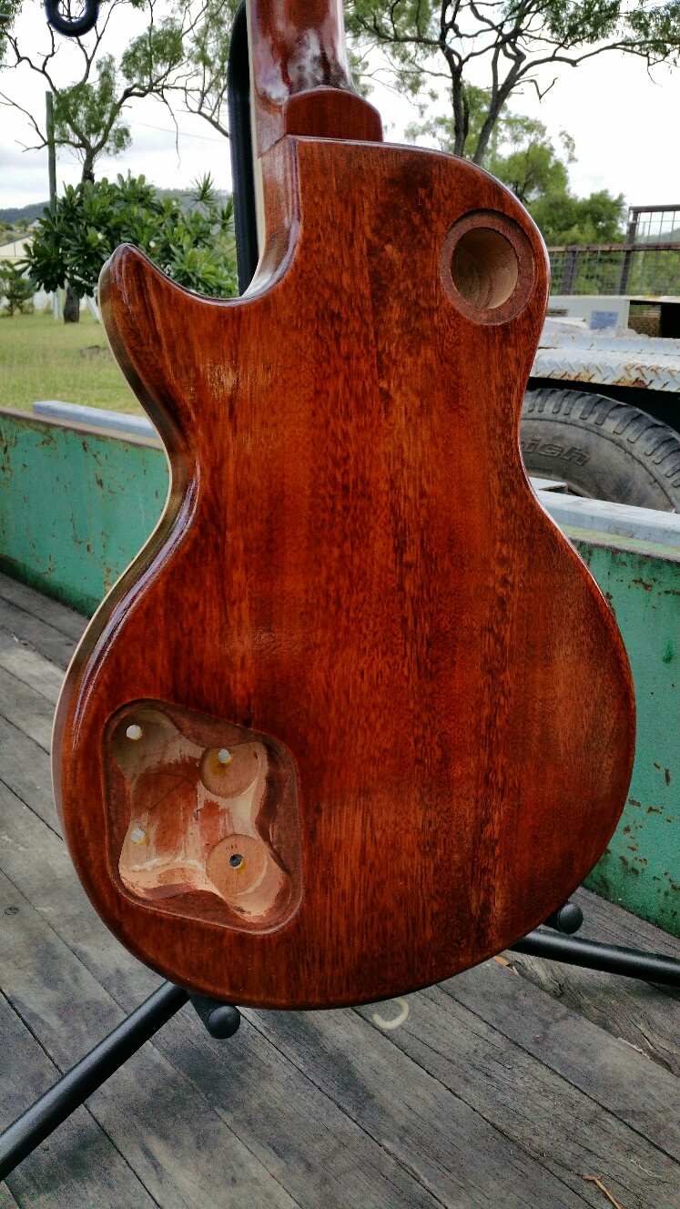

  3. #23
    The back of the guitar looks very nice indeed.
    The top's looking good too apart from those probable/possible glue areas down the join. If it's not glue on the top, then it should take the stain a bit better. It's only the bit between the pickups that really stands out. If it were me, I'd get a small brush and try and stain just that section a bit more. If that doesn't take, an oil-based stain might work better on the glue areas.

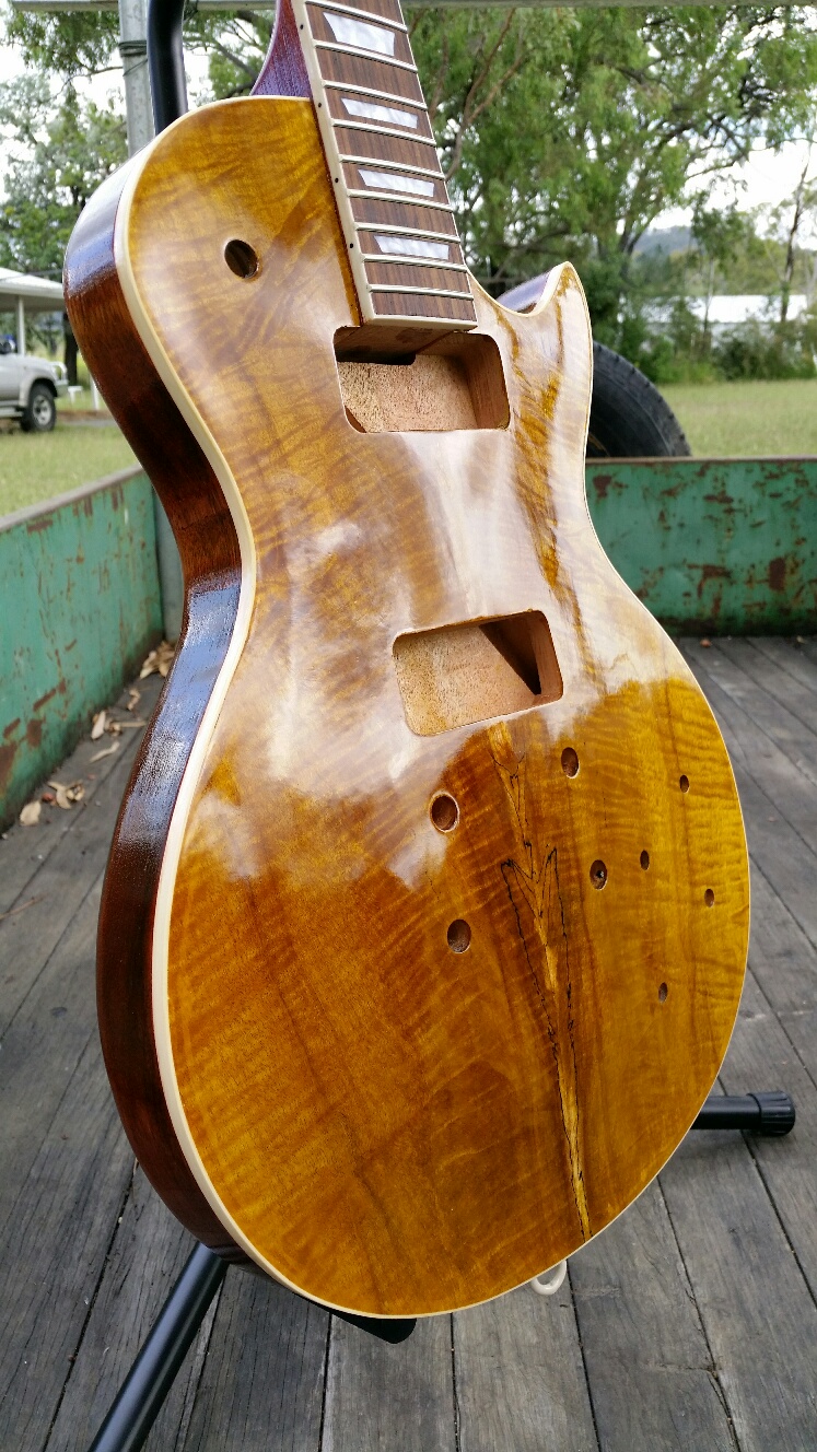

    So I got the first coat of hard Shellac down today... did it French polish style purely to see how it would turn out. Seems some parts of the top were thirstier that the rest as the shellac truly disappeared in some places particularly on either side of the neck picup hole. There are a few imperfections from the wire brush and a few more grain holes than I realized, but overall I'm pretty happy with the result so far....
    I think I'll leave it for a day or two to harden/cure/dry before I set in the neck...

  5. #25
    looking very nice Marcel, will you continue with more coats of shellac after the neck is set ?
  6. #26
    Mentor Marcel's Avatar
    Apr 2017
    Bouldercombe Qld.
    1,168
    I intend to. Hopefully somewhere between 5 and 10 coats depending on how the finish comes up, and how well the imperfections disappear...

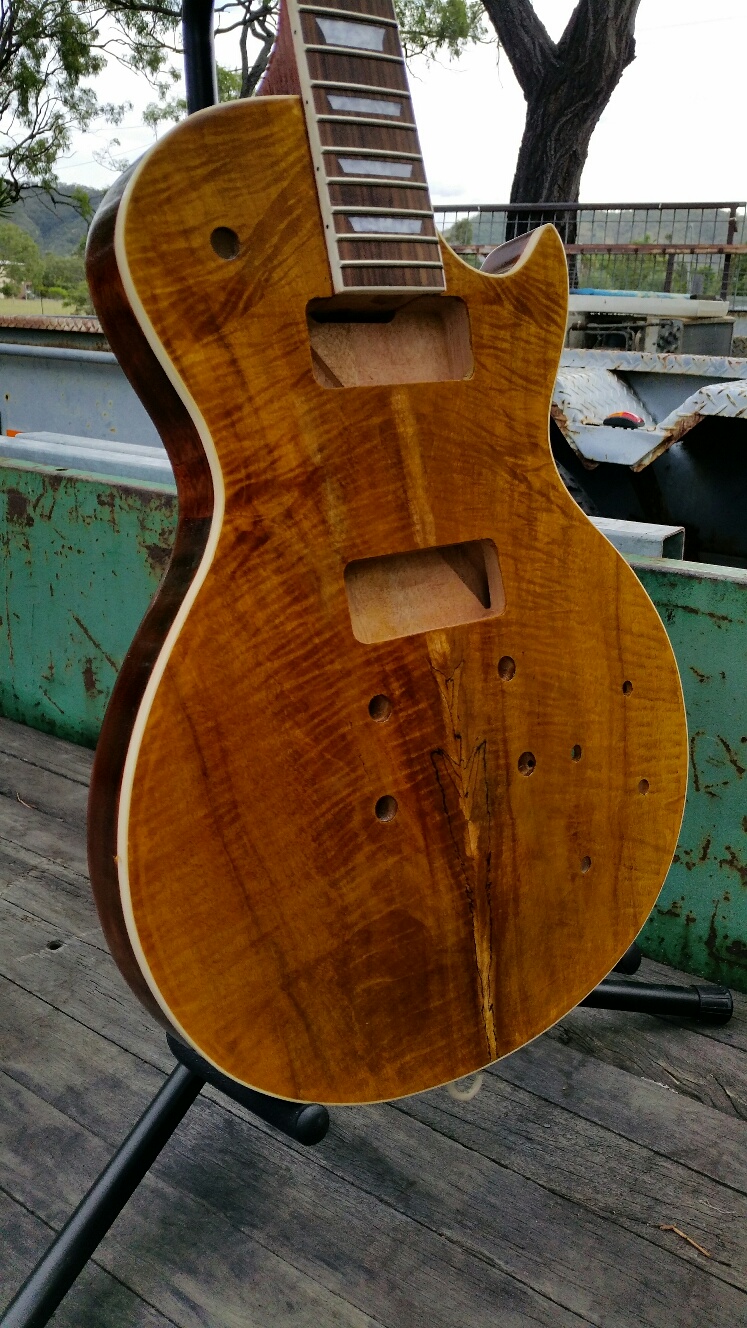

    Hanging to 'dry after first coat of Tru-oil. A few 'coats' of Shellac added in too for good measure...

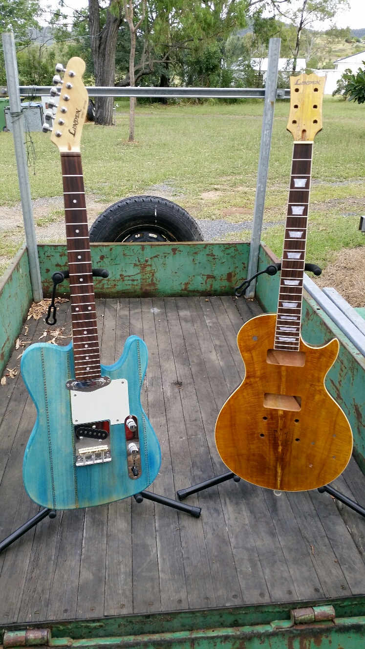

    Three coats of Tru-oil and I've lost count on how many Shellac on the LP-1SSP...
    And a family shot of its kin in the same birthing room who isn't exactly a kit.... DR Parts Alder body, Kmise neck and PBG hardware kit
