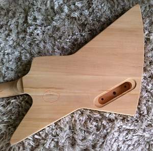

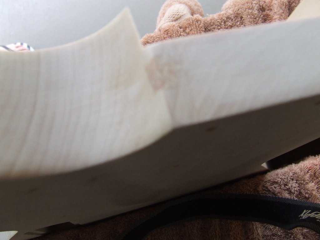

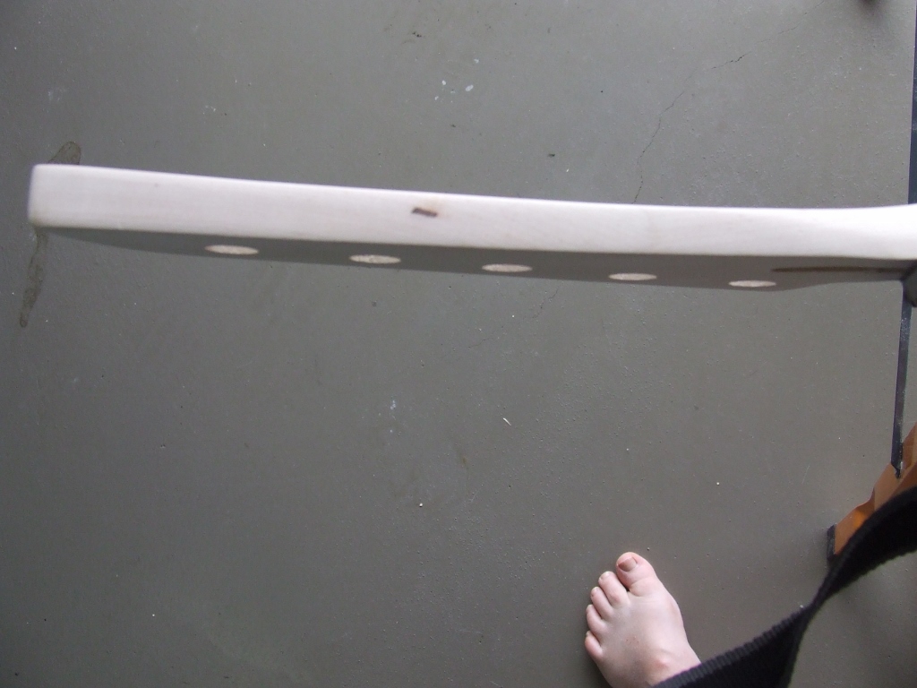

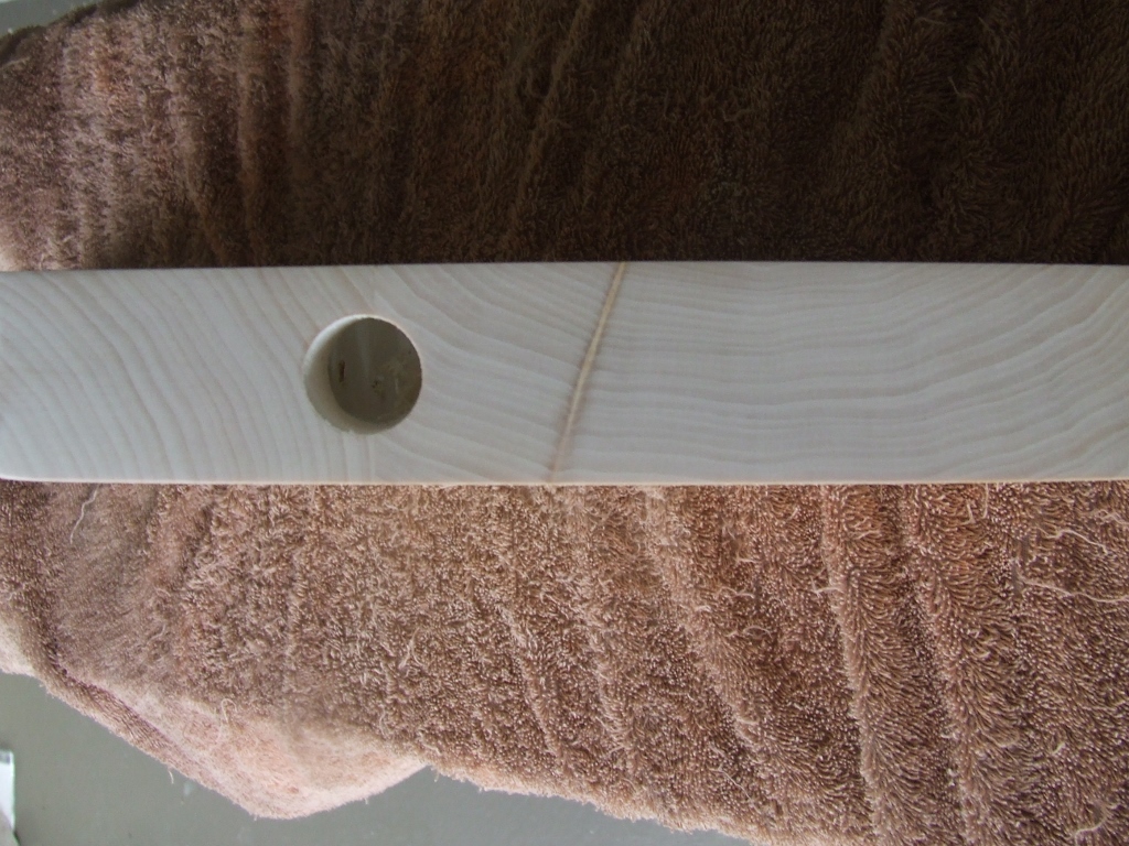

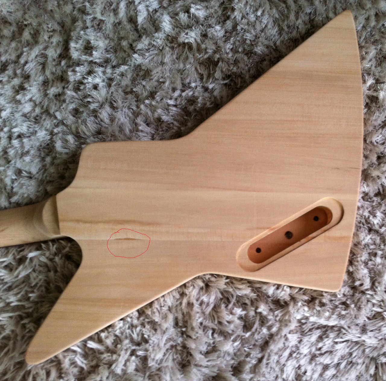

    It is not just glue spots on veneered tops but also the amount of filler they sometimes use too.
    On my 1st & 2nd explorer basswood bodies there was lots of filler that took forever to be sanded away and it stood out like dogs $#@! being a much darker colour compared to the pale blonde shade most commonly found on basswood.
    On the EX-5 filler near the neck pocket had to stay but it was a pain to get any stain to take and still showed up after multiple stain coats as nothing else could be done to hide it other than a solid paint colour.
