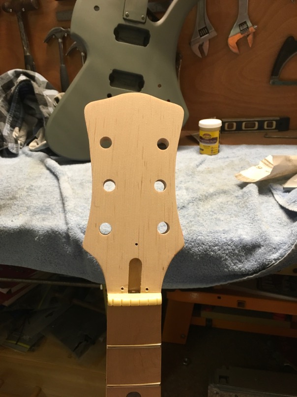

    Which headstock style have you decided on?
    As you are thinning the width of a pre-drilled headstock, I'd just double check that you don't make it so narrow that the body of whatever tuners you plan to use don't stick out over the edge.
  2. #22
    I have three kids and my middle one, Blake (5) loves hanging out with me in the shed when I'm working on this guitar.
    He is always asking when we are painting it and if he can have a turn sanding, so I asked him which headstock design he liked.
    I actually tried to steer him to the middle one but he really liked the bottom one, so that's the one we're going with
    The tuning pegs actually hit the headstock as it stands, so I measured up my two other guitars from centre of the hole to the outside edge and they were both the same distance, about 5mm narrower than this one, so I will bring the edges in (hopefully makes sense).

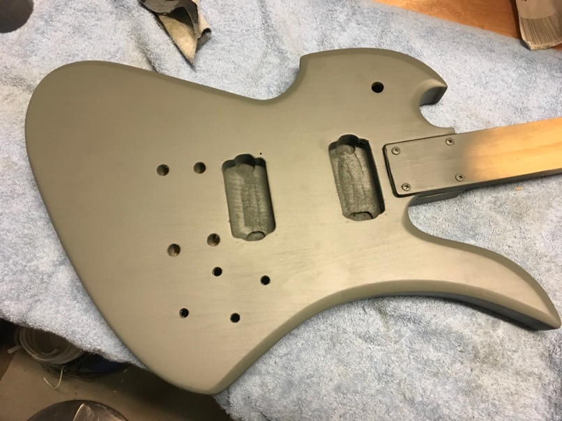

    Two coats of primer down, one to go, then on with the flat black...

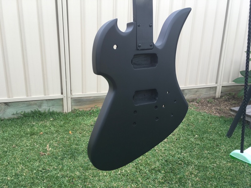

    I've been stalled a bit but got two coats of paint on it today.

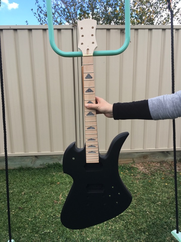

    Still tossing up on the headstock / neck finish. I think I'll do the front of the headstock the same as the body and just oil the neck and fretboard.
    Once I have the flat black on, do I need to do anything else to it? Satin clear finish? Just leave it as is?
    I'm keen to finally get the finish done so I can wire it up and give it a run...
    Thanks for your interest and help so far.
