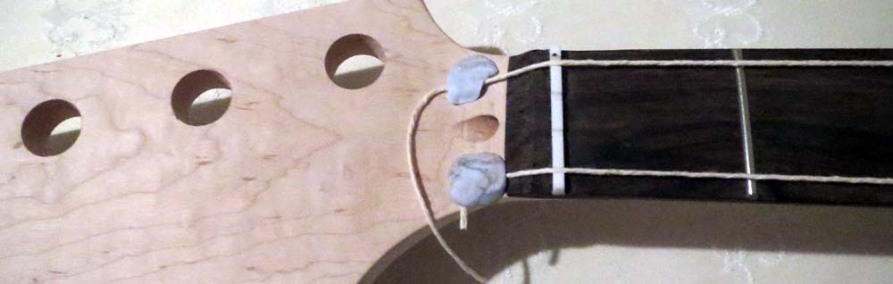

    I just used Blu-Tak to secure two lengths of the twine behind the nut:

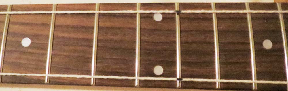

    I marked the position of the 12th fret with a Texta pen, and then doubled the twine back and marked it where it passes through the nut. (It's better if you can get someone to help with this). That way the first mark should be at exactly half the scale length, and the second should be twice that, that is, the actual required scale length:

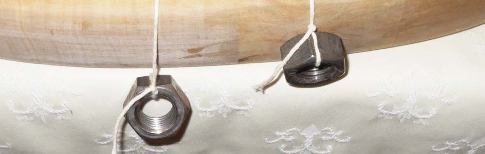

    I added some weights to the other ends of the twine so it hangs over the end of the body, keeping the twine taut:

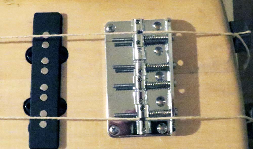

    Then it's a simple matter of dropping the lengths of twine into the relevant slots on the bridge and moving the bridge around until the twine lines up best with the outermost pickups, and the Texta marks line up with the centred adjustable bridge saddles. I'd recommend you just drill two pilot holes at first to make sure the bridge hasn't moved, and re-check the alignment before you put the rest in.

    I like your string initiative, but I'd really suggest that you move the bridge back a bit. The 12th fret to the saddle distance is always going to be slightly longer than the nut to 12th fret distance. The G string will have it's saddle furthest forward, and the D, A and E saddles should respectively each sit a bit further back. Wind the saddles forwards until you've still got about 5mm of thread showing, and then repeat your positioning exercise.
    As it stands, you may not have enough space to wind the E string back far enough for correct intonation - especially as the spring behind the saddle only compresses so far before you can't move the saddle any further. It looks like you've already drilled some holes - so you may as well try and string it and set up the intonation, but I fear you will struggle to do so.

    Hi Keith, don't underestimate the importance of intonation on a Bass as a lot of people think it only matters higher up but if the string length is wrong to begin with the out of tune phenomena kicks in much sooner and quite often before reaching the 12th fret.
    Best thing is as Simon said and to have at least 5mm thread in front of the G string saddle where it should then measure 34" from the inner side of the nut.
