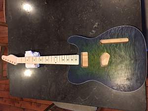

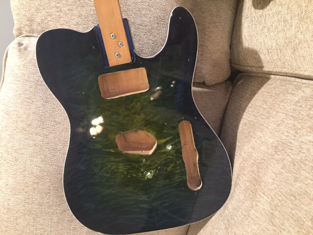

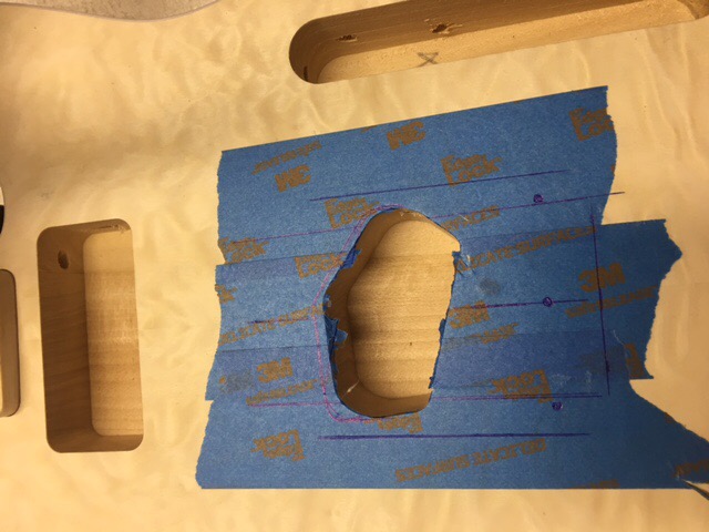

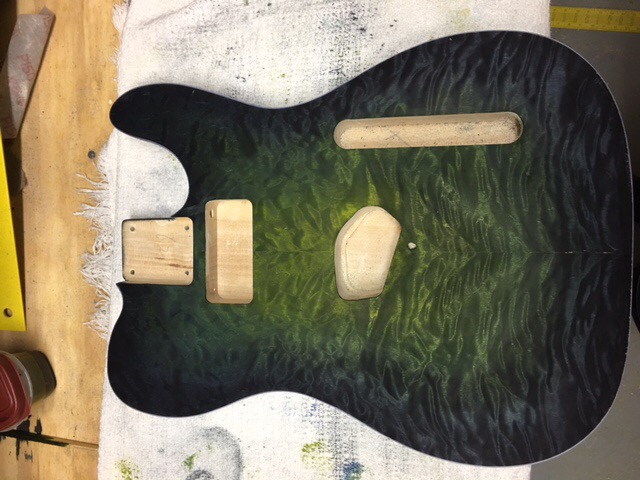

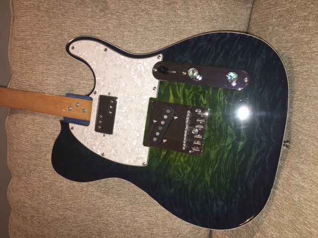

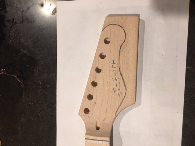

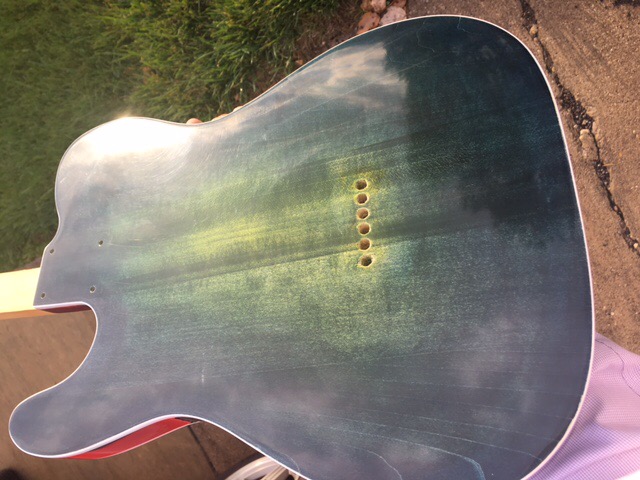

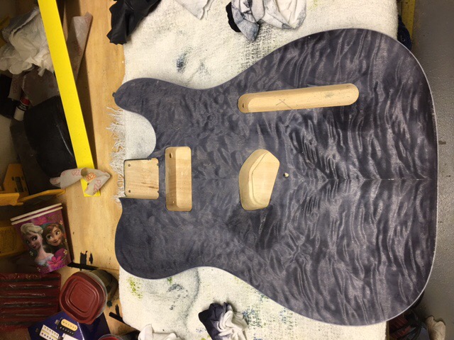

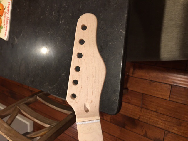

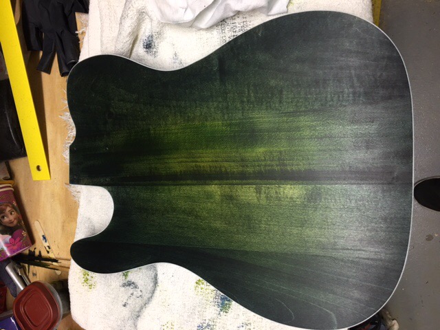

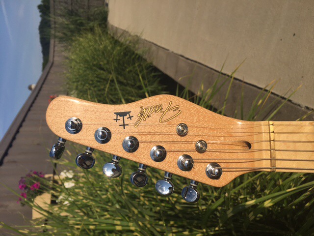

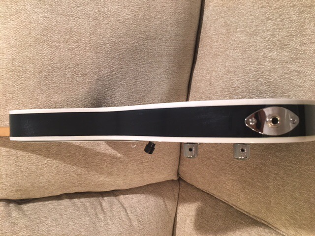

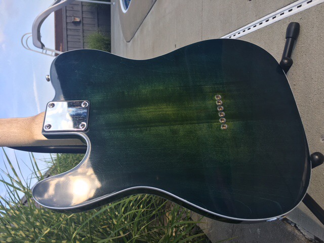

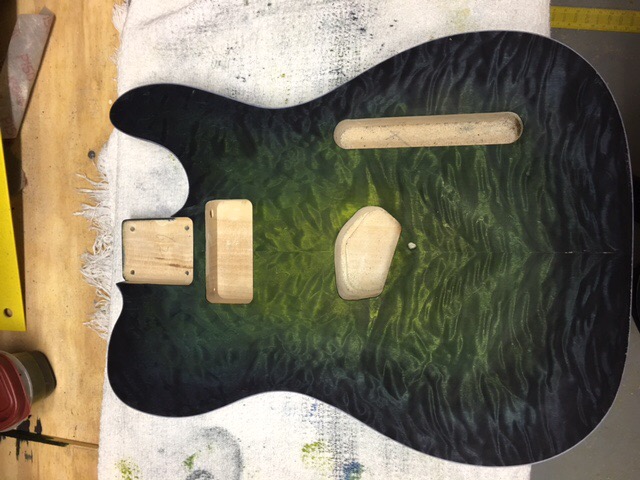

    Well I have been sick and haven't posted in a long while but here is the progress.. I completed setup and mock build to layout bridge and then sanded for what seemed like days and then my first attempt at staining using Keada water based dye. Very cheap like 16.00 usd from amazon and they worked pretty well. I have a couple small spots that I have to address and then on to clear coat. I think I am going to use nitro lacquer to really level out the finish and make it pop. I have spray equipment and some experience so I think I can pull it off. I am going to be having a friend do an inlay on headstock instead of decal... I think.. I have upgraded pickups from guitar fetish and upgraded bridge. I have some control knobs with inlays that are blu green abalone and a white pearloid pickguard coming with humbucker cut out. I did have to enlarge the bridge rout but could not quite get it deep as the original job. It is plenty deep for the pickup and not sure if I should take the time to flatten it out on bottom since it won't be seen. I cut the headstock out with a coping saw and sanded to final shape. Overall I am very pleased. Any thought?

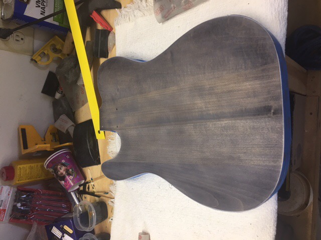

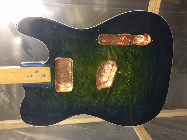

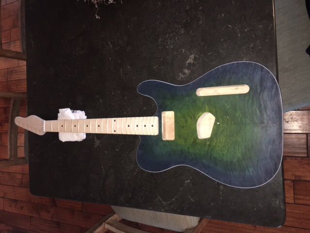

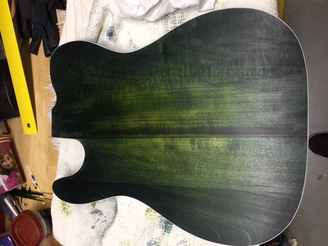

    Here are a few more pics. Sorry about the lighting the flash made it look blotchy and no flash made it look dark. The only complaint about the kit is the veneer tops are just too thin and they are not really flat there were scrapes and dings in it that cannot be sanded smooth. I grain filled to help them but you can't sand it down very well without going thru top. I wish they would just use a thicker veneer and the kits would be fantastic for the money. I am going to spray nitro lacquer so I can build it up and sand back flat and hope that it hides some of the imperfections. The Ash back and sides finished great sanding back to 400 and grain filling. I will finish scraping binding tonight and then I am going to do another mock build and shielding of the cavities and check neck and setup. Then tear it down and get ready for lacquer.. any suggestions or things I may be missing would be great..

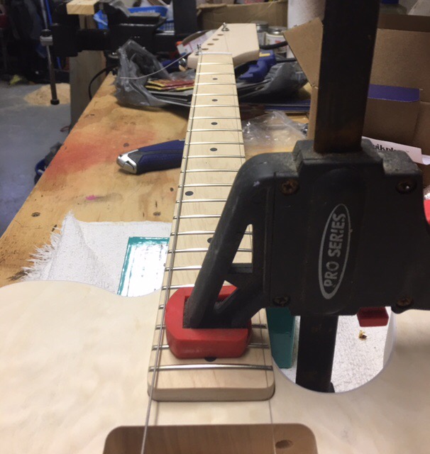

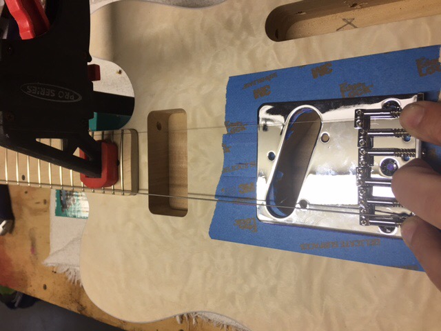

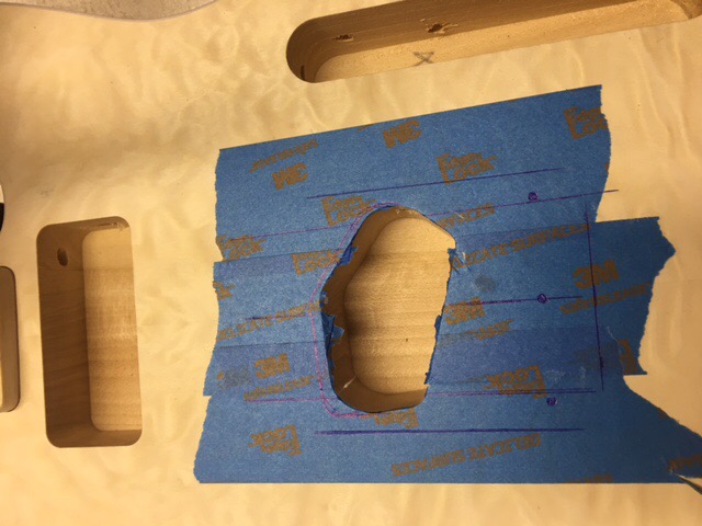

    Here are a few more pics from when I was checking scale length and marking out for bridge placement. I did realize that the factory is not very good at getting the veneer seam right down the middle of the body. I have seen several posts with that issue but I guess at this price you can't expect too much. I hope that it is not very noticeable after it is finished. Some I have seen have been pretty bad mine is just a little slanted..
