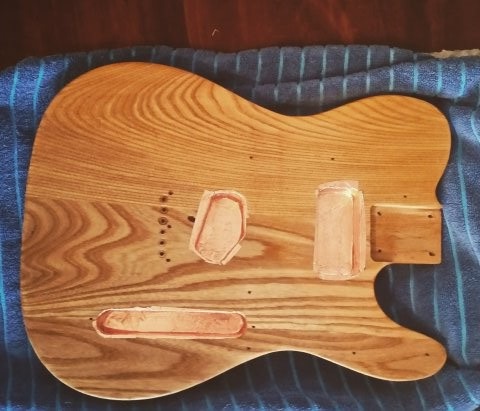

    Thanks Simon. I did do the shielding today and found my question about the copper being redundant as it had the adhesive back. Used all of it on the guitar cavities:

    You may need to cut some of that shielding back a little bit as it may stick out the sides of the cover plates. But you can easily trim it with a sharp knife or razor blade. The top and bottom of the bridge pup rout for instance, as there's often a small gap there anyway. But it will be obvious once you put the bridge and control cover on.

    Yeah I think I'll trim it back with a razor.
