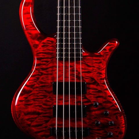

    Quilted maple...this is what I'm going for on the body:
  3. #23
    nice one Geddy, the quilt isn't very obvious in its raw state. Sure when its sanded and stained I hope it looks like the picture you posted !

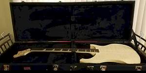

    It's my birthday...
    ...and my wife, being awesome...bought me a hard case for my project...fits great!
    Gotta protect it...it might be awesome one day!
