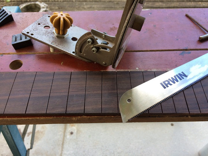

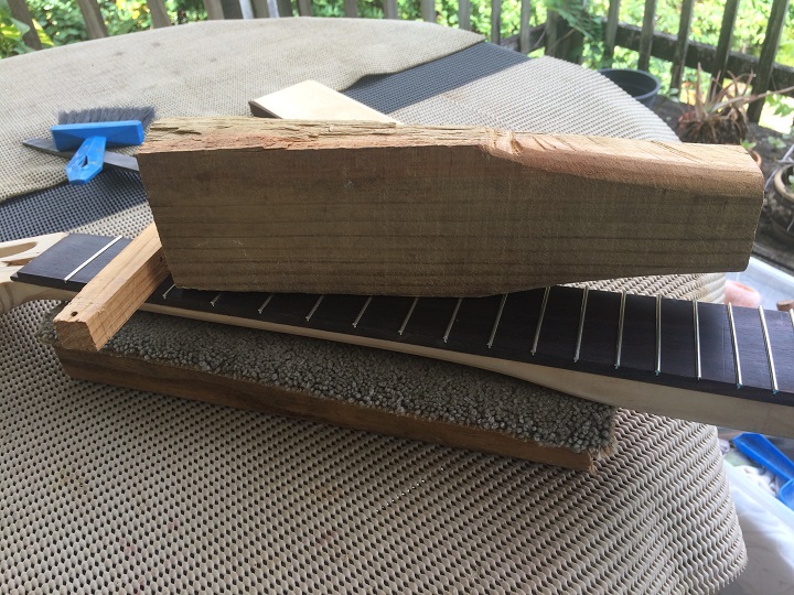

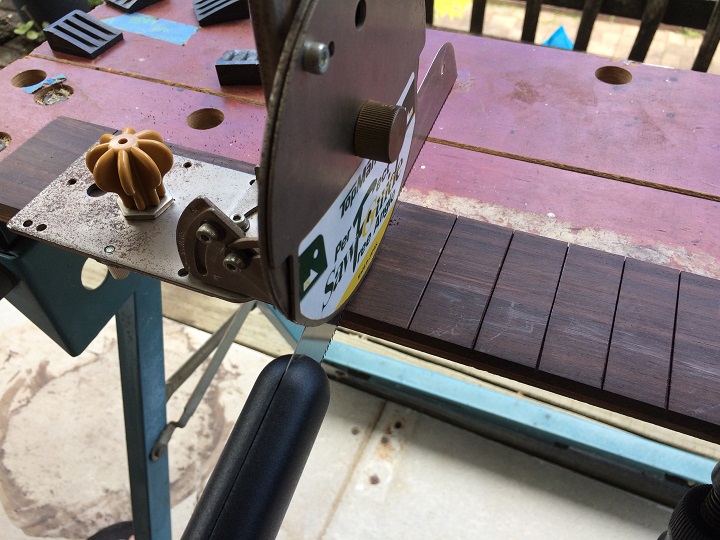

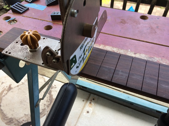

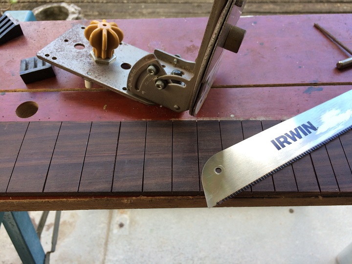

    When I left you last time I had just started to try out cutting some fret slots. The Dovetail pull saw worked OK as did the mitre contraption, to a point. But once again my skills let me down somewhat and I was a bit disappointed with the outcome. I made a few wayward cuts and I think my accuracy left a lot to be desired. After trying to measure as accurately as possible it was impossible to achieve that same level of accuracy when sawing. Once again time will tell if it was a success.

    Here are a couple of shots of the FB. The more observant among you will notice that some of the slots vary in width. That's because I could not/did not hold the mitre securely enough and it move during the sawing process. This could result in 2 things. 1. the slot will be too wide and the fret will not seat securely or 2. the fret position will be compromised and the guitar will not be in tune. Being a test bed of sorts I will find out soon enough and try to do better next time.

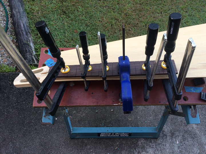

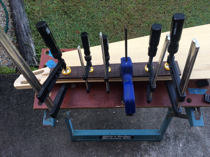

    I had no idea whether to install the frets before or after gluing the FB to the neck. But I decided to glue it first as there would be less chance of the FB developing a back bow due to the force of the frets being bashed into place.
    Also as I have no profile to help me shape the neck so I needed the FB attached to get a "feel" for the neck dimensions. So I glued the FB in place.

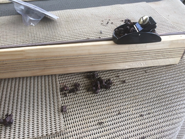

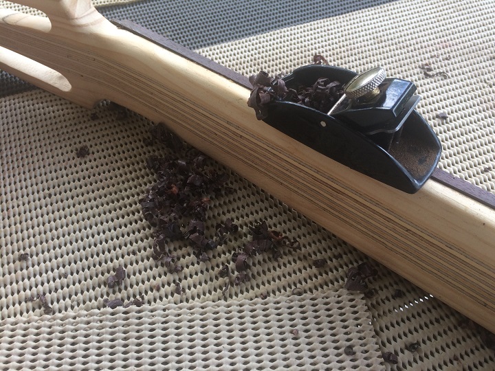

    Next step was to trim edge of the FB to match the taper of the neck. Here I used my awesome little el-cheapo plane. Not quite a thumb plane but pretty close.

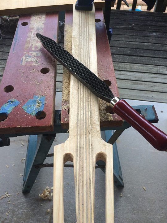

    I’ve started shaping the neck. Its still at the rough stage, but I am progressing steadily.

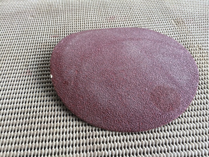

    So far I’ve used a combination of spoke shave, Shinto saw file and course sandpaper. Actually, I found that using a 60 grit sanding disk as a rather stiff sandpaper works wonders. I’ve used it on several guitars now and it is showing little signs of wear. It lasts way longer than regular 80 grit paper and is really good for the initial rough shaping.

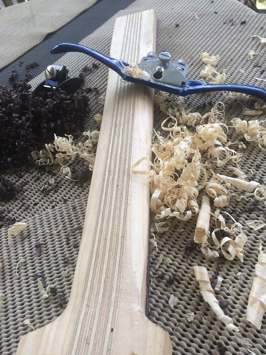

    I use the spoke shave to quickly knock off the square edges then the Shinto file to round it off a bit more then it’s into the sand paper.
ID:	18171 Spoke shave first then.....

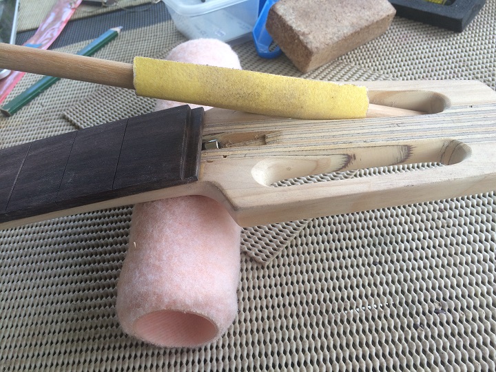

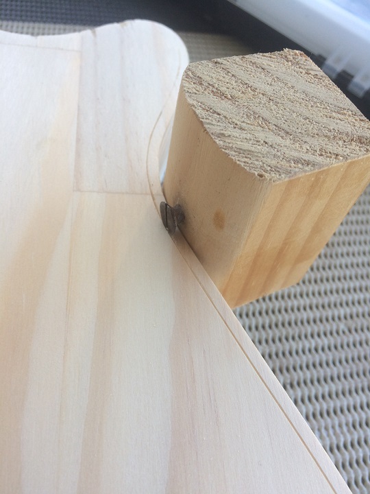

    I made a pig’s ear of the access slots for the strings and had to spend lots of time trying to make it look respectable. I used sandpaper wrapped around a thin dowel to try and even out the sides and get the right shape. I will have to bevel the ends closest to the nut to make sure that neither of the E strings fowl on the headstock. But I'll do that after I cut the nut.

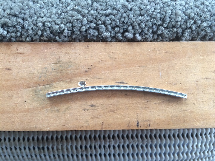

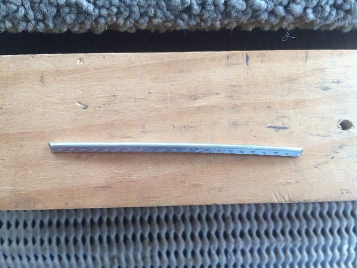

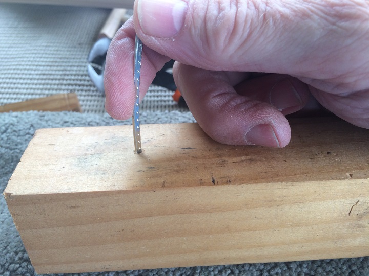

    First off I bought the fret wire in a roll and whereas most people have to put a curve in the wire I had to do the opposite and straighten it. I have no idea how this is supposed to be accomplished but all I did was drill a small hole (a little smaller that the fret wire) in a piece of scrap wood push the fret in and applied pressure with my fingers to get the fret as straight as possible. They were not perfect but it seemed to work.
    I just gradually pushed the fret wire down the hole and applied finger pressure as I went to try and straighten it.
    Before
    After. Not perfect but I think it was close enough.

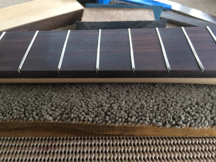

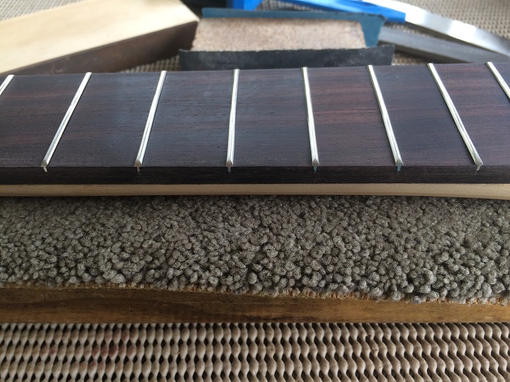

    Then came the high tech part of actually gently persuading the frets into position.
    I don't have a Deadblow Fretting Hammer or even a wooden mallet so I quickly fashioned one out of some scrap wood and used another piece of scrap wood to try and protect the fretboard and just whacked them in. Some needed more persuasion (whacking) than others but I eventually prevailed and had the frets in position.

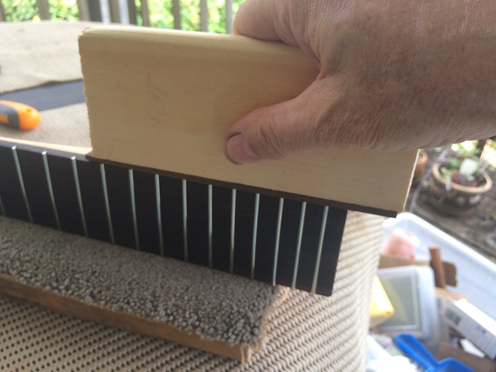

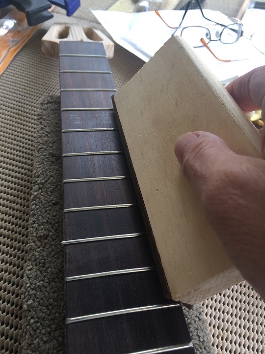

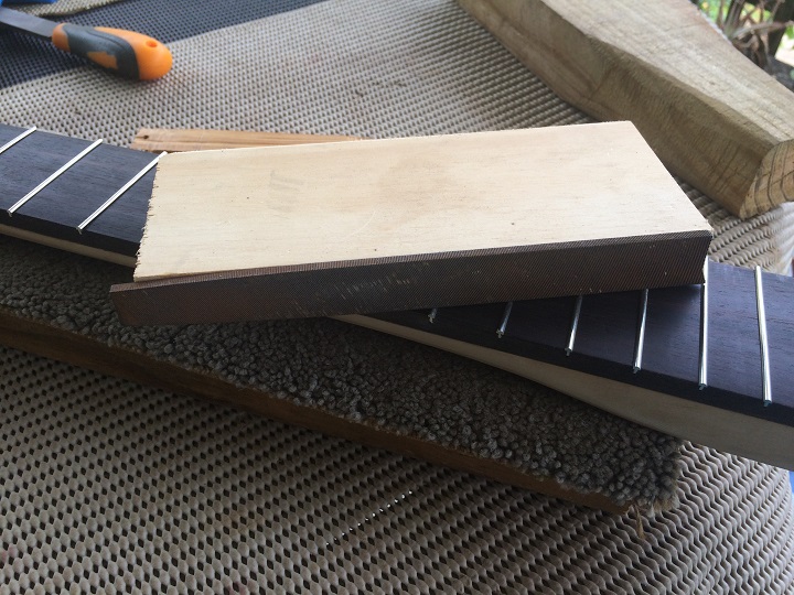

    First you find that old broken file that you’ve had lying around and have been meaning to throw for the past 10 years, then you find a piece of wood (of the scrap variety) glue the two together and voila, you have just saved yourself 90 bucks.
    Again, not pretty, but again, it does the job.
ID:	18517Click image for larger version.

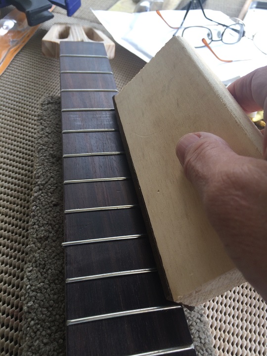

    Just run it down the side of the fretboard to smooth off all the nasty bits of overhanging fret wire.
    Then hold it at an angle and bevel off the edges.
    And yer done.
