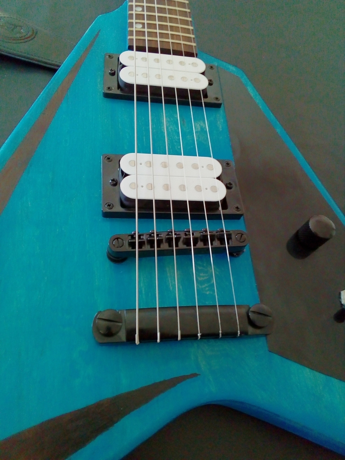

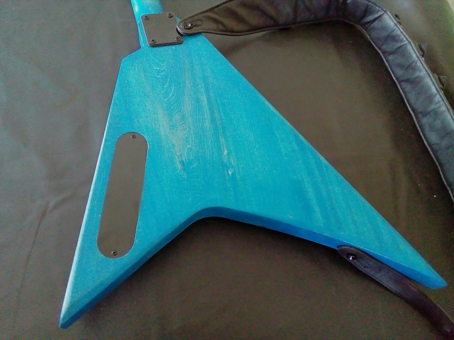

    My JK-1
    It has been a blast to complete this kit. One of the most enjoyable projects I have taken on.
    I cut a chunk off the bottom near the neck to give better fret access. I painted it with a thinned cerulean blue artist oil paint to let the grain show through a bit, carefully drew the stripes with a black marker, added a coat of linseed oil that greened the grain highlights a bit, then put a few coats of clear poly. After a light sanding it has a smooth matte finish. I got a blank sheet of adhesive pickguard material and cut it to shape. After a trial and error of the wiring, (my first wiring experience), it sounds beastly.
    - One happy customer.

  8. #27
    2,801
    Nice work HP, but bloody hell Nitro I think anyone else thinking of entering this month just curled up into a jibbering ball in the corner
  9. #28
    looks fantastic HP, love the colour. How does it sound and play ?
  10. #29
    Wow Nitro , most modded SG ive seen, nice
  11. #30
    Sweet build Hodgy, looks as beastly as it sounds - it screams Metal!!!!
