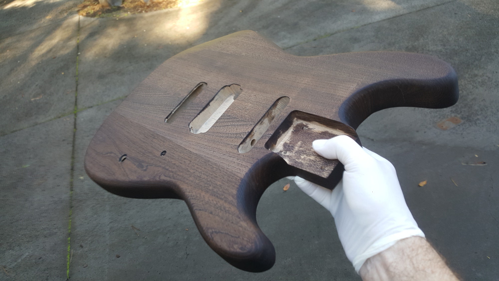

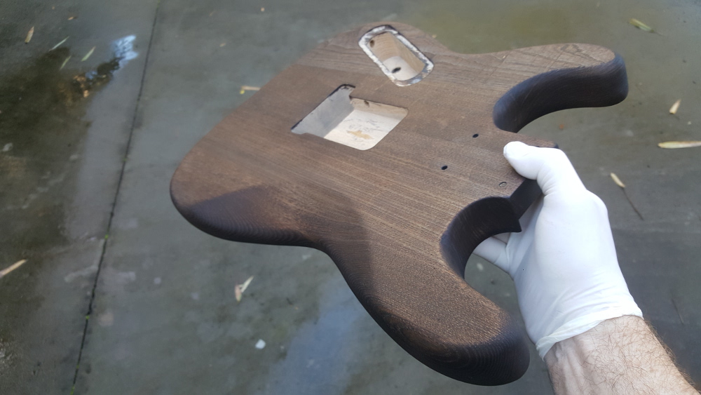

    Anyway I found an hour today while the wife walked to dog to actually get some building done in the makeshift man-cave. There's no lighting, but I've got some rubber mats and some carpet down on a temporary bench. I got the sanding done down to 360 grit, with a few water wipes to raise the grain and 400-grit cutting back. Pretty happy with the smoothness - this is a nice piece of wood! With the surface nice, and time running out (is that the patter of dog feet I hear?) I slapped on a slurry of ebony timbermate.
    I took a couple of photos, one in the dim recesses of the man-cave and one in the Holgate sunshine - w00t! It sure feels good to building something again.

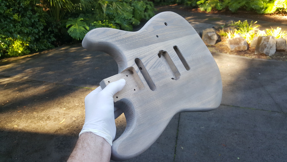

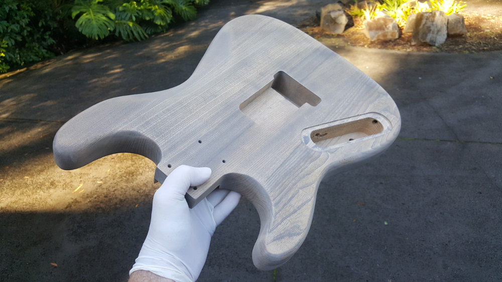

    I finally got some time to progress this beast today. The ebony Timbermate is sanded it off with 400 grit, and the body is now smooth as a baby's wossname. It might be even too smooth. We'll see!

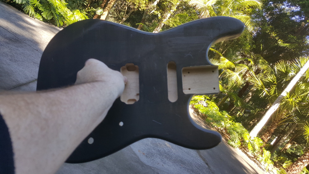

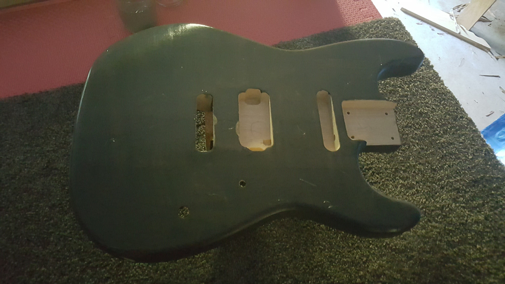

    I then got out the Colortone black dye and applied a first stain coat. I've been agonising about colour for the last fortnight, but trans black finally won out now that I've binned the natural flames idea. The stain is drying as I type and soon I'll be able to apply a second round. Starting to look good, although there's a couple of spots where the dye hasn't taken as well as I'd like. Always seems to happen with black dye (well mine anyway). Too much sanding I'll wager. I may need to hit these with a stronger soluton, or add some Colortone to the Tru-Oil when the time comes.
