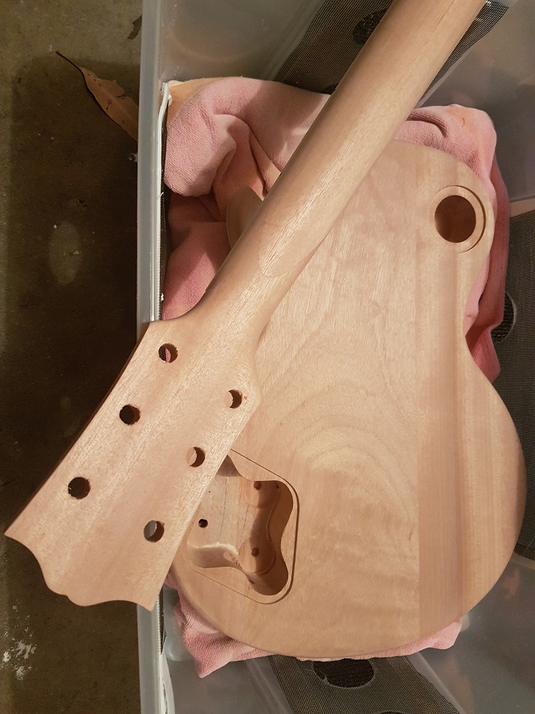

    Hi Rossco, nice kit and hopefully you can keep the animal fibres away from things when applying the finish and waiting for it to dry.
    The minute parts of the veneer near that 5c coin in the pic can be covered by loading up the clear top coats and allowing them to act as a filler.

    Hey Rossco, personally I would do a localised fill with ebony Timbermate. when you sand it back you wont take any of the veneer with you. It will look like another bit of spalt.
  5. #25
    Thanks for all the feedback guys re body and Amp.
    Been a fun weekend of sanding here. Everything back to 320 ready for the timbermate. That will probably have to wait for next weekend now as weeknight time is at a bit of a premium. Oh well no rush.

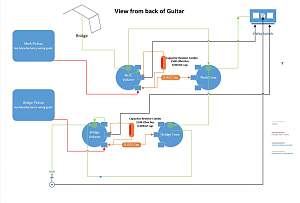

    So with the all the various wiring diagrams around the place, though the easiest way to actually understand them would be to draw one out myself. Thought I'd try the vintage style wiring first see how that goes, so planning on the following. No glaring errors that anyone can see is there?
    Cheers
