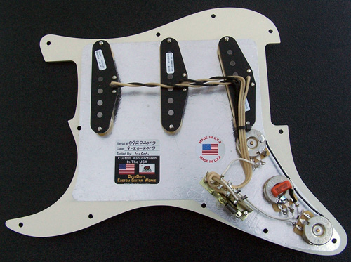

    I would say that it will be beneficial to you to screen your cavities and the underside of the scratchplate. There's a lot of cables in there to pick-up noise, plus you've got a boost circuit which will amplify any noise picked up. You may also find it beneficial to twist the pickup leads around one another and tape them together. This is how Fender used to do it to minimise noise. e.g.

    I'd also look at reducing the lengths of any cables that can be shortened. Obviously make sure first that the wiring can be routed through the path in the body. But the more wire there is, the more noise that can be picked up.

    Thanks for the tips Simon. I've already got the copper shielding tape for the cavity for whenever I can actually complete finishing the body. I'll definitely look at shortening the pickup leads and strapping them together to make it all a little neater and less noisy. The concern about boosting a noisy signal is definitely real, so hopefully the extra steps will make sure this all ends up playable in the end.

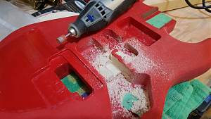

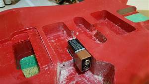

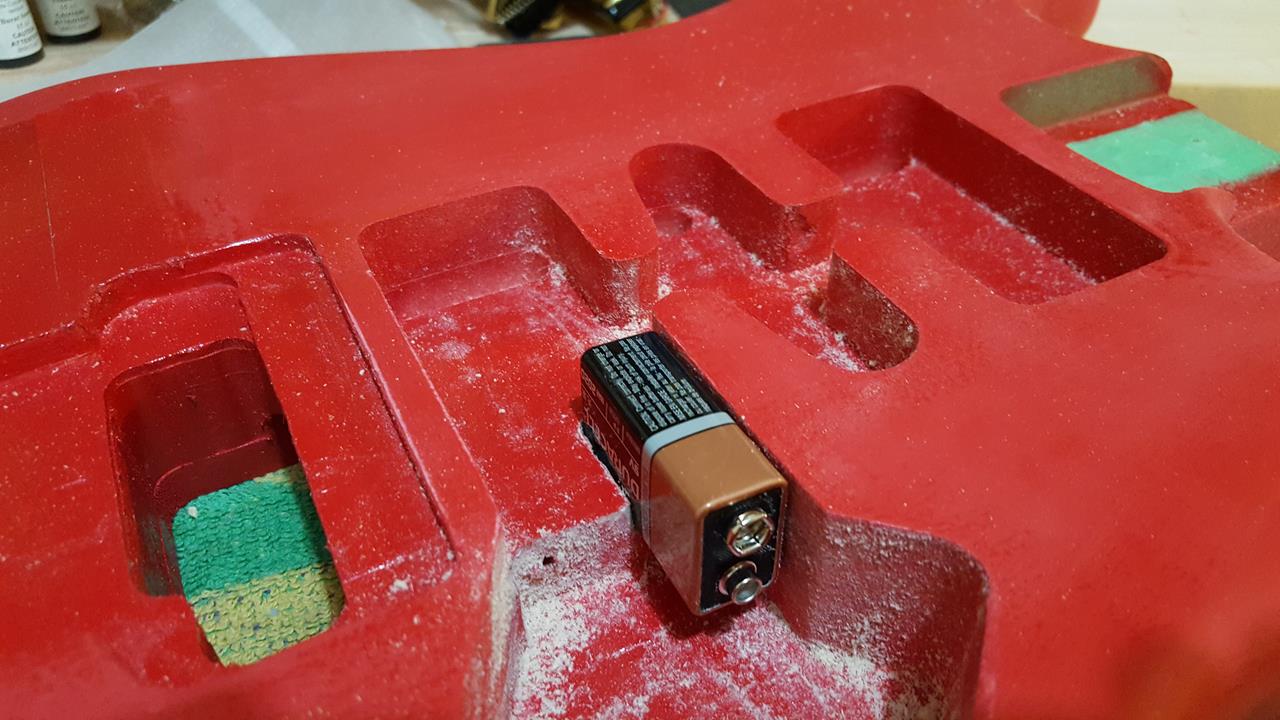

    Winter has finally ended in Canada so I can get on to finishing this off. Before I completed the colour coats I realized I should find a spot for the battery to go. It was able to tuck nicely beside the bridge pickup after some Dremel work.

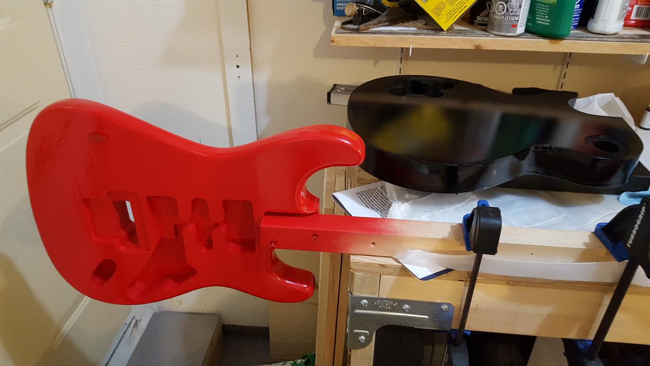

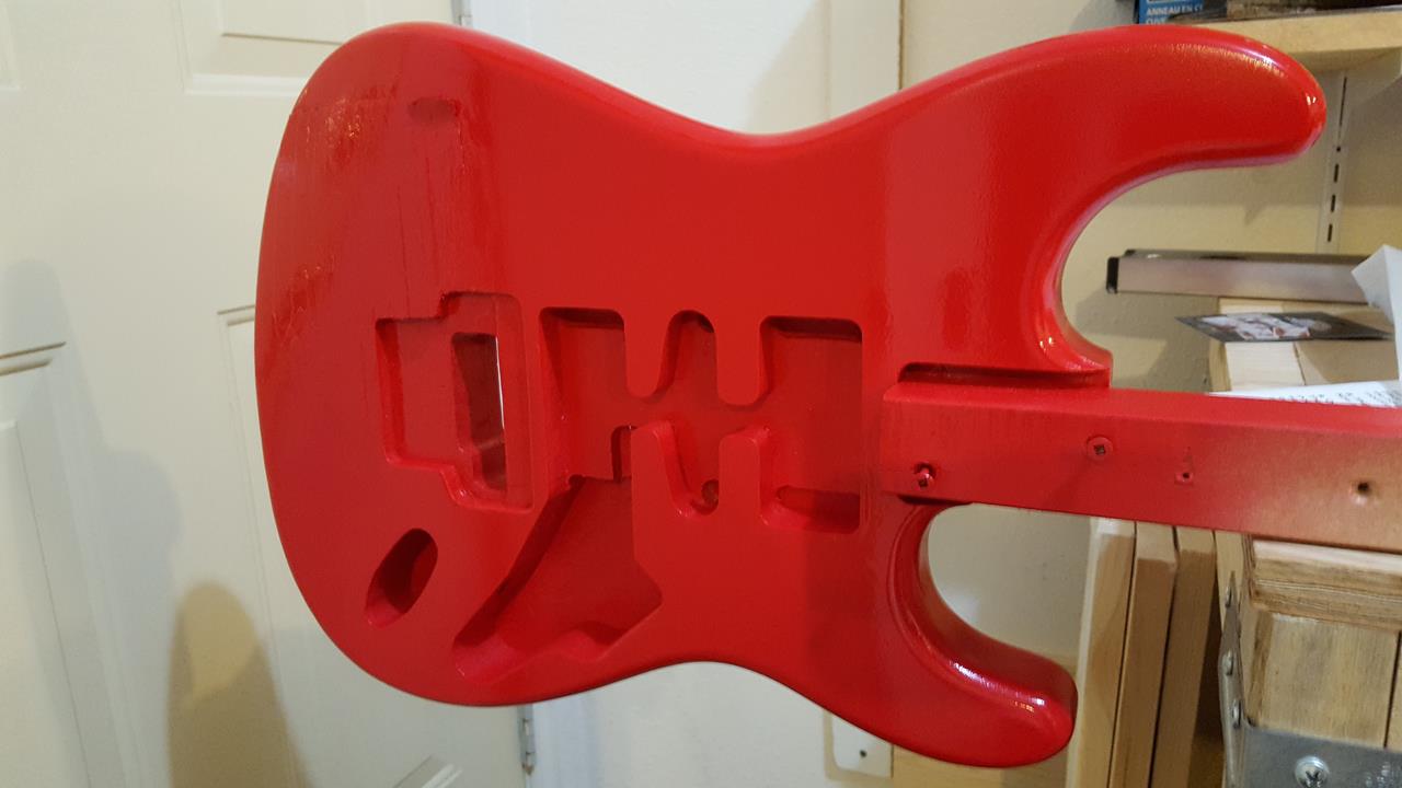

    Now that the sun is shining and the temperature is within paint manufacturer specifications I have applied what I hope is the final colour coat. I even found time to work on my other stalled project...

    Nice red, CCG. How are you planning on holding the battery in place so that it doesn't rattle around, or does the slope of the pickup wedge it in?
    Thanks Simon. The friction fit on the battery is pretty good, but I'm thinking of trying some double-face tape for backup. It's also going to be restrained somewhat by the switch but I don't want to rely on that to stop movement.

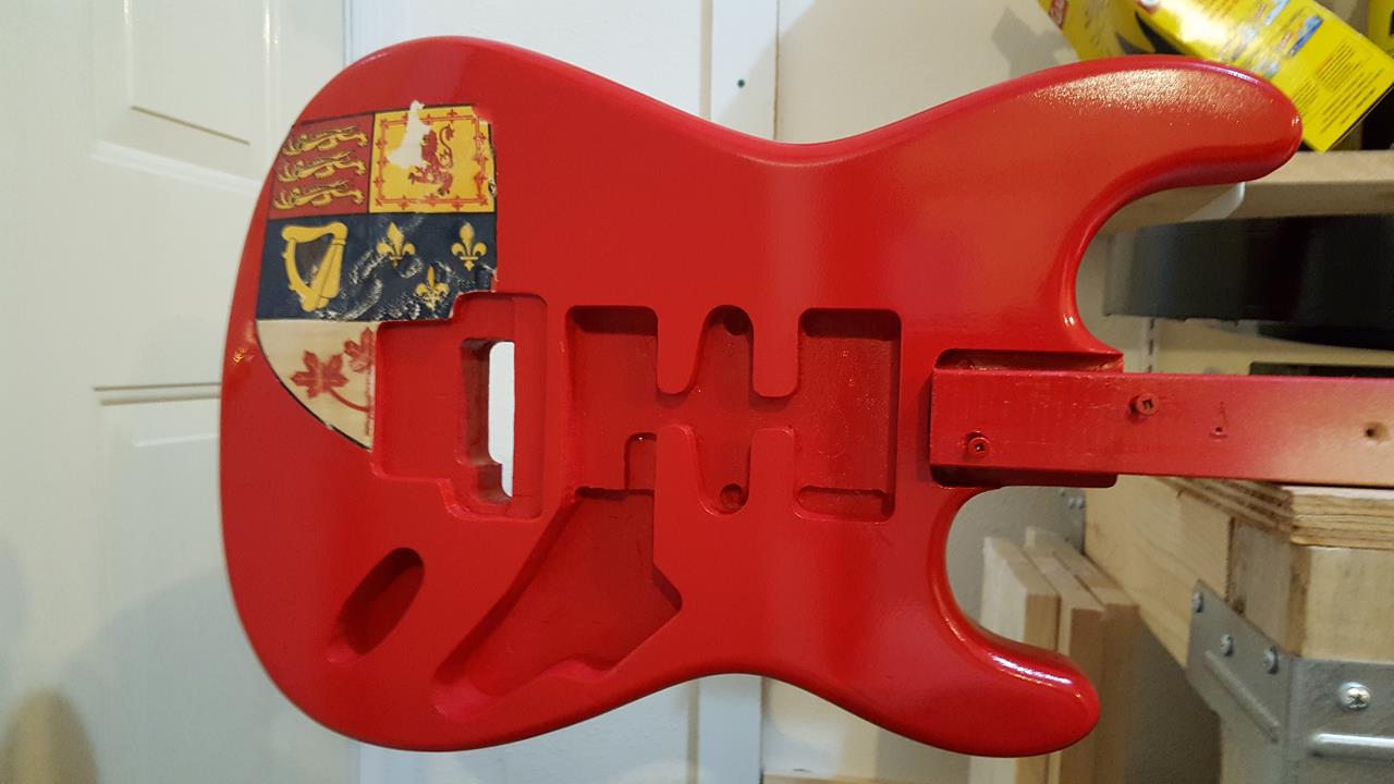

    And here it is with the masking tape pulled off of the graphic. A small portion of the graphic came off with the tape, but I think I can incorporate that into the overall aesthetic of the guitar (yes, yes, that's it, totally intentional...). Now hopefully I can get onto applying some wipe on poly next week.
