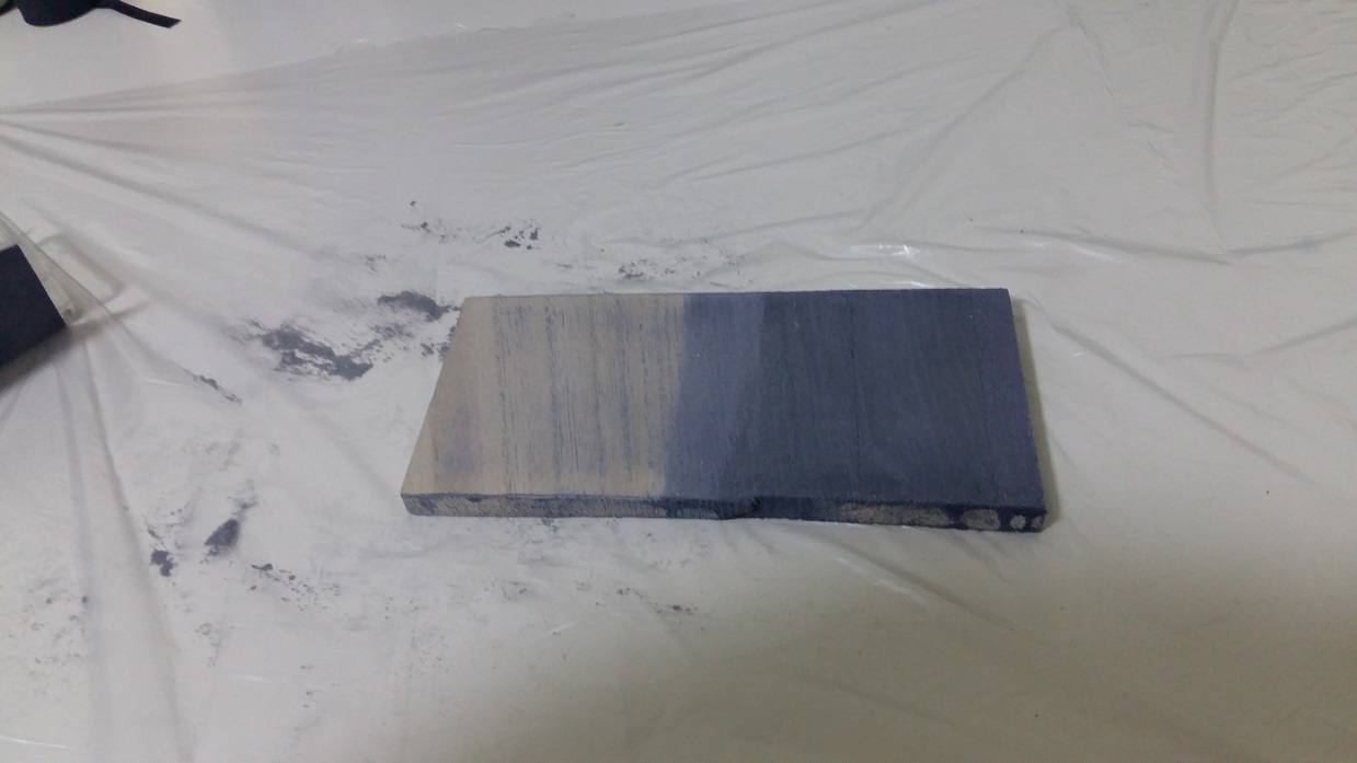

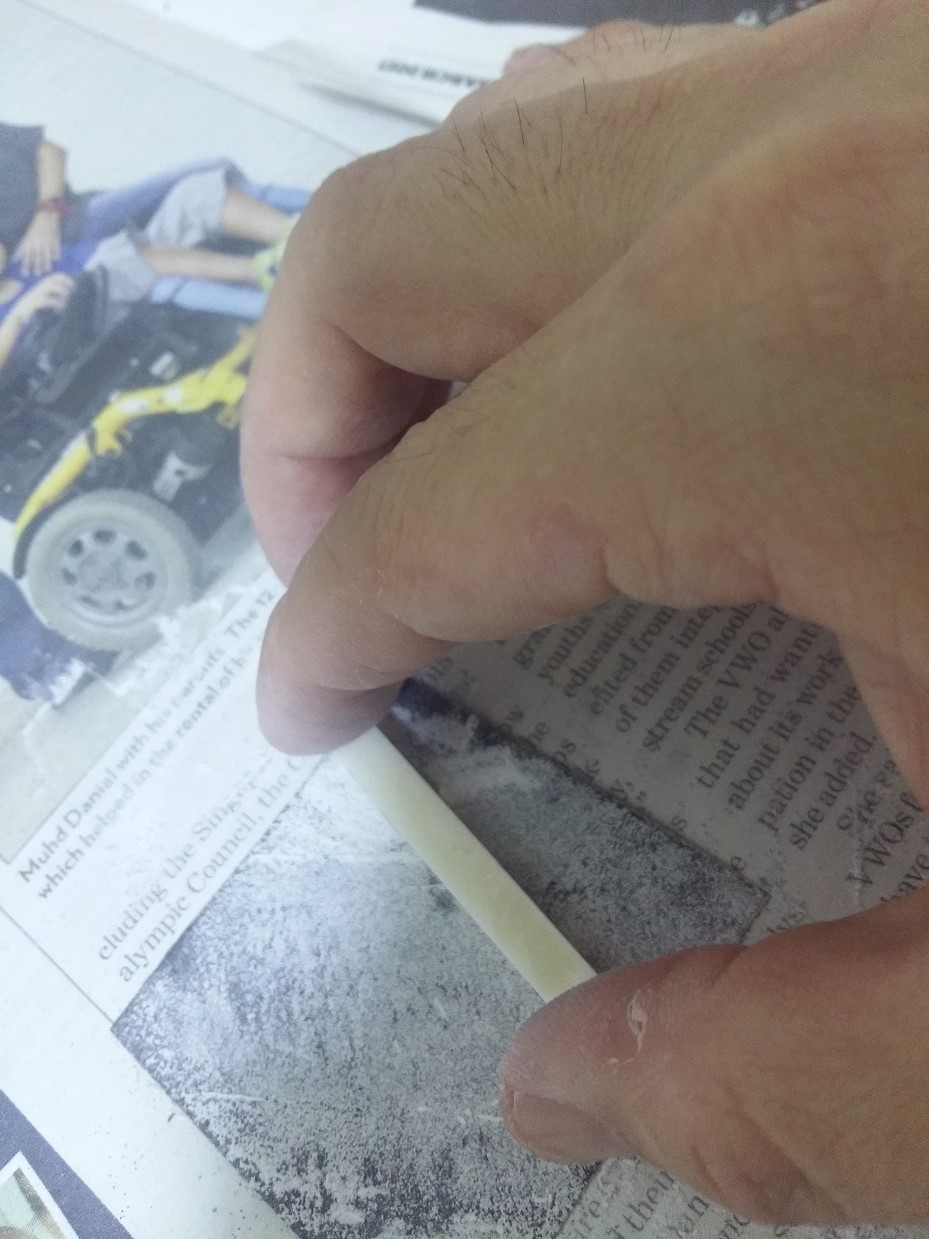

    >>Hi Waz, thanks again for your advice. Well noted with all instructions. I almost done with body sanding. so now I started a practice for Timbermate with a small wooden board as photo as below. It was so much dust as you said. i will soon to buy disposal globes, mask and goggle, before proceeding to filling grain.
    >>Hi Simon, just for update. I have checked a back of sanding paper and found there was no P before numbers, so i assume they are ANSI or CAMI USA standard! they are made in japan or china.

    Hi Toshi, the timbermate dust in that photo looks similar to black talcum powder as that is how fine it can get. Extremely messy but the effect is worth the small amount of inconvenience.
    Cheers, Waz

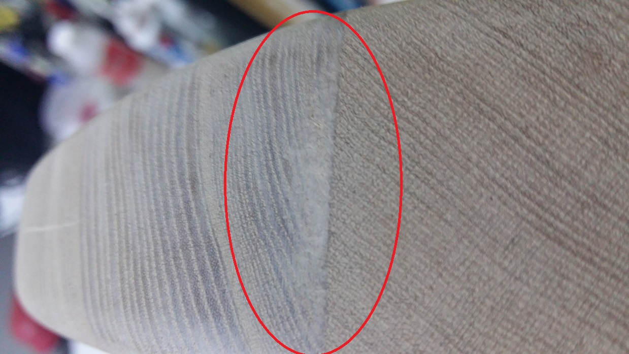

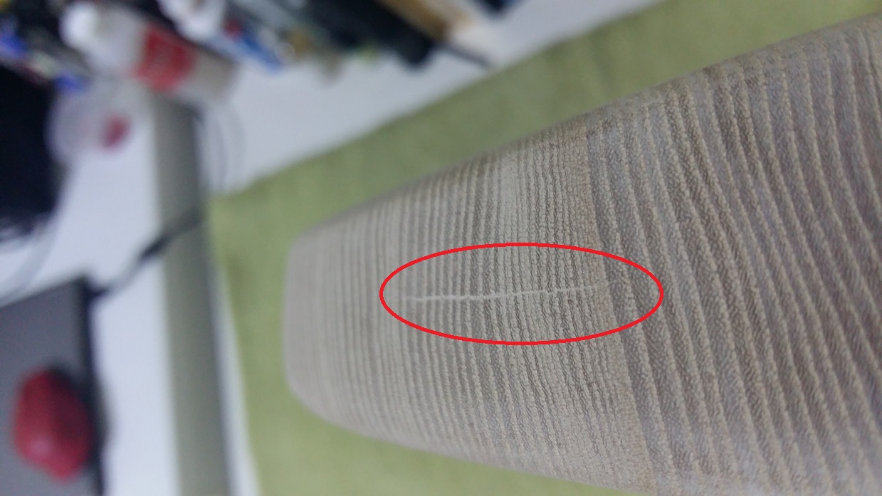

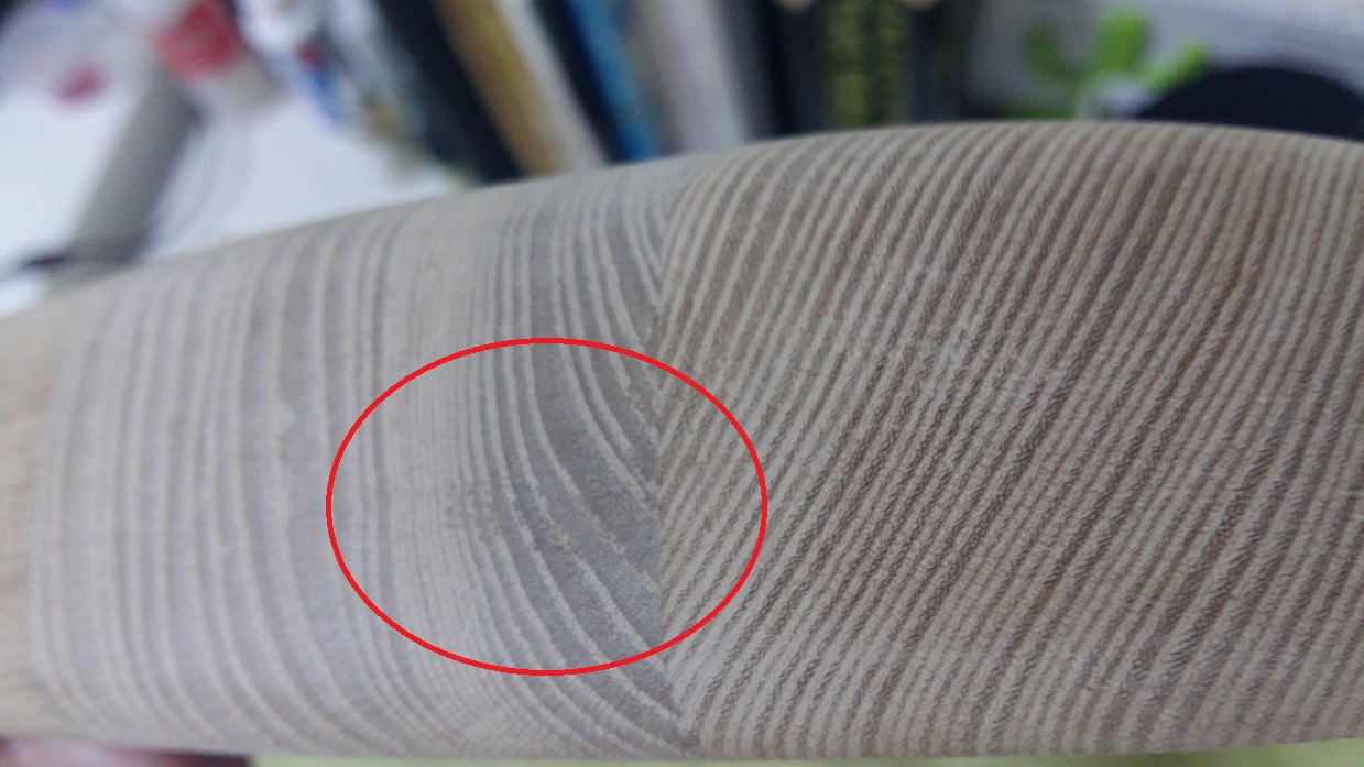

    I sanded out body with #240 several times and now thinking going to fill out grain, but found some scratch and glue spot at bottom of body as below. would i be better to remove those spots completely or can go for filler process?

  8. #28
    Hi Toshi, sanding process coming along well. I'd try and sand out the machine marks on the bottom edge before the grain filling. It's a bit difficult but try and sand along the grain. I usually sand each piece of the ash (to the edge of each glued piece of the body) one at a time so you concentrate sanding with the grain. Be best to probably go back to 120 or 180 grit for these areas, then over again with 240 grit then you should be ok to grain fill.

    Hi Toshi, Woks has provided you with some good advice.
    Photo 1 - that horizontal scratch will only come out after sanding at 90 degrees to the scratch and thus following the grain pattern, and coarser grit will be required. Once the scratch is gone you can the switch back to sanding across the end grain, but only after all obvious machine marks and scratches are completely gone.
    Photo 2 - looks like some filler in a low lying part of the edge where those planks have been joined. I would sand in a diagonal direction from bottom right hand side of that shot, again following the grain pattern.
    Photo 3 - this has two different grain patterns converging around what looks like a small amount of glue or filler. Same sanding process as above 2 points.
    The end grains will most likely come up highly polished after sanding and not take much timber mate which is not such a bad thing as that grain will still be visible through a translucent finish. Where timber mate does most of it's magic is on the front & back and be careful not to over sand and end up polishing those faces too much.
