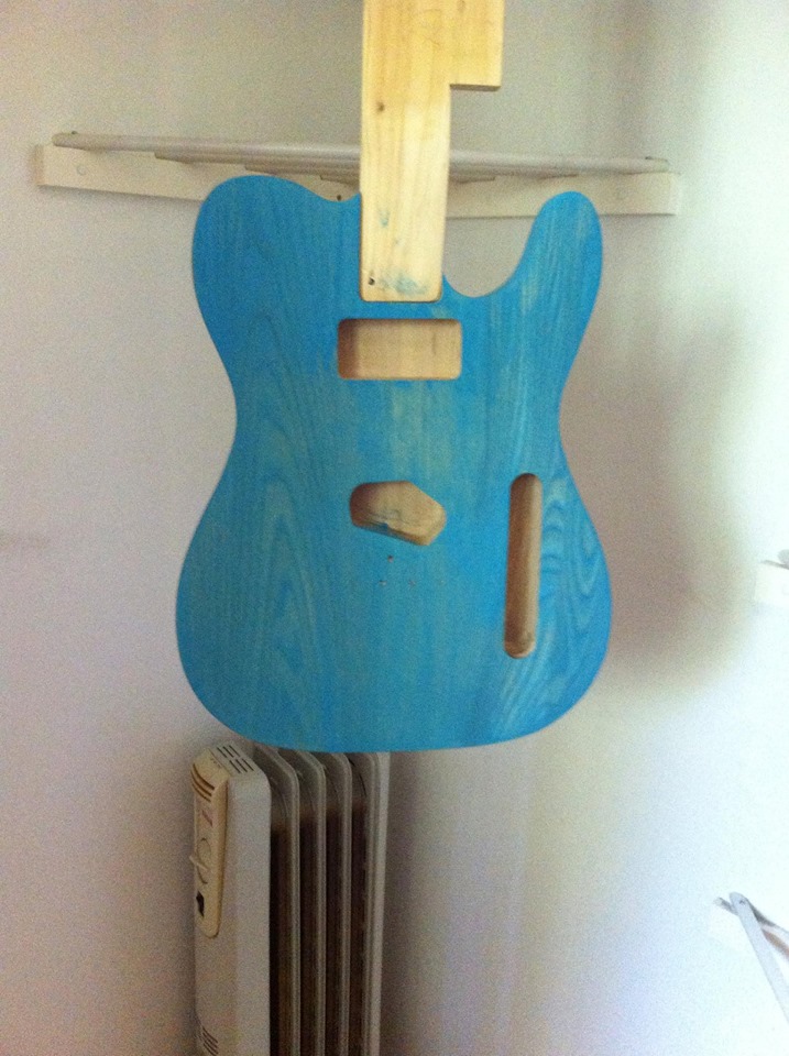

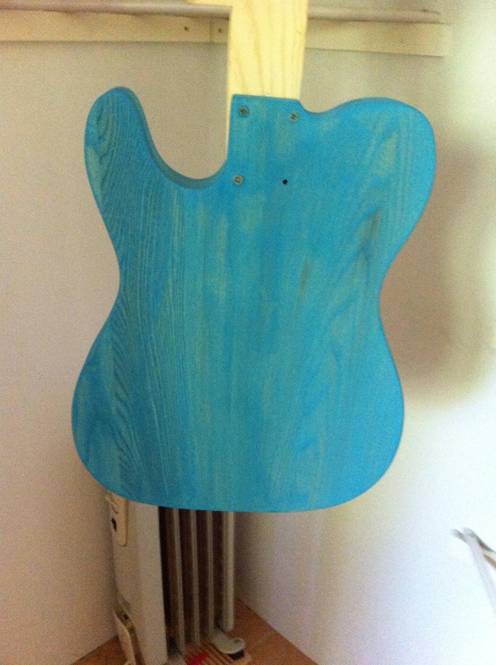

    First coat of woodwash went on this morning. Ended up wiping on with a cloth rather than brushing on. I'm really happy with how it went on - the colour is spot on for what I wanted (actually more turquoise than it looks in the photo) whilst still really highlighting the grain. 2nd coat will hopefully solidify the colour a bit more but keep the grain nicely, then on to clear coat. Intending to get onto headstock shaping this afternoon.

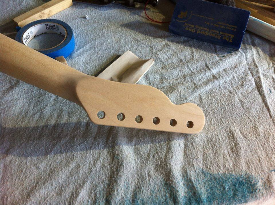

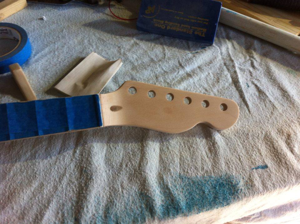

    Headstock shaping done (went classic tele-style). Cut roughly with jigsaw and then sanded to shape. Pretty happy with overall result.

    Have sanded the neck which is feeling pretty nice, but just wondering what do I do for the actual fingerboard itself? I've given it a once-over with steel wool as it was feeling pretty rough (not sure if this was a good idea). But what's the actual process for preparing the fingerboard?

    Great job on the headstock Moo.
    With a maple fret board steel wool sanding whilst polishing up the frets will work. What did you have in mind for the finish? Were you going to cover it with a clear coat of something or just hit with lemon oil or wax?

    Looking great Moo, both the body colour and the headstock! What are you going to use as a top-coat? Make sure it's clear. I used Tru-Oil over a similar colour and it turned it green. You don't want to change that colour at all!!
  8. #28
    Thanks Gavin! I'm pretty happy with how it's progressing. For the top coat I'm using a clear coat by the same company who make the woodwash I used. I think it's called Porter's... I basically just went into the local paint shop and asked for advice and they set me up really well. I've got a gloss coat for the body and satin for the neck Just trying to sort out headstock decals and fingerboard finish etc. before I apply clear coat. Also have to wait for new pickguard to arrive
