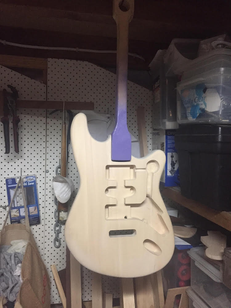

    Bit of progress in the past couple of days... final body shaping was completed, then the normal procedure: sanded with 80, 120, 240, 400, wiped down with damp cloth, 400 sand again, wiped down with a timbermate slurry, then sanded with 400 again. I then vacuumed the body to get rid of all the dust and wiped it down with a clean cloth. Final step was attaching my "painting stick", so if the wind dies down a bit later I'll do the first primer coat.
Name:	130117 body ready for painting.jpg
    I also finished off the pickguard as it will be following the next few painting steps alongside the body. I first finished drilling all the relevant holes, sanded with 240 and 400, wiped down with damp cloth, 400 sand again, wiped down with a timbermate slurry (probably didnt need to do the timbermate but figured why not!), then sanded with 400 again.
    I'm really looking forward to the painting stage with this one so very happy to get to that point...
