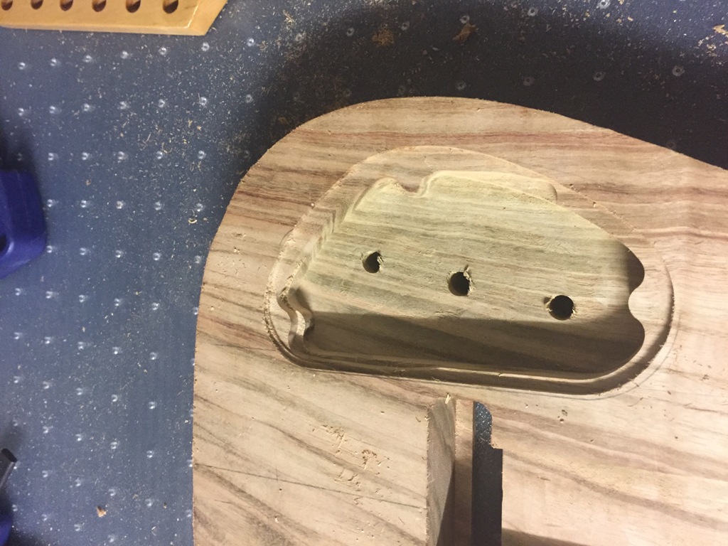

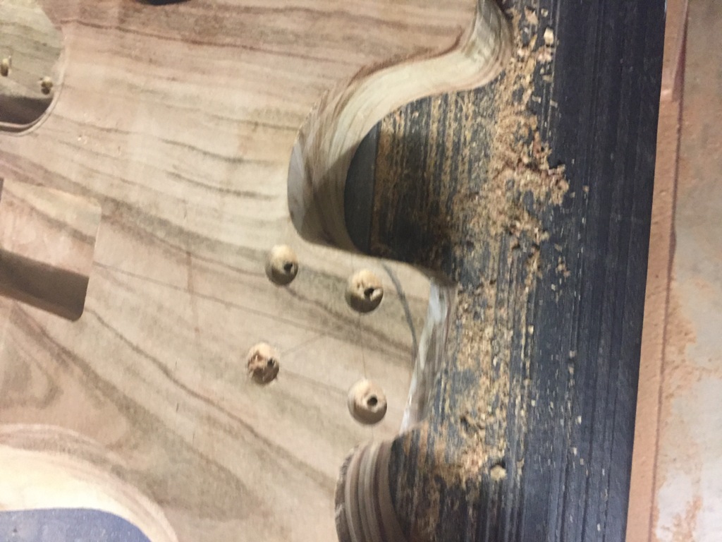

    So did some more on the scratchie.
    Routed the control cavity out, and had a few "learnings" in the process. Using template tape to hold in place and didnt realise that the template was slowly sliding on the body, in part being too heavy handed and not letting the bit do the work and the tape not so good with humidity. (Mainly heavy handed)
    Managed to rectify but now is a little off centre from original plan.
    Filed down the body for belly cut and arm taper. before a full day of sanding.( So over sanding)
ID:	15962   Click image for larger version.
ID:	15963   Click image for larger version.
ID:	15964   Click image for larger version.

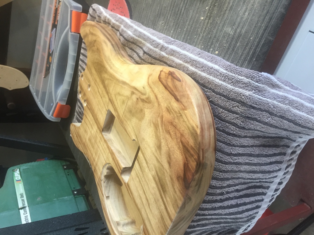

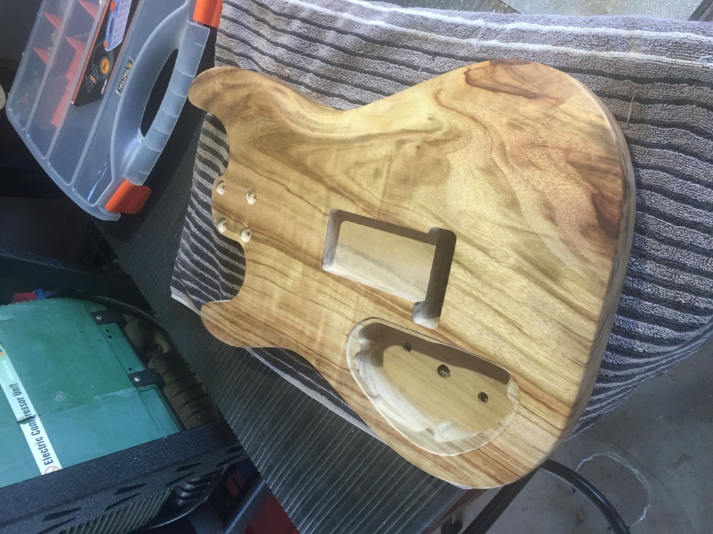

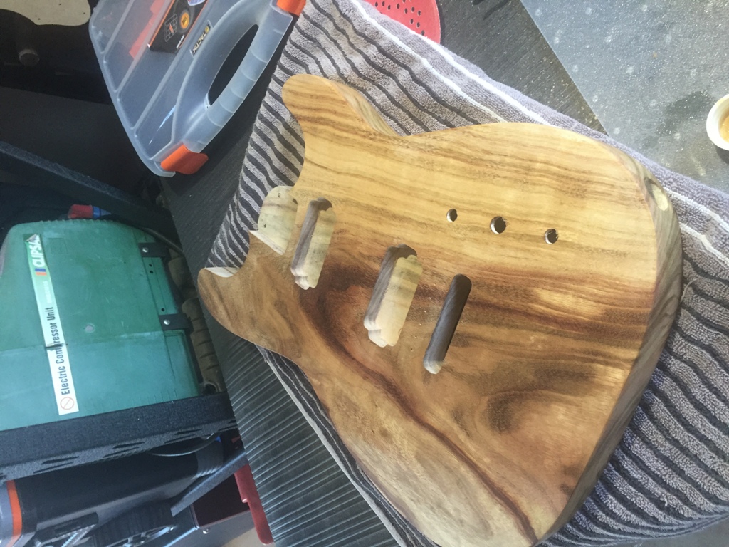

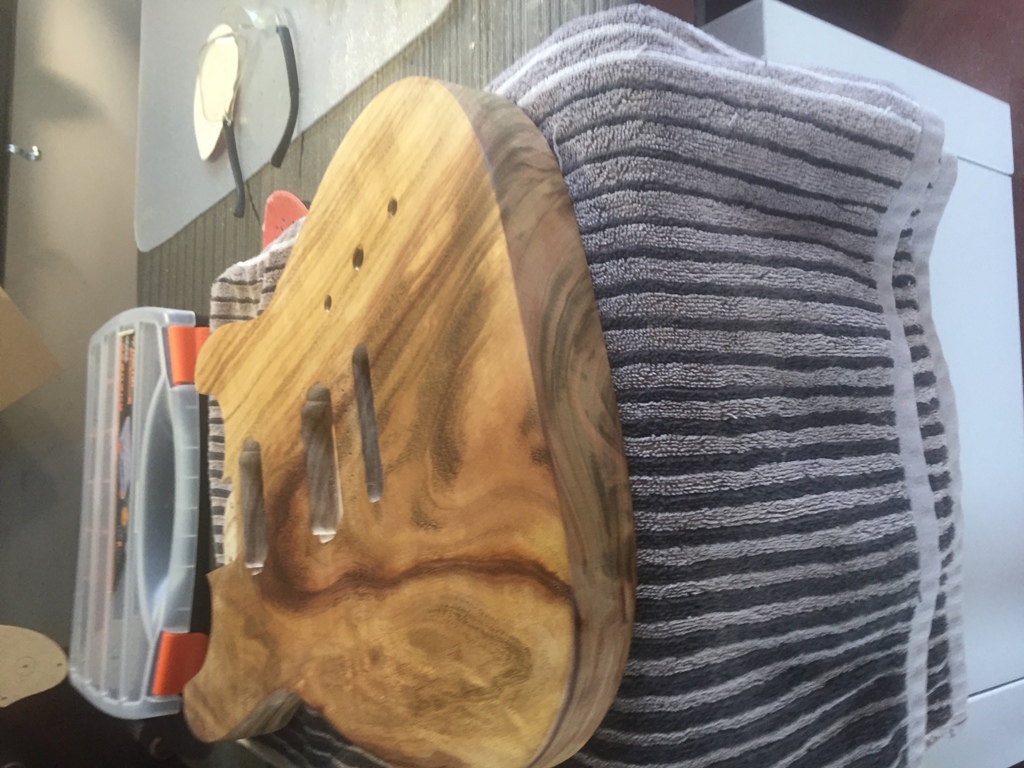

    Once finished sanding applied a thin coat of TO.
