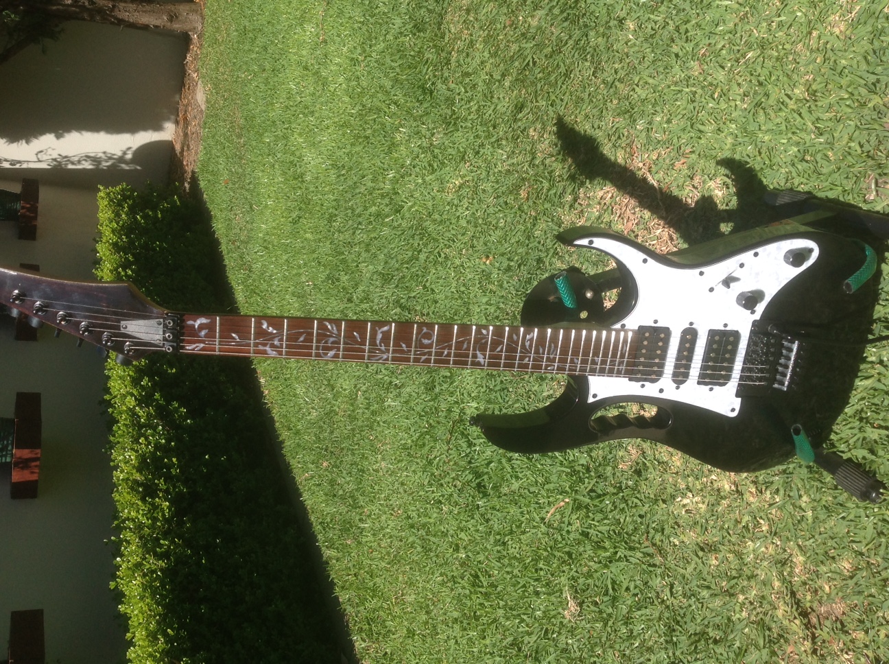

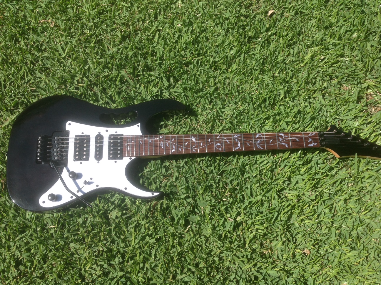

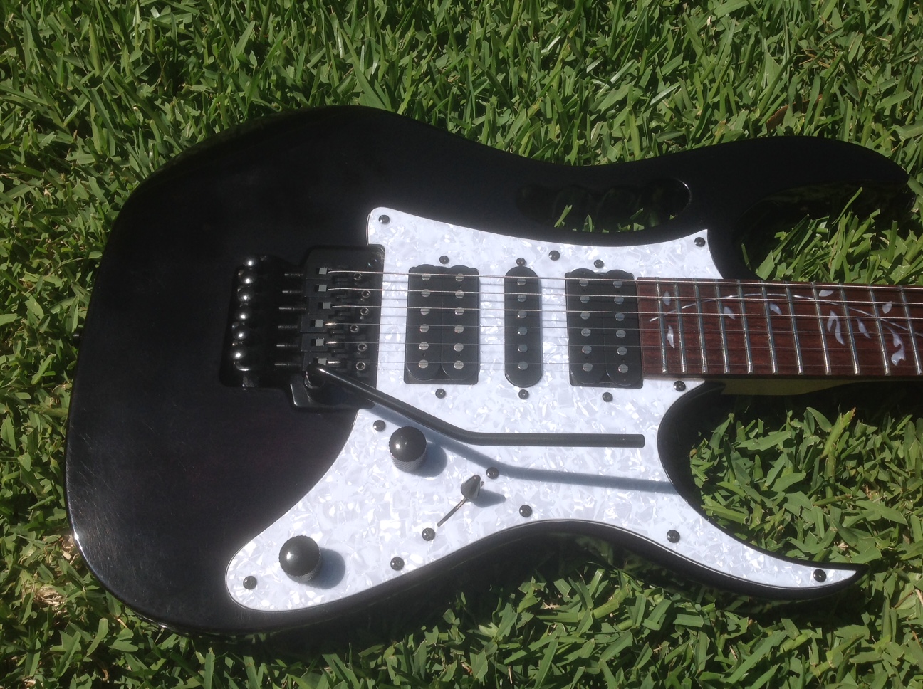

    Mentor Andyxlh's Avatar
    1,206

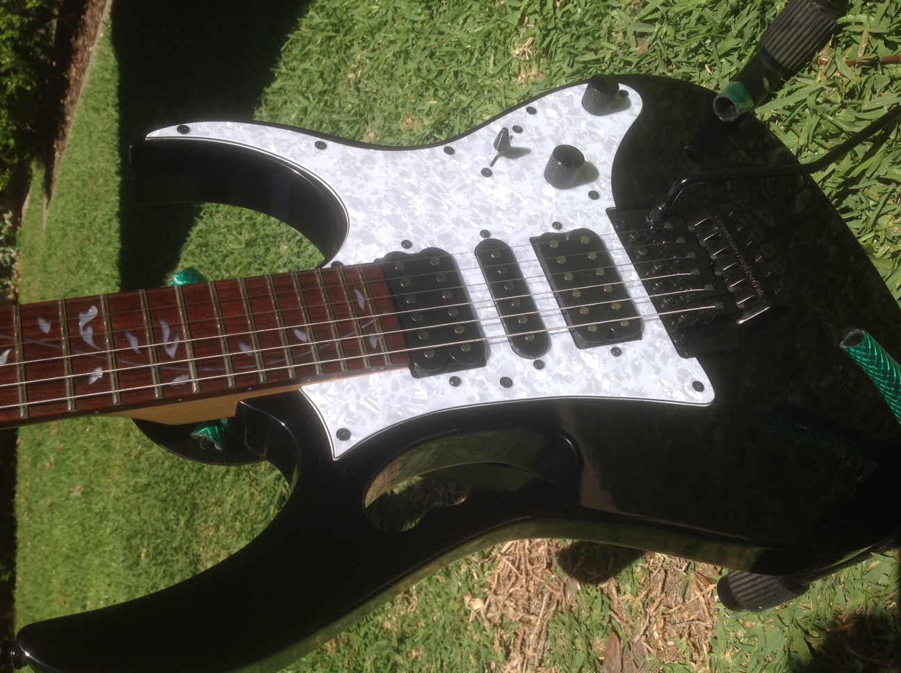

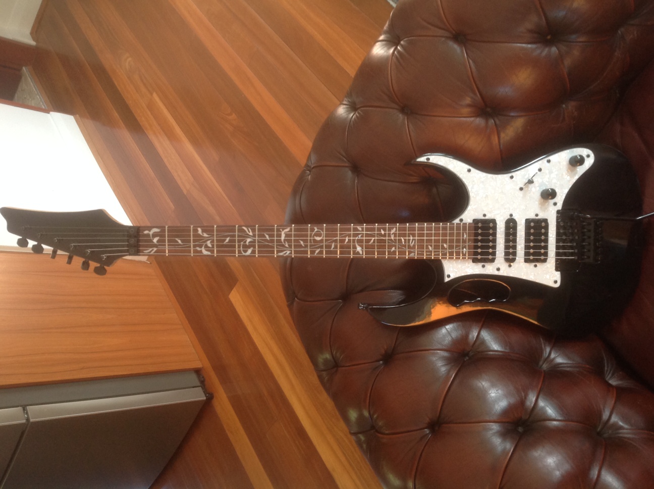

    Here we go, the finish is Feast Watson black stain with polyurethane clear over the top. In the light you can catch the grain through it, and and it keeps the finish nice and thin compared with a heap of black paint 😊

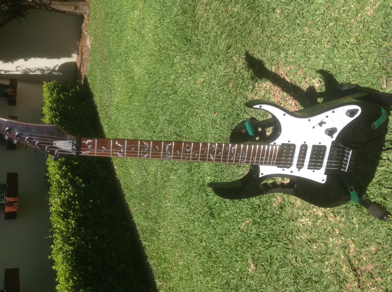

    And one more for luck as it is a nice day...

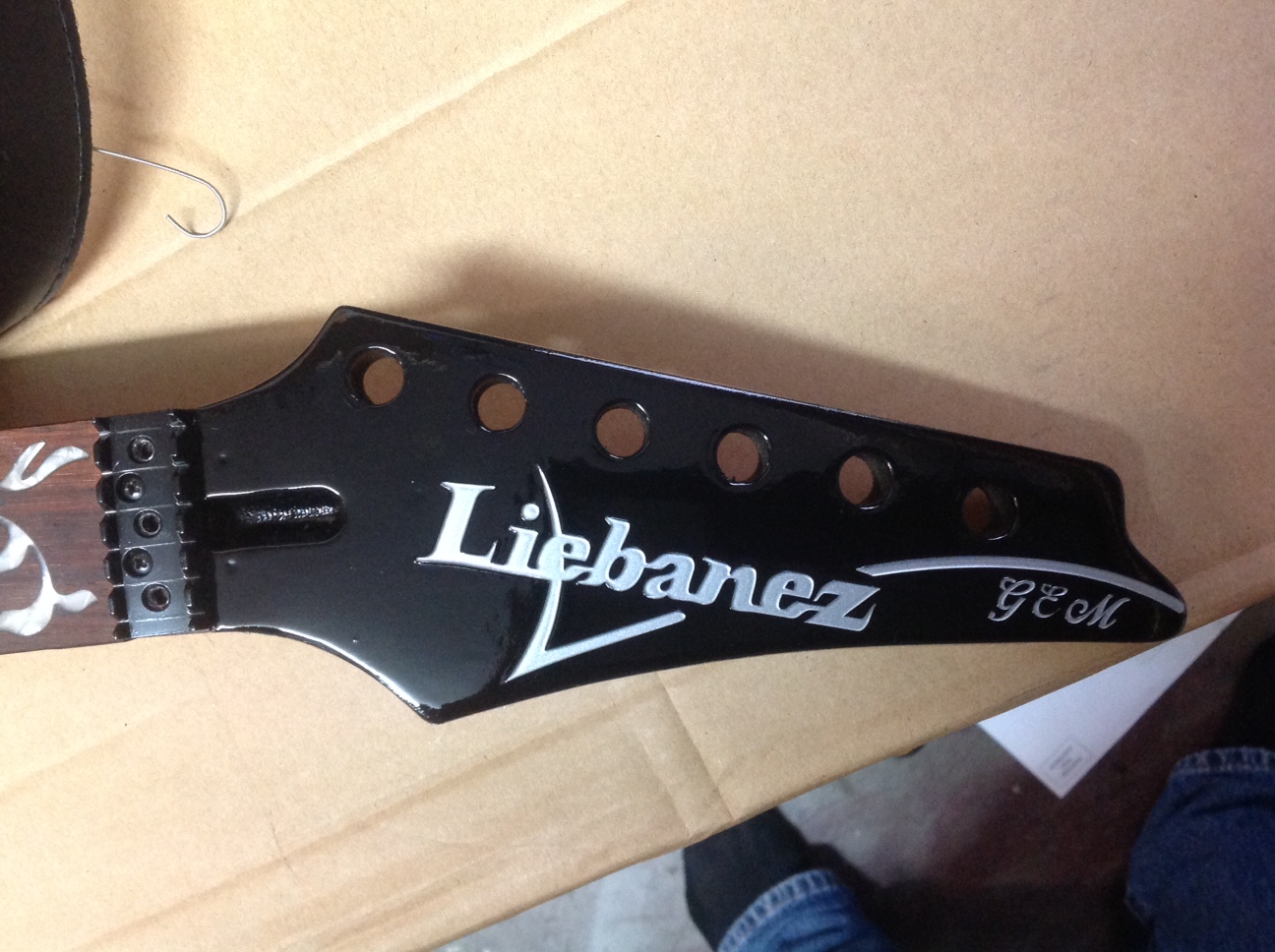

    I decided that it needed a headstock decal... this was the best idea I could come up with!
    Just sprayed the clear over it, I have used a poly clear which has lifted the vinyl decal at the edges very slightly. I think it actually looks great! I'll need to flat back the clear in a few weeks as there's a little unevenness and some dust flecks in it.
