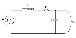

    Here's an equivalent electrical representation of a pickup:

    Vs is the AC source voltage generated by the pickup. Vo is the final output voltage. The inductance L and the coil impedance R, are in series with the voltage generator, whilst the capacitance is in parallel with the other components.
    This arrangement forms a 2nd order low-pass filter with a resonant peak at the 'turnover' frequency point. At frequencies above this point, the frequency response drops off quite quickly at a rate of -12dB per octave.

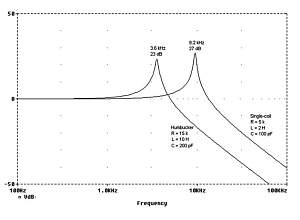

    Series-connected humbuckers generally have higher resistance, inductance and capacitance than a normal single coil pickup, which results in a lower resonant frequency than on a single coil pickup. E.g. for a low-output single coil pickup with a 5k ohm resistance, an inductance of 2 Henries and a capacitance of 100pF, the resonant peak is at 9.2kHz, with an amplitude boost of +27dB at the peak. For a high output humbucker with a 15k ohm resistance, an inductance of 10 Henries and a capacitance of 200pF, the resonant peak is at 3.6kHz, with an amplitude boost of +23dB at the peak.
    Here are those values for a single coil and a humbucker plotted on a graph. This makes it easy to see the lower resonant peak frequency value of the humbucker compared to the single coil.

    Lower coil resistance and inductance values of less powerful humbuckers (such as PAF style ones) increase the resonance peak frequency - which explains why these lower powered humbuckers can sound very clear in comparison to the hotter wound ones.
    Note that adding volume and tone controls also affect the resonance peak, but at least this shows the other main reason that humbuckers sound darker and more middley than single coils - because the upper-mids and lower trebles are boosted (compared to the flat response of a single coil at these frequencies), whilst the mid- and upper-treble frequencies are filtered off. A single coil has a higher resonance peak - so has a flat response in the middle frequencies - whilst it is the treble frequencies that are boosted and that the low pass filtering doesn't start to cut frequencies out below the upper threshold of (good) human hearing at 20kHz.
    Of course, the guitar's sound is then generally passed through a guitar amp with a speaker that doesn't put out much above 5-6kHz, so that's another low-pass filter the guitar's sound passes through. So you'd rarely get to hear the resonant peak of a single coil pickup, but you do get to hear some of the mid-biased peak of a humbucker.
    Getting back to series/parallel humbucker operation, when the two coils are wired in parallel, then each coil behaves as if it's a single coil, so the inductance, resistance and capacitance values of the series-wired humbucker are to all practical purposes halved, and the resonant peak of each coil of the humbucker is moved upwards, giving a much less middley, far more trebley sound. Which is why a humbucker in parallel mode sounds pretty close to a single coil - it's only the phase cancellations and reinforcements at different frequencies caused by the two coils sensing different locations along the string that create a difference in sound to a true single coil. But the benefit is that as one coil is reverse polarity and reverse wound to the other one, that any airborne mains noise is picked up as an out-of-phase signal on one coil compared to the other one, cancel out when the two coil signals are combined and so it remains humbucking and (almost) noise free.
