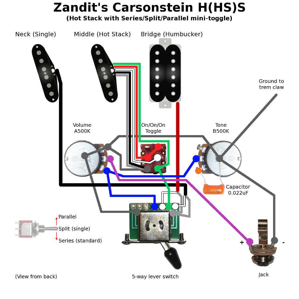

    I think this should work, hopefully it's clear enough for you.
    The dark grey wires are the ground connections and the light grey are the bare wires on the pickups.
    As you are mixing three different pickups from three different manufacturers there's a real chance that there could be some phase issues. Basically, they'll either all be in phase or one will be out compared to the others. You'll hear it if one is out of phase, when combined with another pup the sound will be thin and nasally, very distinctive. If it happens, chances are it'll be the Hot Stack and if that's the case its wiring will need to be reversed while maintaining the coil order for the hum cancelling when split. So, just for the Hot Stack, green would go to the red connections, red to the green connections, black to white connection and white to black connection (I think), bare stays the same. But, wire it as per the diagram at first and hopefully we'll get lucky and you won't need to change anything. If it's one the other pups that's out of phase you'll just need to swap their hot and ground (you don't have chrome/metal covers so you can do that in this case).
    Let me know if you have any questions/problems.
    Last edited by WeirdBits; 22-10-2016 at 08:27 PM. Reason: Coil ordering and potential brain meltdown
