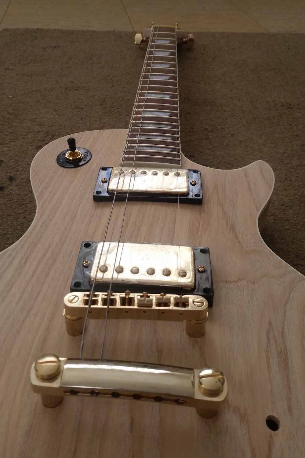

    Even thought the bridge is sitting about a mile in the sky, I've ran 5, 6 and 1 to see the alignment of the neck, bridge, saddles etc. etc. Alignment wise, I think it's not too bad - thoughts?
    Note: The neck isn't clamped, and the bridge doesn't have it's pegs mounted as of yet - Not sure how I'd check the neck angle without really mounting the bridge, so it's firm enough to at least hang on to a string that's tensioned "Straight". The more I look at it though, the less and less Im worrying - nothing particularly untoward seems to be going on there outside of a little bit of creative filler and colouring.
    Ideas, suggestions welcome - Im getting heaps of good info from you all so far!

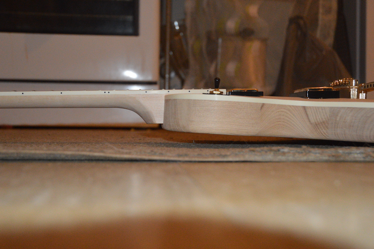

    Check to make sure that the two E strings are the same distance away from the edge of the fretboard, once they are the same you'll know that the neck is correctly aligned with respect to the body, Gibson give the following specs for the 12th fret action on their factory-built LP guitars (note that the specs are in imperial units):
    Low E string 12th-fret action: 5/64ths of an inch.
    High E string 12th-fret action: 3/64ths of an inch.
    I'm not sure what the metric equivalents are, but if you're able to get the 12th-fret action to those specs without the bridge touching the body then the neck angle should be fine.

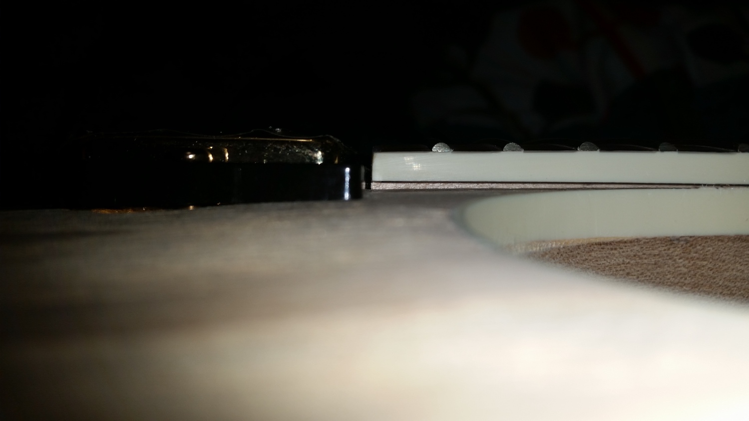

    Yeah - and to be honest, Im not overly panicking as of yet, cause I haven't glued anything thus far. But I am just really not happy with the angle of the neck break with this whatsoever. It seems like it's out (with a straightedge) at the saddles (raised up half) by about 15mm (IE: the bridge would need to be raised another 15mm). That's massive. Im positive I can get this fixed, but I cant tell anything whatsoever about the neck until I maybe get it to string tension. The feedback thus far has been outstanding on the forum, but every single suggestion seems to tell me the neck is out by a country mile.
    Im terrified to do any sanding or anything as of yet, cause if you make a mistake you're done... But Im certain if I keep looking I might get my answers. Onwards and upwards.

    Looking at your photo from the side up above, it definitely doesn't look like it's sitting in right.
    I haven't seen an LP kit, but on my SG the neck pocket routing in the body is flat, and the neck in that photo doesn't look like it's sitting flat in the neck pocket. Mine would do the same before I clamped it.
    I'd check it again without the pickups in there (you won't be able to tell if it has slipped if they are covering the hole) and clamp it on and see how it goes.

    Youre right. It doesnt look like it. But it certainly is. Even when i mock clamped it its that angle. On the pickup side of the neck heel its wood on wood. All the way to the base. The angle is massivly pronounced on this neck.
    Im at work atm but will get better pics shortly.
    *edit* i THINK its masively pronounced. Ill leave that up to the experts.

    Im not at home at the present, but the photos that I have put up before show a little bit of the angle - I'll get better images when Im at home.
    These are what I have at the moment.
    (And no, mine's not at all like yours - As you can see on the gap of mine, that's how far out is is on the angle - It just feels like I'd need to raise the bridge like a crapload off the guitar just to have a baseline action)
    But I'll get better images asap.
