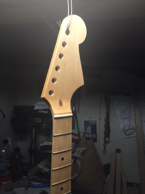

    A good build day so far! With the neck sanded to 1200 I decided on a whim that I wanted to stain the maple a little. I had some FeastWatson Old Baltic prooftint and tried it on a maple scrap - I didn't want much colour at all, just a little warmth, and the Old Baltic stain worked well as long as I applied it very lightly with a rag. I did the neck, liked the result and figured the fretboard could use a little warmth too. I used the same technique and it seems to have worked okay. After letting it sit for an hour I gave it a couple of coats of Tru Oil which is where it's at now. Hopefully tomorrow my decal paper will arrive and I'll be able to get that bit done and then a few more Tru Oil coats to finish it off.

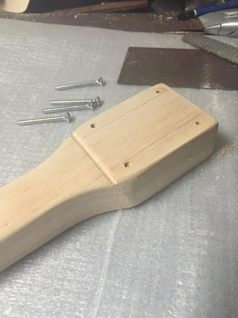

    Next step was to make a body holder for painting...so I did! I had a piece of 70mm wide pine so just cut it back to 50mm for the pocket, and maybe 25mm of so for the handle part. Drilled a big hole in the top as I've got no idea where I'll be hanging it during the painting/curing phase but figuired a big hole wouldn't hurt. One thing I saw on a video was the addition of the little groove to avoid paint cracking away where the holder sits in the pocket. A clever idea so duly incorporated.

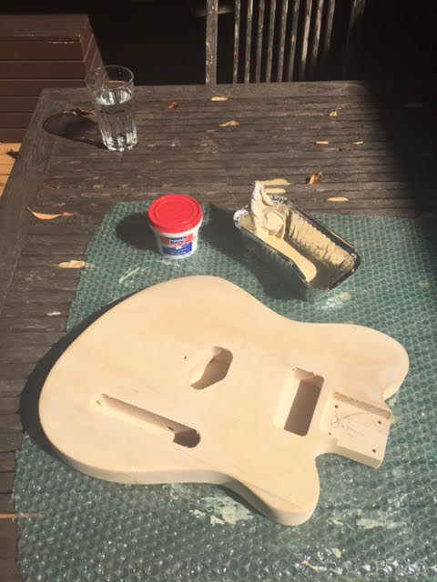

    Okay, time to Timbermate the body - another new experience, and surprisingly straightforward (I wiped/rubbed it all over the body rather than rollers or "scrapers" as I've seen mentioned), then sand back with 400, wipe with a damp cloth, wait to dry, then final crack with 400.

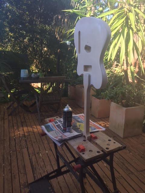

    Then attached my neck holder thinga and started priming (using Rust Proof All Purpose White Primer). I did use painters tape to mask the neck pocket, but left the other cavities open to at least get some paint in them - still not sure if I'll fill them with the colour coat, although not sure why I'm even thinking about not doing so.
Name:	Primed 210816.jpg
    One light coat and now I sit and wait for an hour or so before doing another. With any luck that will have me able to lightly level it off with 600 in the morning, and then perhaps a first colour coat after work tomorrow!

    That reshaped body is great.
    Hope you have a drop sheet otherwise the deck might get a bit of light overspray.
    Love the aged tint look on the neck.
