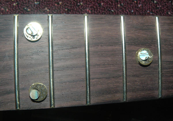

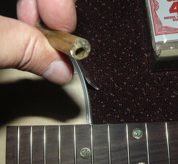

    Tail piece is a gold Kluson one as are the tuners which have the matching grooves. I have gold strap buttons and jack socket and a brass nut to finish it all off. wtf are those things on th efret board? well, I'm going to try to make some cool dots. The brass tube is used in knife making and comes in different patterns and diameters, I've sliced into into strips and will fit abalone dots into the large hole (used for a lanyard cord on knives). I'm going to finish smoothing them etc before even thinking about drilling the old dots out.

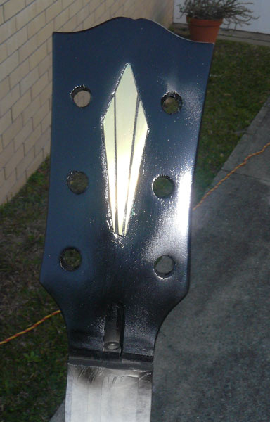

    Did the timbermate slurry yesterday, first coat of ink for the burst on today.a couple of small bits of glue/filler showed up, I was able to use a fine sharpy to do a series of dots, then smudge them which pretty much hides them as part of the grain.
    The clamps are holding a sliver of ply I've glued in to catch the mini humbucker mount as they just missed the edge of the hole by 1mm either side. Holes for the tail piece are drilled. Not sure about the head stock logo, might do the same as on the Jnr.
    Not sure about the brass dots either, might just put in some abalone ones

    love the emerald green colour Dedman, I think abalone dot markers would suit best, although brass may work well too !
