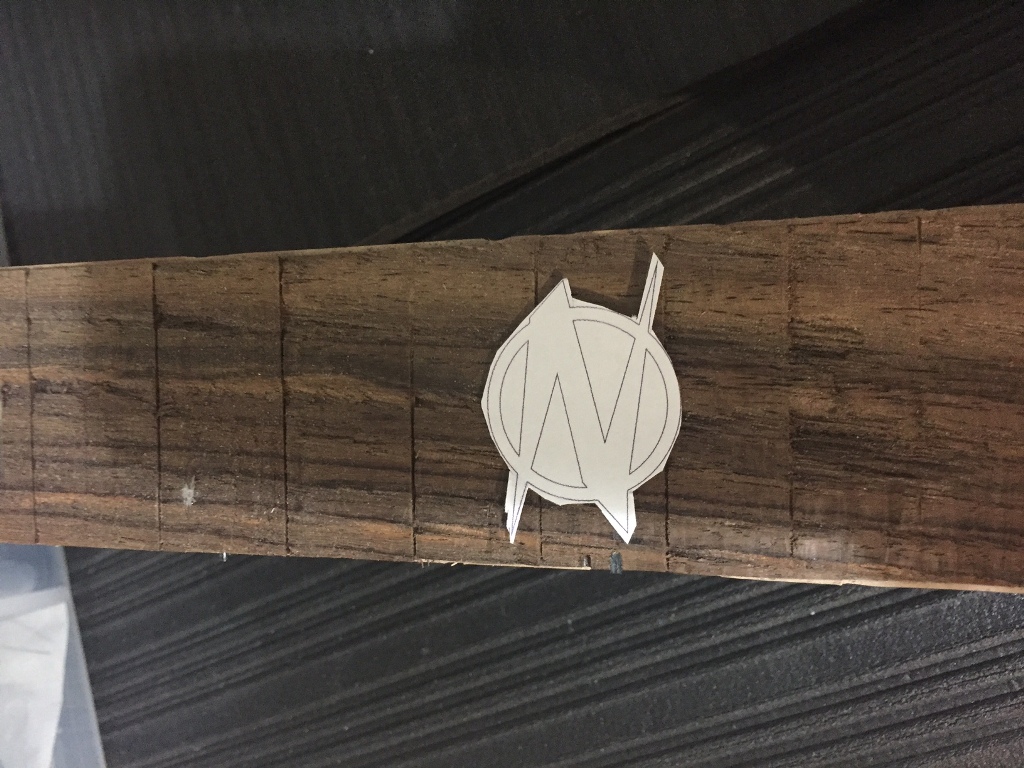

    Holy dooley, do you think it's salvageable? Lol. Tony, have you considered how you are going to get at the electronics with the 'F' holes blocked up? Material wise, immediately I would say 3mm thick acrylic which I have approximately that colour, but for thinner, 0.8mm polypropylene in a slightly lighter orange. The PP is flexible, but at that kinda size I don't think it will matter too much. For the fretboard inlay, acrylic is the way to go though, just sand to the radius with the fretboard.

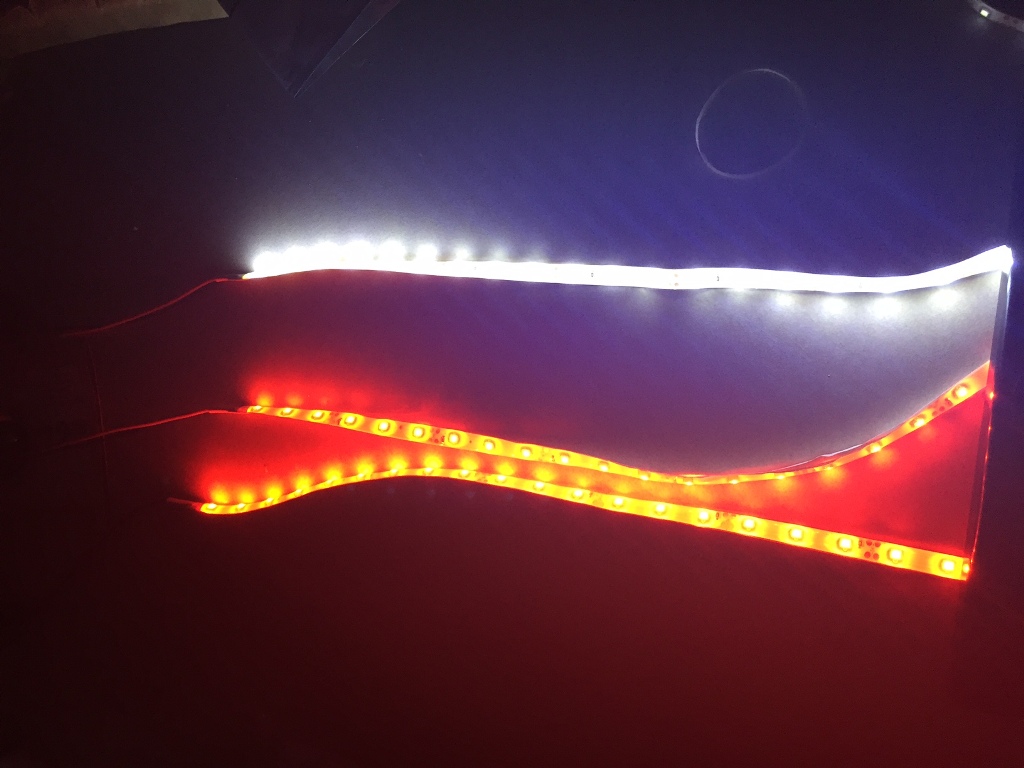

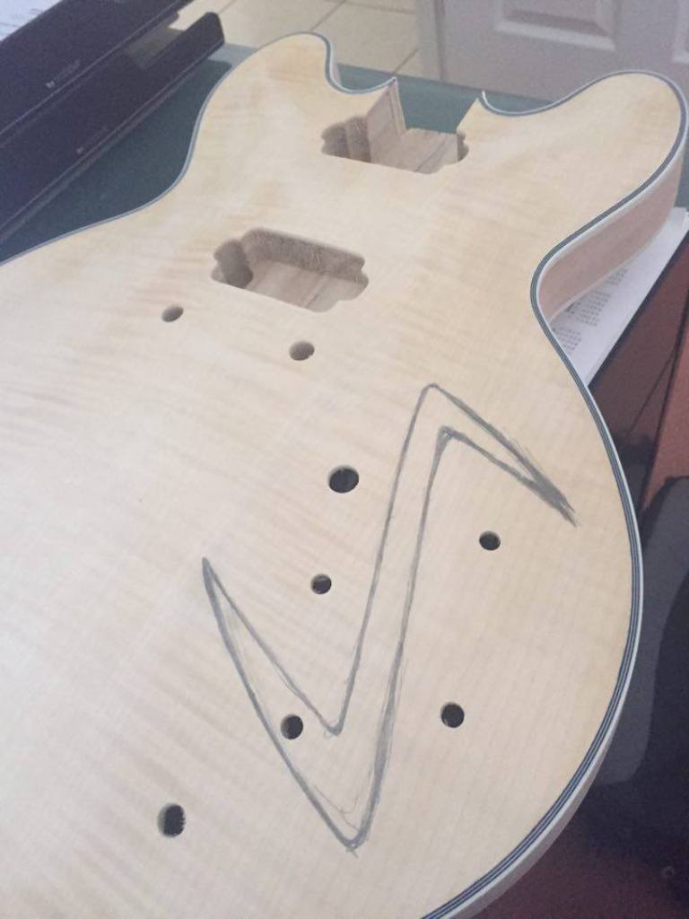

    So starting to get all the materials sourced for the build. Got some 10V Led sets for the body lighting and got both white and red to see which gives the best effect under the acrylic.
    Marked up a roughy outline on the body for the shape of the acrylic inserts and templated and sent of to Pablo.

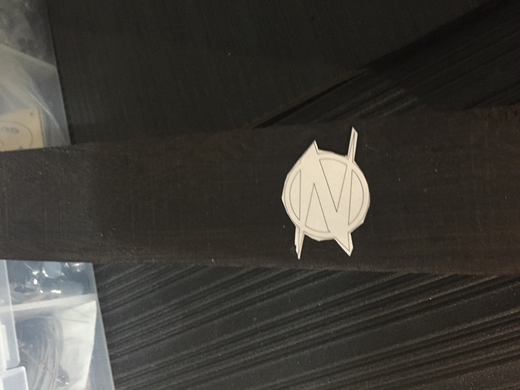

    Pablo did up a mock of the fretboard inlay and then some templates to size against my current neck and new ebony fretboard to ensure the correct sizing.
    Now to source some smaller diameter optic fibre for lighting the side dots.
    Now working out the lighting of the inlay and will either use LED or optic strand ( more likely LED)

    This Axe is just going to be uberfunky, I may however cry when you post photos of cutting into the top for the zed's.
