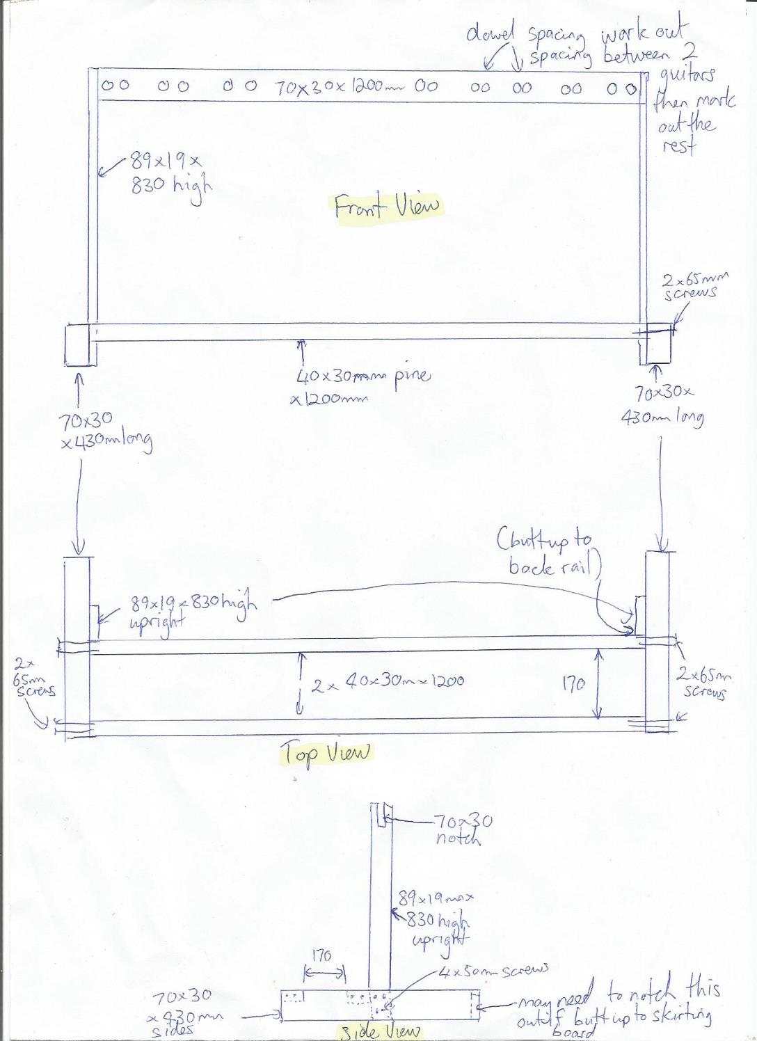

    cheers Ponch, I have sketched the dimensions from top of my head, will confirm I remembered the lengths correctly tonight and scan it and post on this thread.
    I think at least 50% of the forum could use a guitar rack and it saves so much space and any axe is readily available to pull out of the rack, plus less chance of an axe leaning on a wall falling over and damaging it or even worse breaking a headstock off
  6. #26
    here is the sketch of the dimensions. Please ask if you have any questions. The pine rails are actually 42 x 30mm
Name:	dimensioned plan0004.jpg
