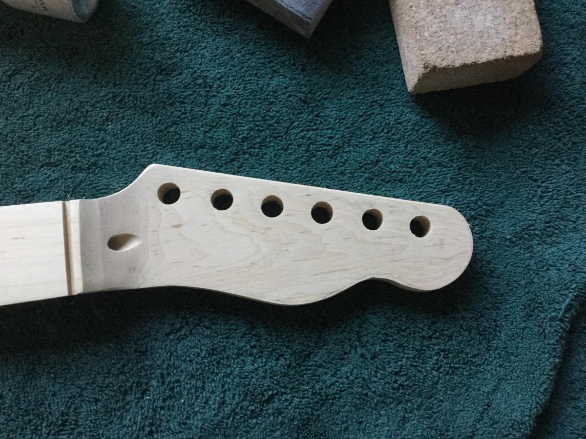

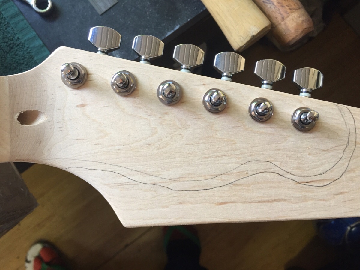

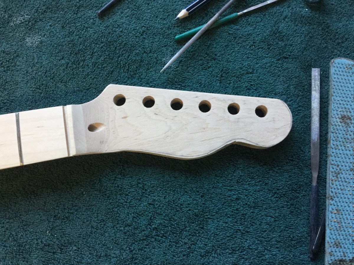

    Made some more progress this weekend.
    Got the machine heads positioned and locator holes drilled. I also shaped and cut out the headstock, still quite a bit of work to do but it's starting to look like a Tele !
    I mocked up the body, I think I'm going to have to enlarge the bridge route as the bridge will have to come forward to get the correct scale length. Sanded back and filled a couple of small dings that I missed first time round and hit it with 3 more coats of primer.
    Who puts a finish on these maple necks ? Are they ok without any finish ? I've got some lemon oil I use on rose wood boards will that go ok over maple?
    I used tru oil on my maple neck
    Verstuurd vanaf mijn D6603 met Tapatalk
    Builds:
    WIP: LP-1S "Poison Ivy"
  11. #30
    I use Dingowax on the fretboards and dingotone neck finish (without stain) on my tele neck. I prefer the feel of the DT neck finish on the neck than the Tru oil, but I know some guys prefer a Tru oil as a neck finish rather than others. Its kinda personal preference.
    I have other guitars with no finish whasoever on the maple fretboard and back of the neck only finished on the front of the headstock. the back just polished by sanding. It does feel quite nice to have a naked neck as well.
    Sorry to confuse you more, but plenty of options for you
