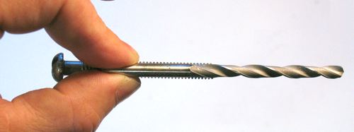

    The screws for the tuners are tiny. Anyone know what drill bit size to get? Tried self-tapping but that ain't gonna fly

    Screws
    Are you just drilling the screw holes for the tuner screws? or did you snap one off?
    I think I use a 1/16 drill bit size for mine, but I just check by holing the screw behind the drill bit to see if the thread sticks out.

    Thanks Andy. I had already checked distance to first fret along the length of the nut and it is consistent. Therefore, I assume it will play ok.
    I haven't broken a screw yet and hope not to break one. I will get 1/16 drill bit.

    Don't completely quote me on the 1/16 as I only had imperial and i think the screw measurement is metric. probably just take the screw down with you to the hardware and measure it against the drill bits till you get one thats the right size. If you're like me take your glasses.

    1.5mm drill bit for the tuner screws. The good news is a got the tuners on. The bad news is as I suspected; the holes are all over the shop.

    Good to see you have the drill bit sorted.
    I always smear a tiny bit of wax on the end of the thread to help drive without snappage...
