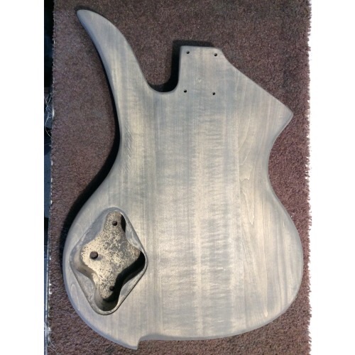

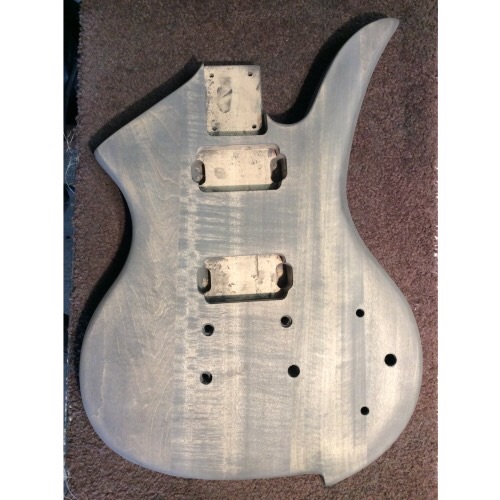

ID:	10900Click image for larger version.
    After a quick sand.

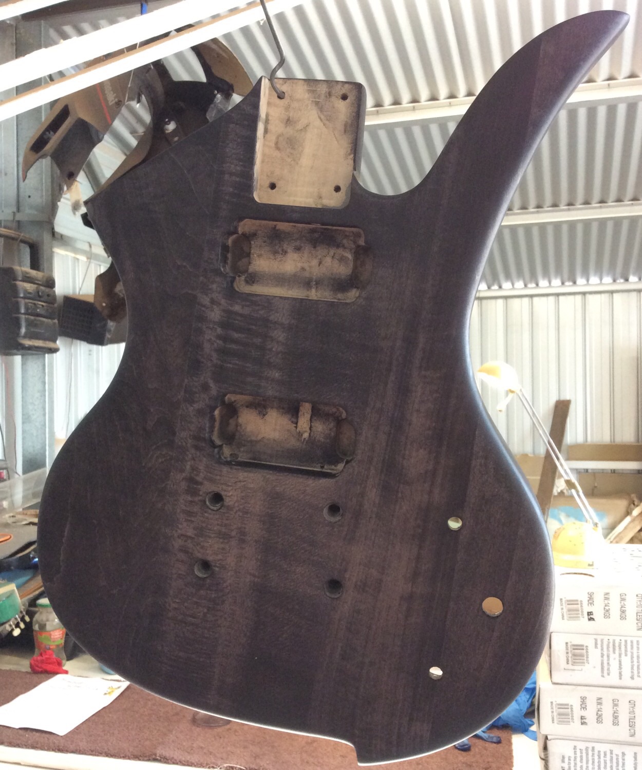

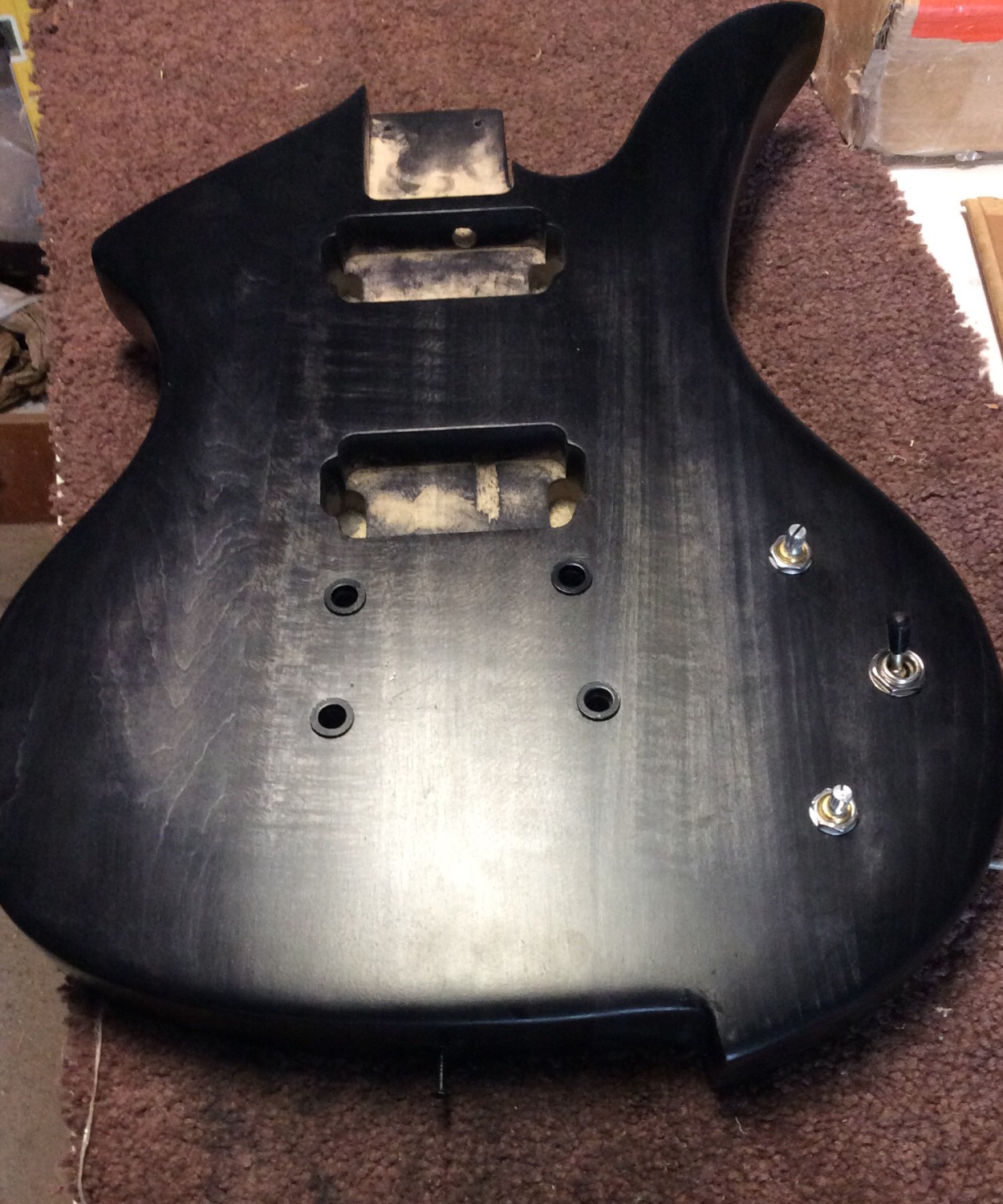

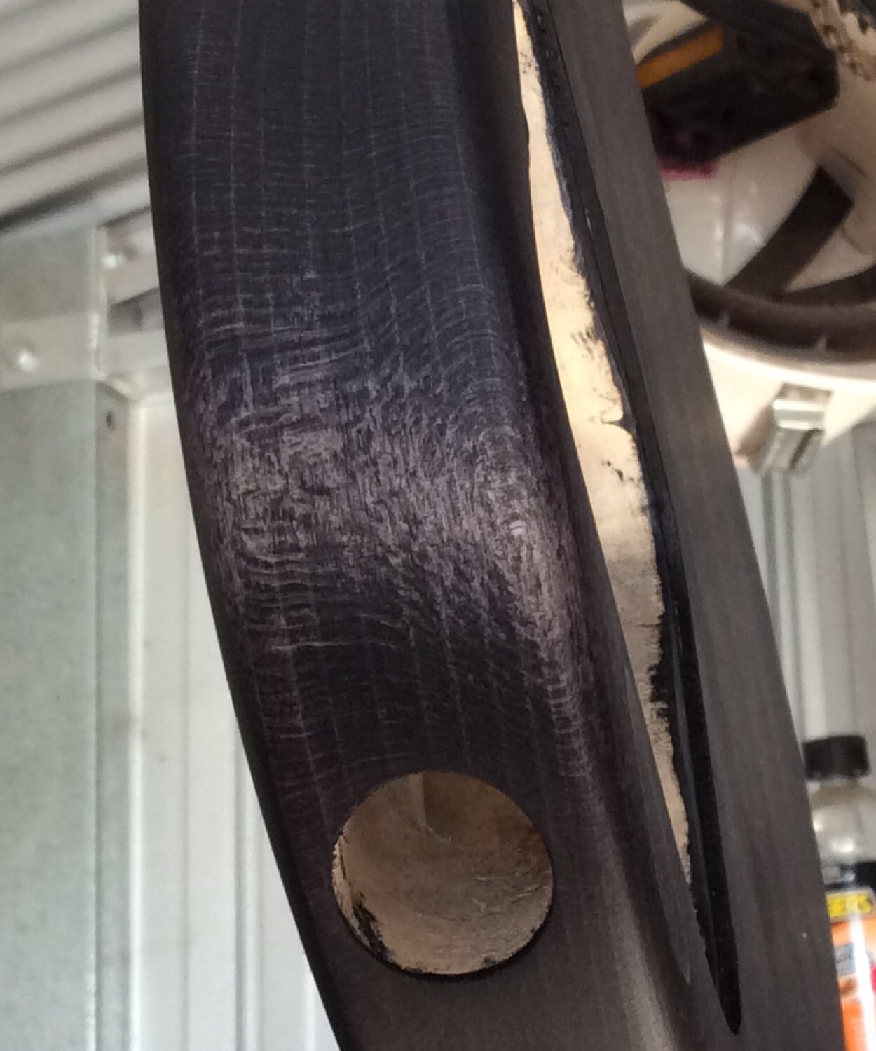

    Applied the stain coat of the dingotone black stump. There are some spots that the stain didn't take to as well. Would this be over doing it with the sanding? Do I need to go over this again or will the intensifier fix it?
ID:	11085Click image for larger version.
ID:	11086Click image for larger version.

  8. #28
    Hi Andrew,
    How many stain coats is that? I do about 3 or 4 stain coats leaving about 3 - 4 days to cure between each, before the intensifying coat. I then do the same number of intensifying coats leaving 7 days between each coat. Thats about as deep as you can get it.

    Member AndrewA's Avatar
    Broken Hill, NSW
    115
    Hi Andy, thats just the first coat. In the last photo, the patch that looks like a flash reflection is bare wood showing through where the stain didn't take. Hopefully a few more coats will fix it.

  10. #30
    You can always scuff it up a bit with a bit of light sanding say 240 or 320 to get it to take a bit better. I would only do this once though.
    I usually apply the stain coats in a circular motion and work it into the wood, then wipe off in the direction of the grain.
    the colour will deepen as it cures......patience......I have no doubt it will go darker.
