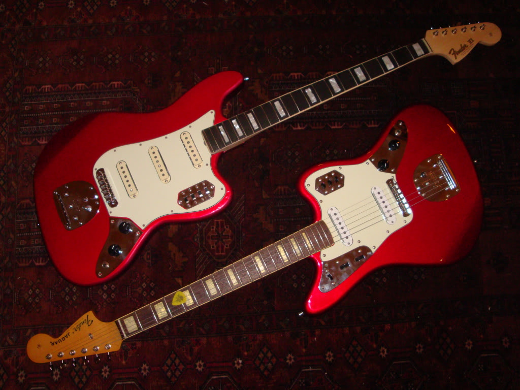

    Here's a link to a mob that sell a template for the VI body
    http://www.ponoko.com/design-your-ow...bass-roku-5552
    I think I have seen drawings with all the dimensions somewhere as well, will keep looking
    Here's a pic of a Jag and VI side by side, there are some pretty obvious differences in the body
