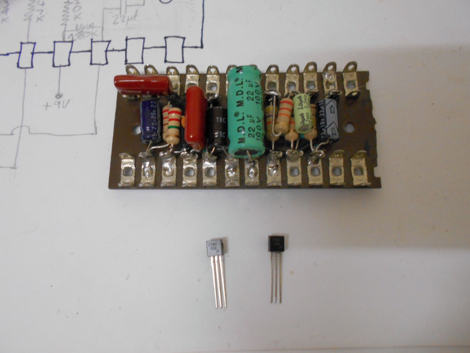

    Update:

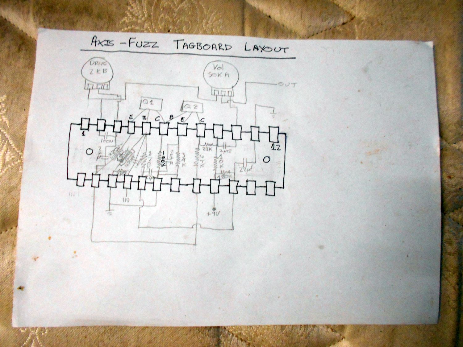

    Okay here's a step by step account of what I have done so far in the build process:

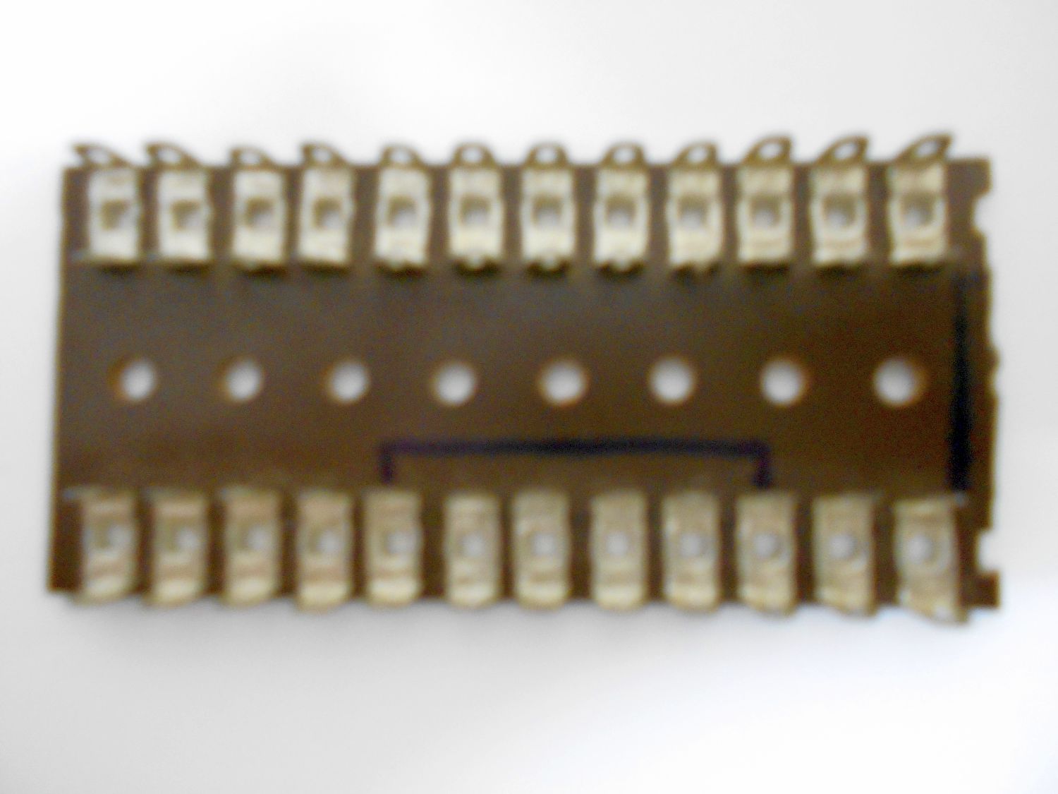

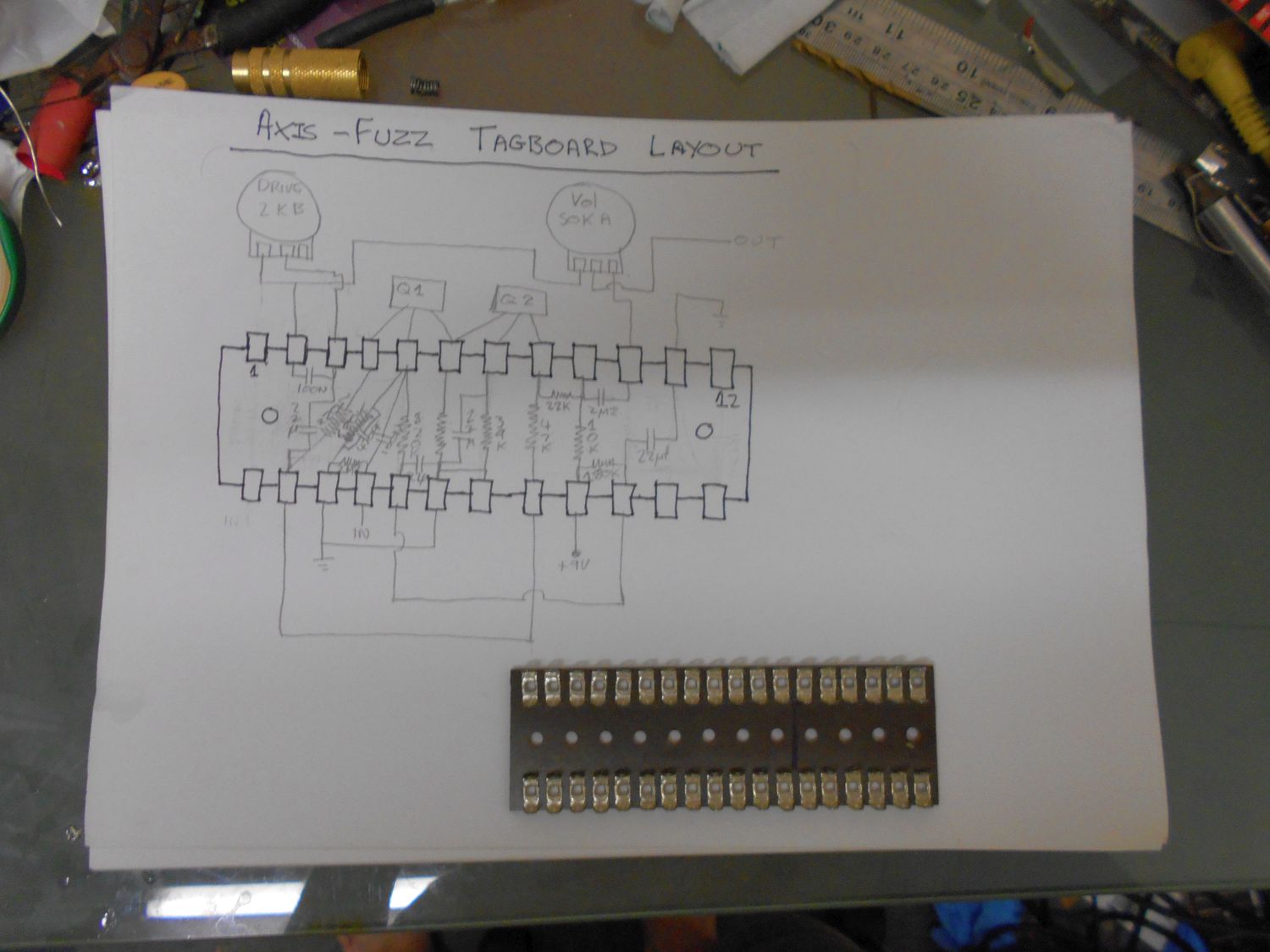

    Since I decided to use a piece of Tagboard to mount the parts on, I did a quick search in Google and found a suitable Tagboard layout which I drew onto a piece of A4 printer paper:
Name:	Axis 1_resized.jpg

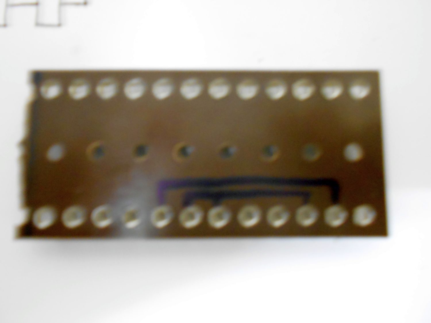

    Once I was happy with the layout, I trimmed the Tagboard to size so that there were 12 solder-tags on each side of the board:
Name:	Axis 2_resized.jpg
Name:	Axis 3_resized.jpg

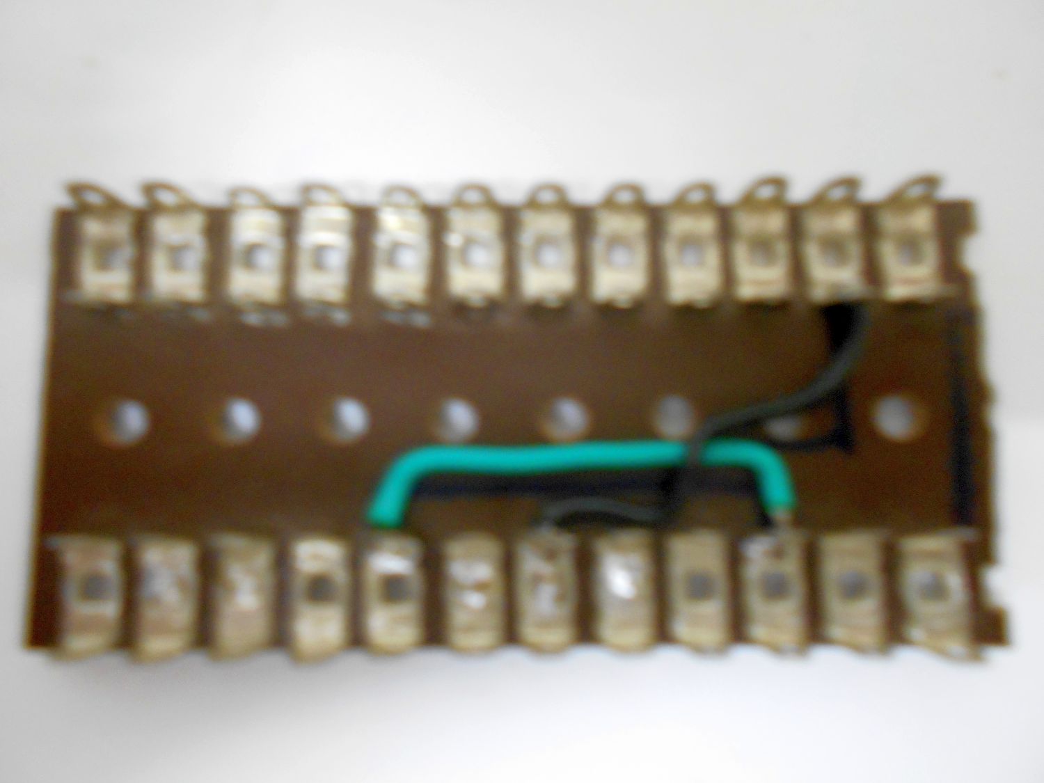

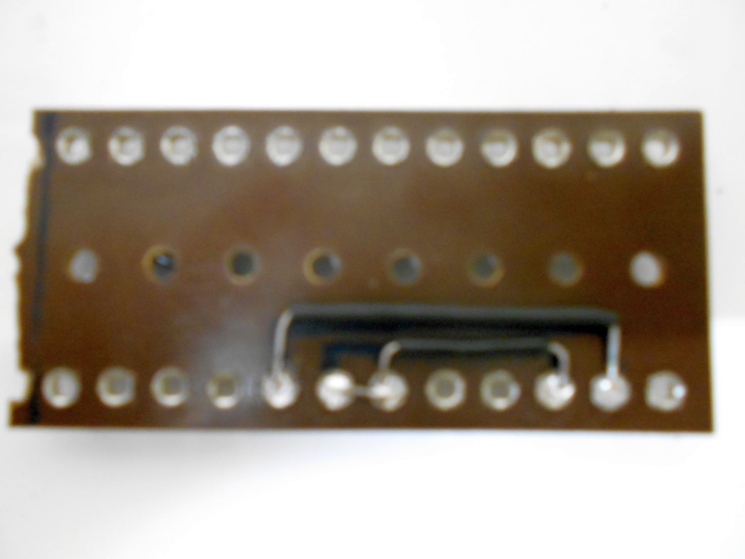

    The next thing to do was to use a Blue marker pen to mark out where the wire-links, linking the solder-tags together, needed to go:
Name:	Axis 4_resized.jpg
Name:	Axis 5_resized.jpg

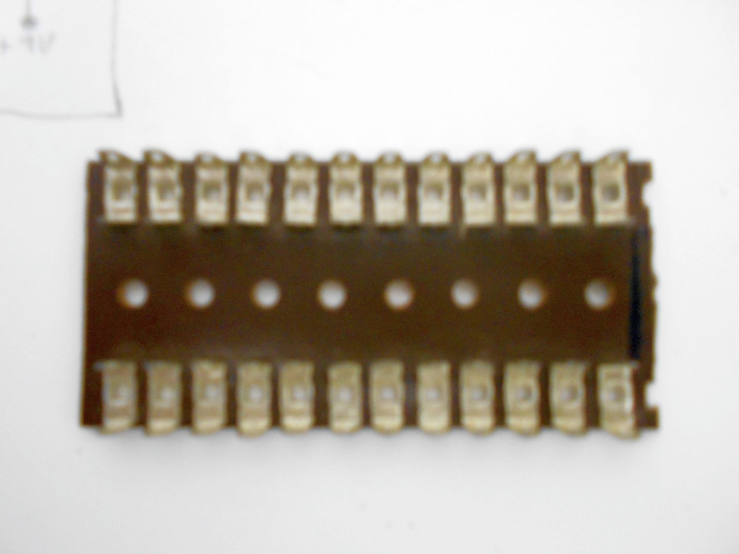

    The next step was to solder the wire-links to the Tagboard, some were soldered to the underside of the board, some were soldered on the top:
Name:	Axis 6_resized.jpg
Name:	Axis 7_resized.jpg

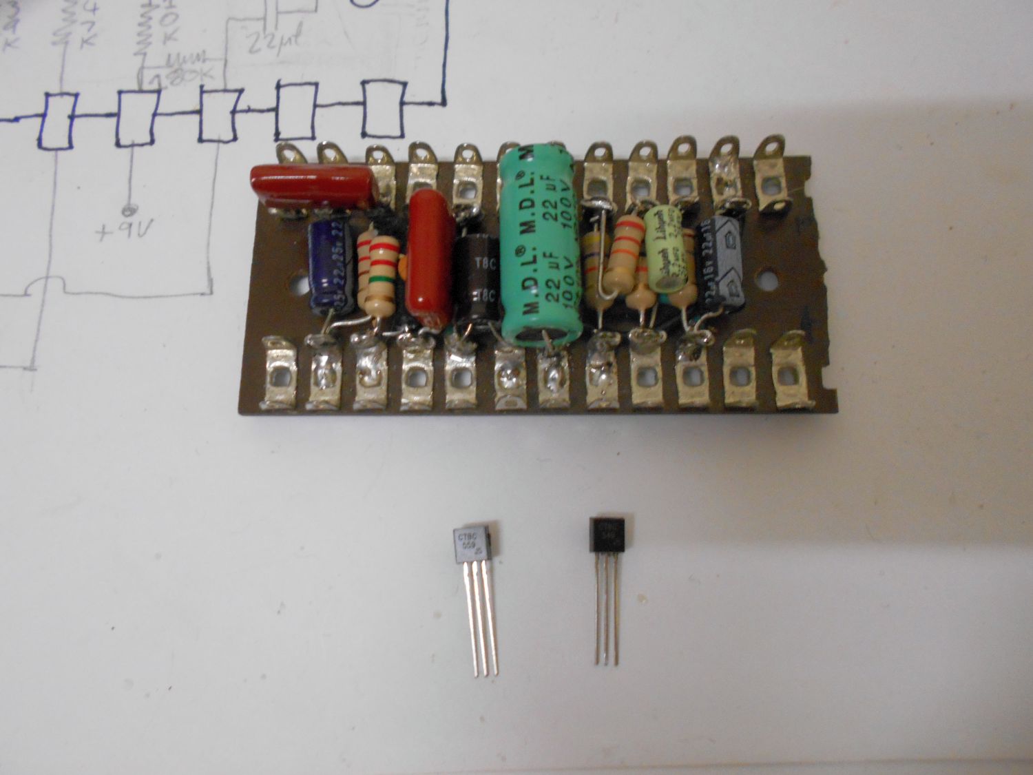

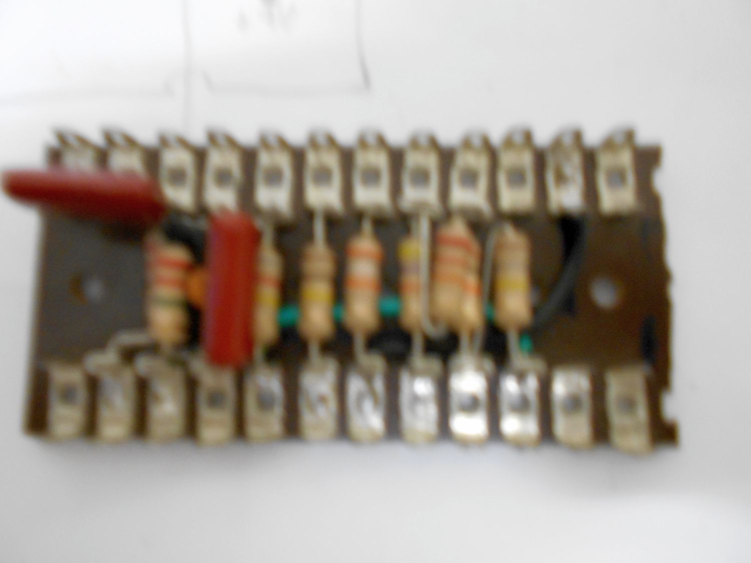

    After doing that, the Tagboard was ready for soldering the components to it:
Name:	Axis 8_resized.jpg
    And this is what the Tagboard looks like now, all that needs to be done is to solder the two transistors in place, the transistors are the two black components with three silver leads below the Tagboard in the pic:
Name:	Axis 9_resized.jpg
    So once the transistors are correctly soldered onto the Tagboard, the next step in the build process is going to be the marking-out of the Aluminium case I'm going to be using to house the pedal in, I need to work out where the centres for the mounting holes for the pots, footswitch, in/out jacks, and the indicator Led, are going to go, once the centres are all marked out I can then go ahead and drill the holes to size.

    OK Doc, for us noobs can you label what the components are in the diagram and maybe a copy of your shopping list?
    I'd be keen to have a go but am component ignorant atm

    OK Doc, for us noobs can you label what the components are in the diagram and maybe a copy of your shopping list? I'd be keen to have a go but am component ignorant atm
    Can do, I'll make a clearer drawing of the Tagboard layout so it's easier to follow, and I'll also post a list of the parts I used with their Jaycar Electronics catalogue numbers so you can find them, you may need to order the Tagboards from Evatco if you want to build the circuit on a Tagboard like I did, I'll get that all sorted out in the morning.
