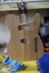

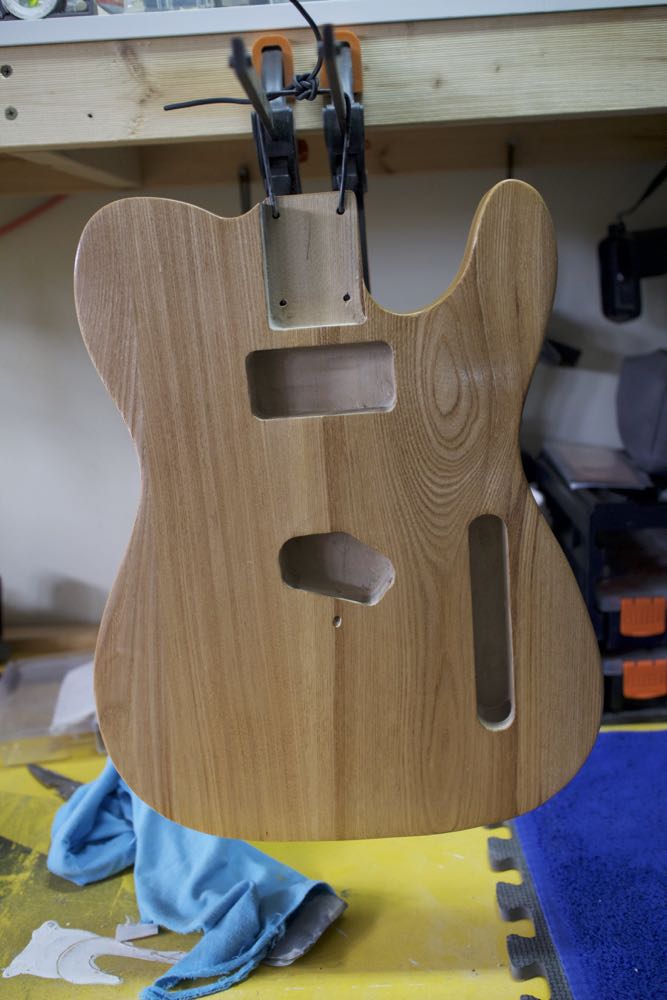

    Today i sanded back the grain filler sanded through to Pminiscule grade and decided upon my choice of stain......wait for it.........none....
    after all the talk about paint layers deadening tone i thought what the hell.......just try oil it......and seeing that it appears to be going onto the neck pretty well i feel confident enough to use it.....so so far 2 coats of tru oil on the body and 5 coats on the neck....loving the shine and now looking to mount the groovy grovers......

    looking great BSB, keep at the clear coats. Love the natural look of ash.
    The Grover tuners look the business. When your Wilkinson bridge arrives do a mock build to see if you need to route the bridge pup cavity forward to achieve intonation

    Drill holes on the Head Stock.....mmm......even after a few bourbons they don't get any straighter......see photo with the groovy groovers mounted......would it not be more prevalent for the necks to come from the factory undrilled......would get the creative juices flowing more with headstock design i think......what say yea.....DB?

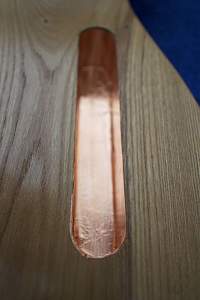

    Copper Tape installation.......soo therapeutic and easy....was a bit worried i was gonna stuff it up.

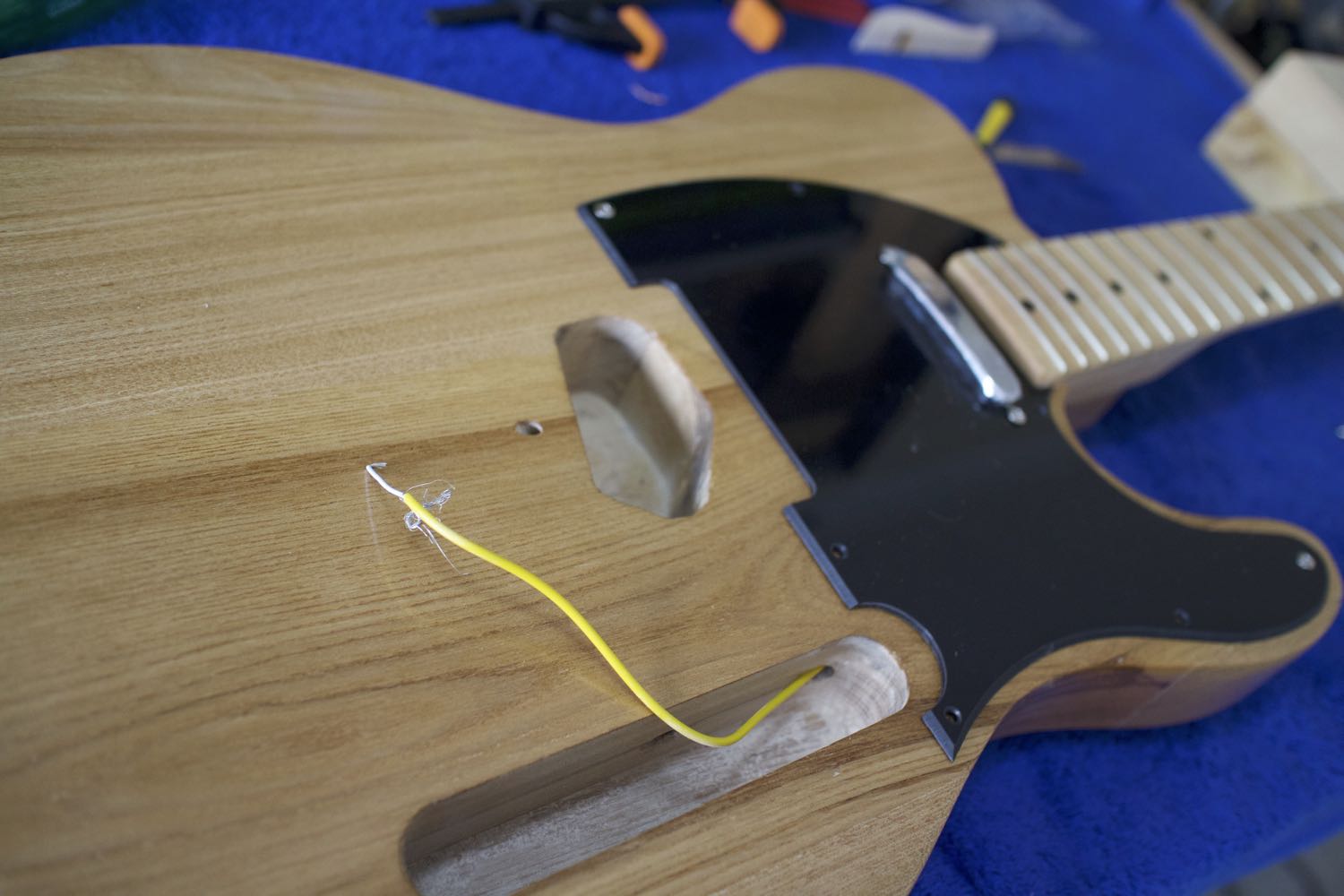

    Bridge Pick up routing.......WB, you say it has always been out by 5 mm......is this likely to change in the near future?
    mmmmm standard bridge is 95 mm and Wilkinson is 85.2 (diagram found on internet)....so it looks likely i will have to go get a router or is there another method, Anyone know ???

    I hear you re tuner holes, the reason they come pre drilled is to make life a bit easier for folk that may be apprehensive about drilling them...
    Having said that, the work around would be to plug them and re drill... If you were to do this I would recommend the Veritas brand of plug cutters.
    These guys cut a slightly tapered plug. This means you can get a really nice fit and if you can match the grain, almost invisible.
    Only thing you need to be careful of is not to drive the plug in too hard as they can split the headstock......
