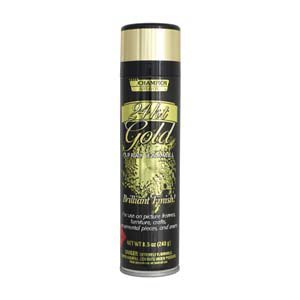

    I'm not going to leave the body and neck solely Blonde.
    Since I put the heel extension and the small piece of wood on the top bout, they tend to stick out and not make clean lines.
    I can solve that by spray painting the neck heel, back and front of headstock, and portions of the top part of the body's shoulders Black.
    I then intend to put Gold trim around that using very thin auto painters tape.
    I bought this 24k Gold spray paint last week for the job.
    What with the Brass and black epoxy scratch plate / truss rod cover, Gold hardware, it should come out alright.... I just hope it doesn't end up looking too much like it came from the Versace fashion house.... but then again, a bit of bling never hurt anybody.

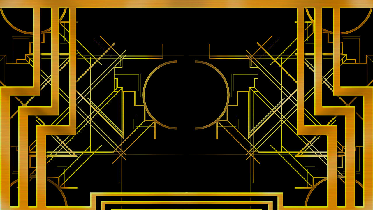

    Sort of similar design lines as this Art Deco look, should look good with the finger tailpiece.
    And use similar sort of design elements from the likes of below for decoration around the neck heel and headstock
